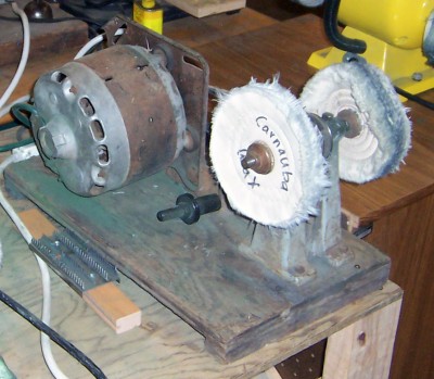

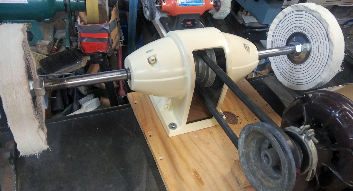

Here is an old buffer, my dad made this one years ago, he used a washing machine motor which is about 1735 RPMs.

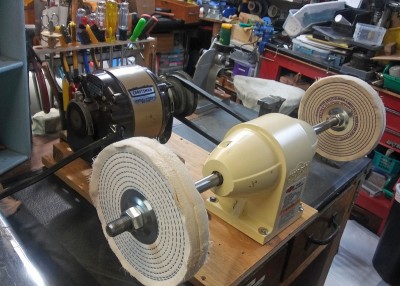

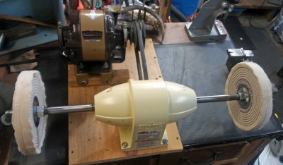

Here are some different views of my most recent buffer that I made.
The motor is about 1735 RPMs and the step down spindles allow me to adjust the speed even lower.

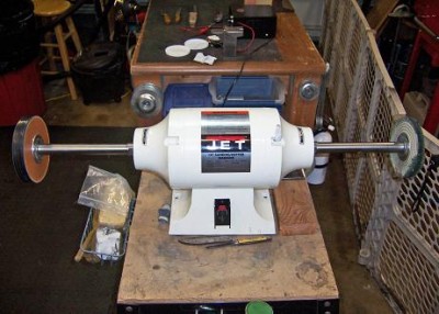

The buffer assembly came from Grizzly Tools, about $130 with shipping. The motor is a Craftsman that I picked up at an estate sale for $5 or $10. I also have a 1 HP Jet buffer that is 1735 RPMs. I don't think there made anymore but I think it was around $250 when it was new. I have had it for about 10 years now. I had a Harbor Freight buffer but it was 3500 RPM and was way too fast for my purposes.

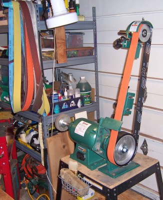

My Grizzly knife grinder has a buffer on one end which does come in quite handy. Check Grizzly for current price, I've had this for years and I think the price is about doubled on the machine from when I bought mine.
Normally I keep a ScotchBrite wheel on it to debur and knock the rust off of old metal objects.

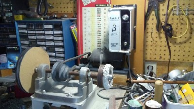

Here is my home made buffer for sharpening wood carving tools. Unit was off of a conveyor for $10. Now that's speed control!
