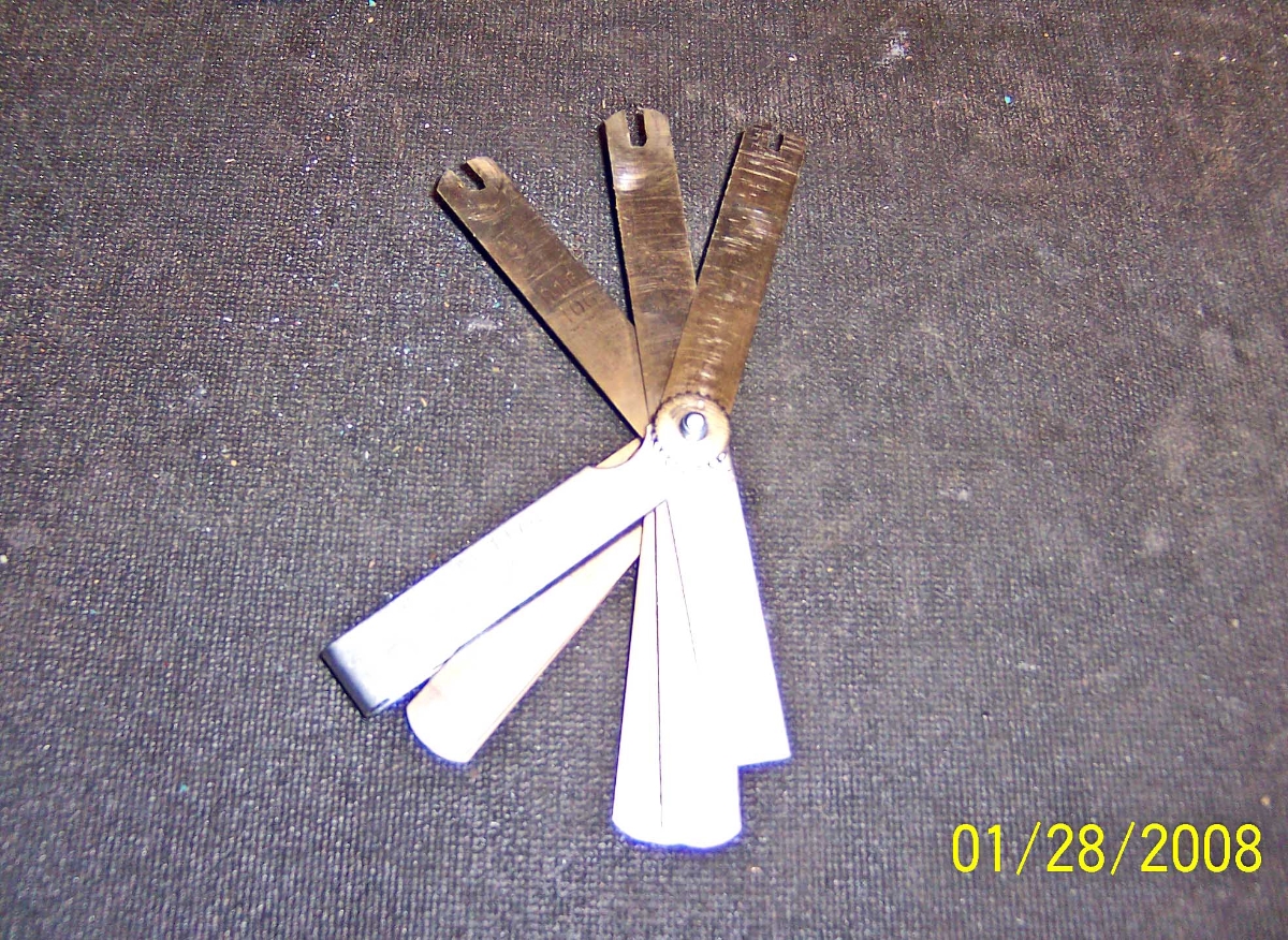

I make my slackners out of feeler gauges; use an abrasive wheel on a Dremel to cut the notch to fit over the pivot pin.

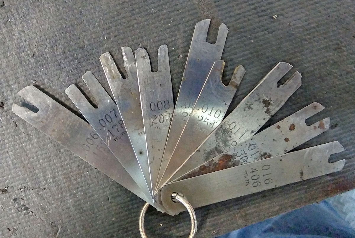

I made the above slackners in 2008, and have added to them until this is what they look like today (below).
Notice some of them have been broken off and reground, that happens.
I find flea markets and yard sales are a great place to find a set of feeler gauges. An old set of feeler gauges doesn’t have to be fancy, just in good enough shape that you can read the thickness and if they’re not rusty they should be good.
For $1, sometimes less you can get a whole set of slackners that will last you for years.
I find it works better for me to take them out of the case they come in and just clip them together with a split ring.
90% of the knives that I use a slacker on are .008". If it is a large knife, I will go up in size, the largest one my ring is .016", and I use smaller slackners on small knives. The smallest one I have on this ring is .006".
