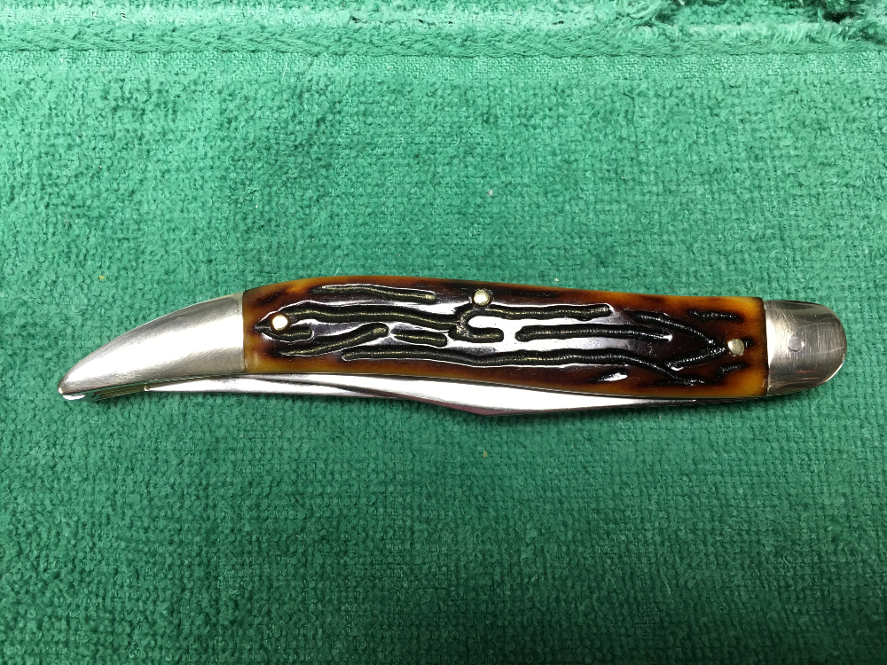

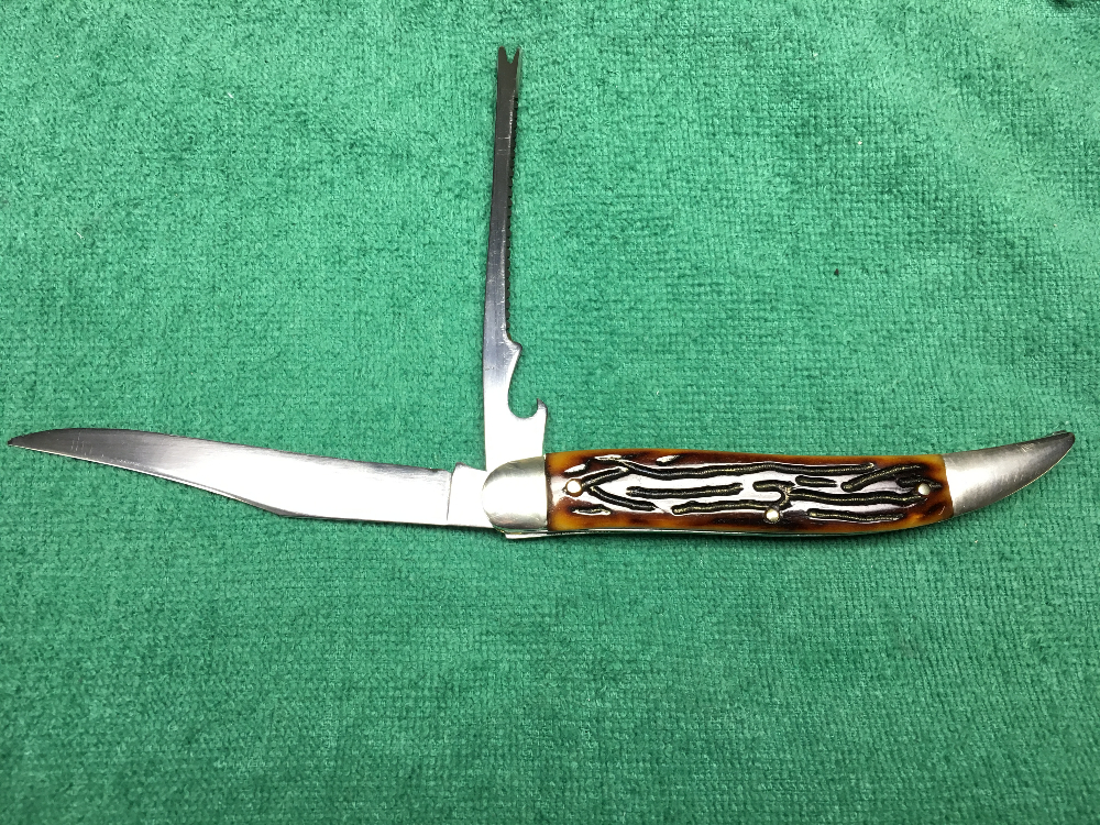

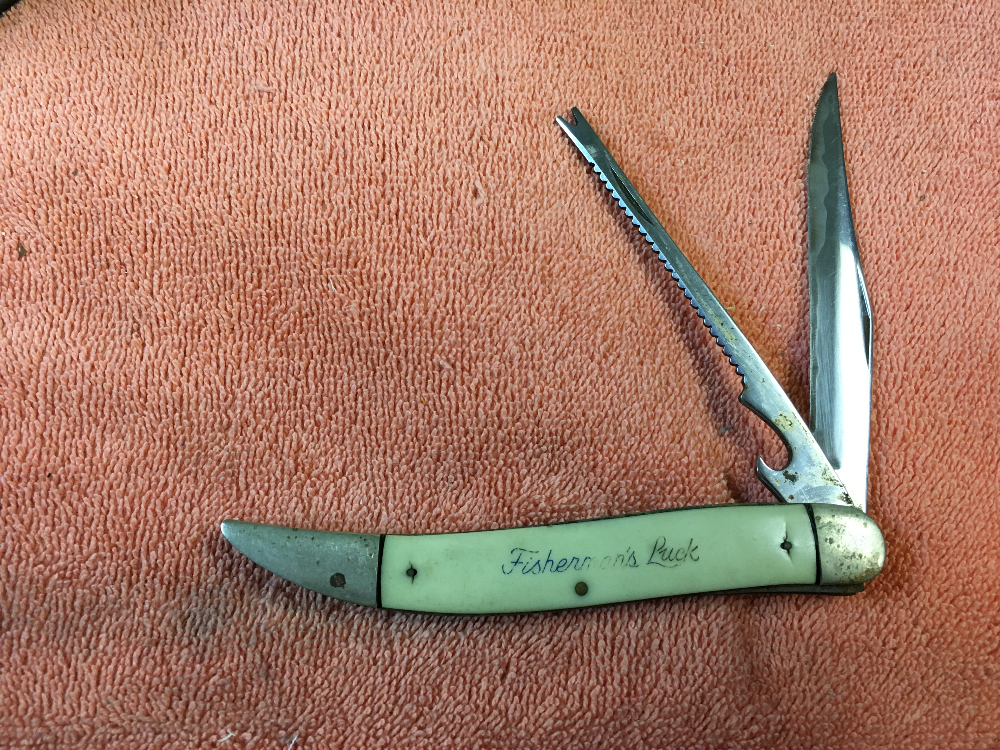

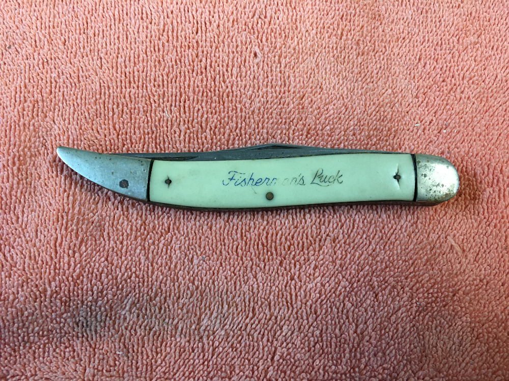

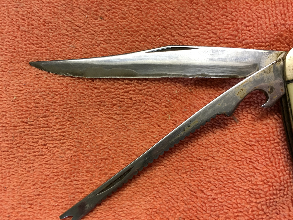

I've developed this thing for fishing knifes so I've been acquiring a few when the prices are right. This one was an old Fisherman's Luck model. The blade had some weird discoloration possibly from overheating the metal during one of its sharpening episodes with the previous owner. But It still had some life left so I decided to fix it up.

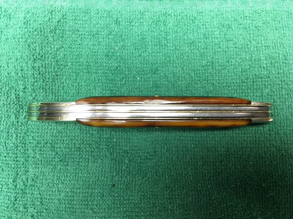

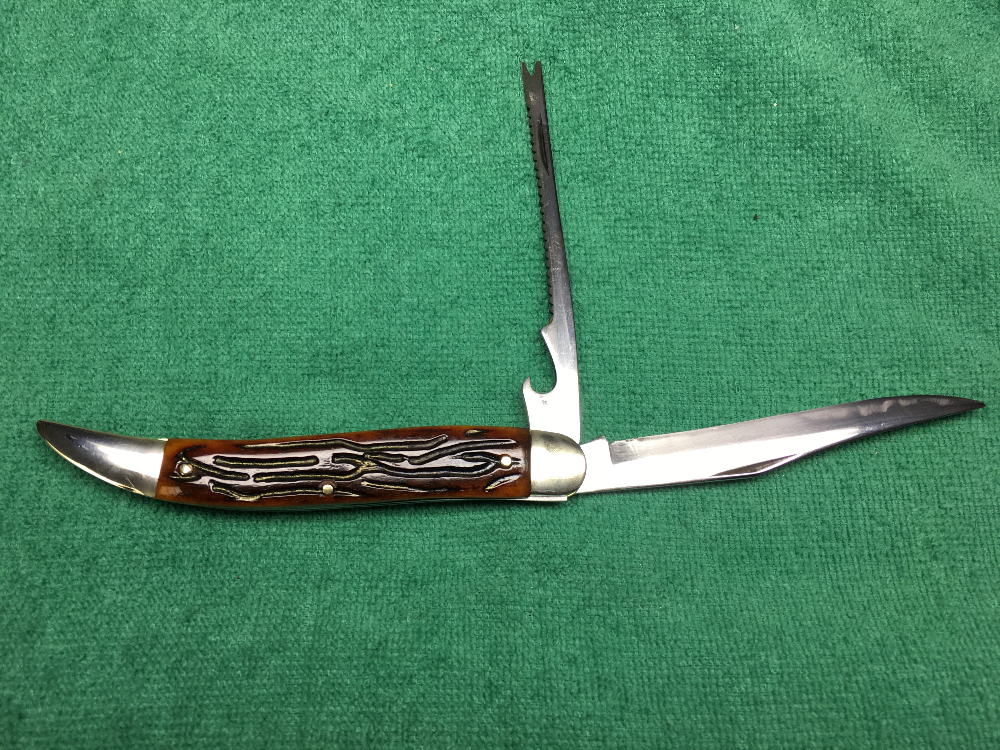

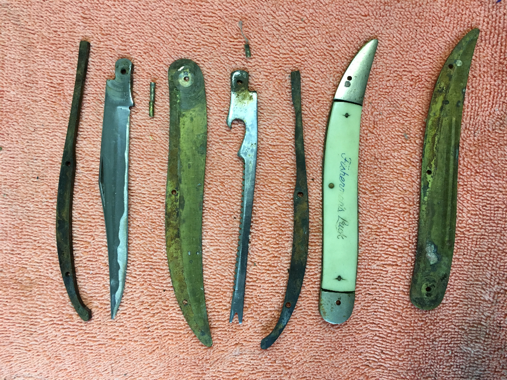

The original handles had numerous cracks and the knife itself had the usual grime and corrosion: Disassembly was pretty straight forward, seven pieces and a few pins: I did a quick cleanup of the brass pieces and the surfaces of the springs. Then I took a look in my bone handle selection for a couple of pieces that would fit this particular knife. I settled on some Amber Wormgroove pieces and cut them to size. Thanks to a tip from Dale I was able to sand the scales and fit them to the bolsters with a little less trouble than usual using a small drum sander (thanks Dale!). I finished the bone with progressively finer grits of sandpaper and then polished them with some pink scratchless compound.It shows up a little darker in the photos.
It turned out pretty good: I've been selling most of my knives on E-Bay to finance other knife projects but I may keep this one for myself.
Thanks for looking!
Thanks for looking!

Hey Jeff, you are really getting pretty good at this!
Very choice on the bone, the color looks very good and the jigging enhances the length of the knife!
It also appears that you got a good fit of the bone against the bolsters.
Outstanding work!
Outstanding work!

That turned out real nice Jeff. Looks like a completely different knife from the one you started with.
Good work!!

The before picture gave no encouragement to be adopted. But that after picture says 'you would be proud to own me'. Beautiful work.
