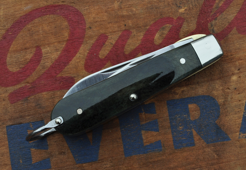

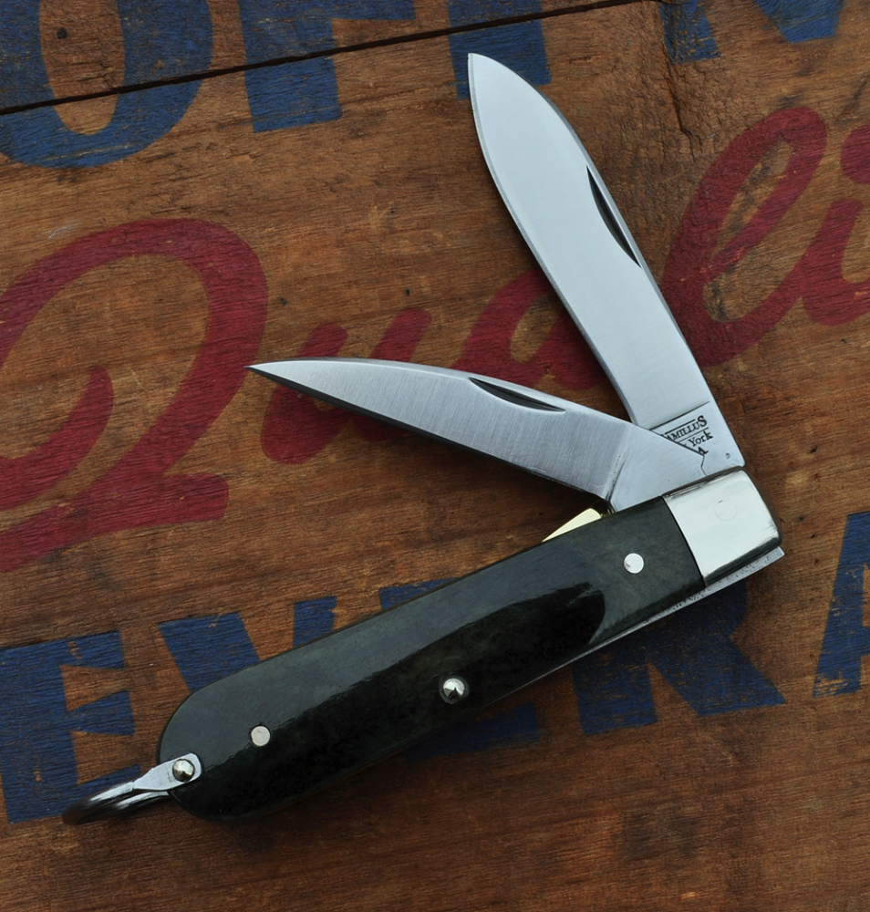

Just finished up a TL-29 conversion for a fellow member here. Re-handled in green camel bone, moved the lock to the spear blade and modified the tang of that blade to match the lock, then converted the screwdriver to a wharncliffe blade. Initally I just shaped it, but I wasn't crazy about the chunky look with that saber grind so I flat ground the whole thing. Here it is:

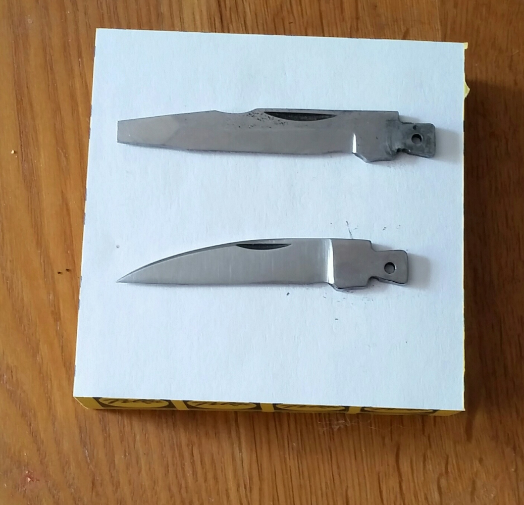

Here's a before and after shot of the blade:

That's a beautiful knife, Eric, and great pictures. ::tu:: ::tu::

You moved it to a new topic, and I still like this conversion! :lol:
And I love the Wharncliffe! ::nod::

Speechless ..... stunning conversion / custom ... I have never 'seen' that screwdriver as a wharncliffe before
But lay it out like that and its obvious. ::tu:: ::tu:: ::tu::

Absolutely amazing!!!! ::tu::

Great job in the reshape and regrind of the wharncliffe.
Beautiful knife conversion.

Best TL-29 mod I have ever seen. Great job on the wharnie...good call on the flat grind, it's perfect. Looks like you had to re-work the nail pull as well...and it looks factory done...amazing.

I am as impressed as the first time I saw it. Absolute genius.

That conversion is very well done. It almost appears to be a completely different knife. I have 2 Camillus TL-29's in excellent working order and they don't look anything like that. :shock: My word...
