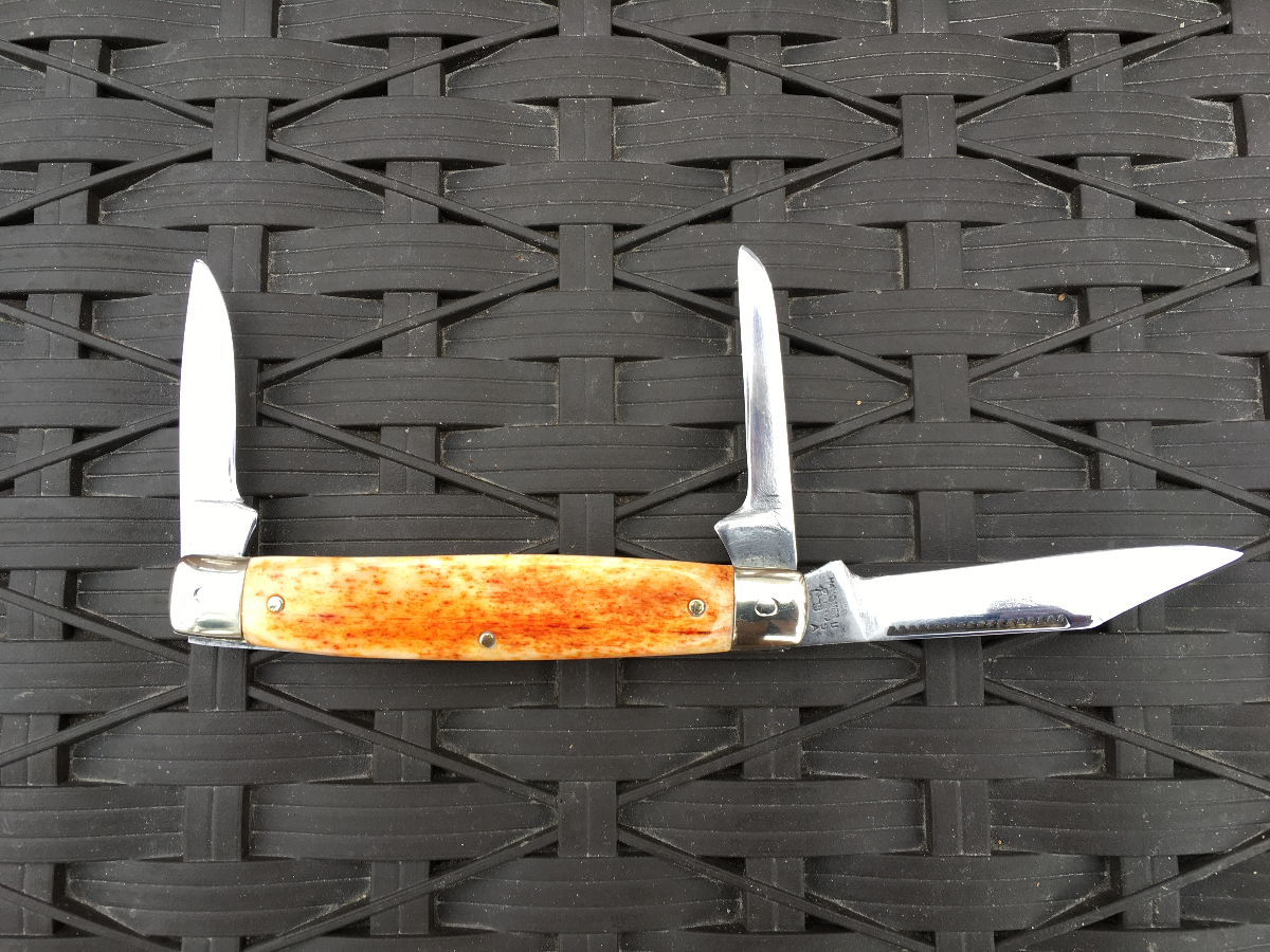

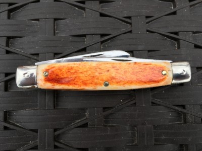

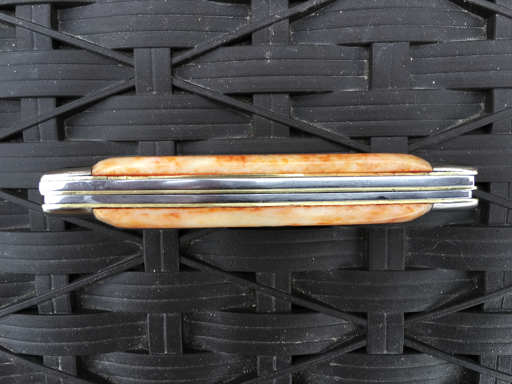

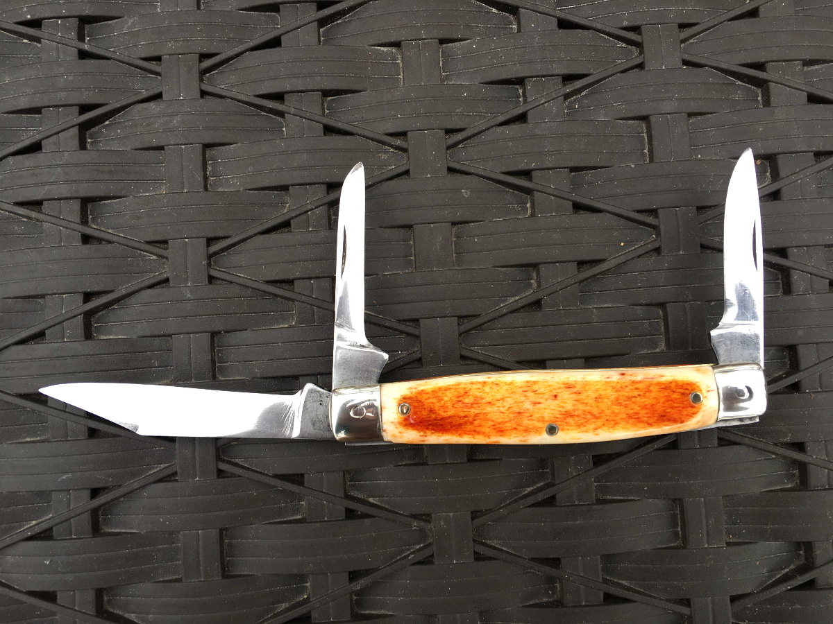

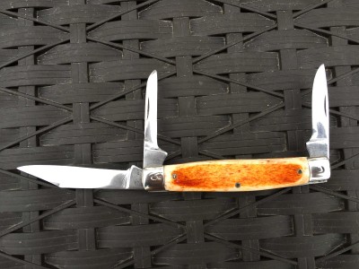

While this knife is far from perfect I think its good enough for a trip to E-Bay.
The new bone handles from Culpeppers are called Sunset (smooth). The blades had some heavy grinder marks in them, I managed to polish most of them out but a few remain. And I couldn't quite get the pivot pins to fill in the holes. I could have re-drilled the holes a bit larger but I opted to leave it be.
It'll make a nice EDC for someone and since I only need to get $20 for it it should be an easy sell.
So far each knife I've worked on has been a lesson. I had this one apart a couple of times for various reasons. Learned a few things about working with smooth bone. The smell when working with bone reminds me of the smell I get at the dentist office when he's prepping one of my teeth for a crown (or root canal). Surprisingly I don't find it all that offensive. I did by a better particle respirator mask though to keep the dust out of my lungs.

I used a file to shape the bone and it worked pretty well. I need to modify my file edges though, they’re causing problems. I’m guessing I can just grind the edges smooth?
Hopefully once Ive worked through the initial $100 of bone that I purchased, I’ll have a pretty good understanding of how to work with it.

I use a belt sander to make one side of a file safe. That's very common when doing file work on back springs.
If you sand one side of a 3 Square file smooth then you have a safe side to the file.
