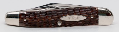

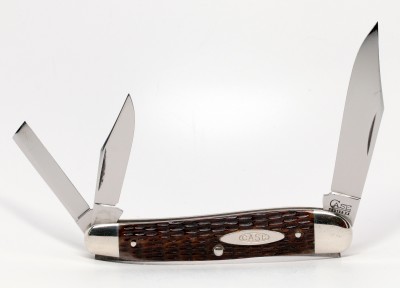

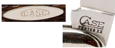

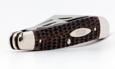

As stated in earlier posts, it is hard to really "examine" a knife just from photos. I agree with everyone who has posted that the first knife is definitely a complete fake. On my first glance at the second knife nothing jumped out to me as questionable. Then after Steve posted and Ralph posted the new photos I took another look. I'm not saying there is definitely anything wrong with the second knife. Here are some things I'd question without being able as Steve said to "have the knife in hand." First, looking at the lower bolster I see evidence that says the knife may have been taken apart. Looking at the backspring in the photos Ralph posted you can see discoloration and normal patina that you'd expect from a Tested knife or any knife with that much age. I do not see the same on the tangs of the blades. The coping blade looks a lot like stainless steel. That would also be a problem. I'd also like a closer look at the stamp on the main blade. Again, I'm certainly no expert and I'm in no way saying that the second knife is not authentic. I'm just giving my opinion on some things I see that might not even be relevant. I would also like to have Steve give a few comments from his perspective as to his concerns about the second knife. This is how we learn and like everyone else I'm here to learn as much as possible.

Larry asked me if I would take some pictures of his Case XX Tested 6380 and post them here and I agreed. I cropped these pictures but left them as very high resolution. The good news is they will enlarge to simulate using a high powered loupe. The bad news is the file size is large and the pictures will be slow to download. I felt like I should retain the resolution so folks would be able to evaluate the knife as best as possible from a photograph. Please let me know if you want to view the pictures but have trouble and I will reduce the resolution and resulting file size.
After handling the knife while taking pictures nothing obviously wrong jumps out to me. I am not a knife appraiser and I am not a "guru" level knife expert. I do have a decent size old Case collection and have handled several hundred old (supposedly) Case knives.
Enjoy the pictures.
Enjoy the pictures.

A few more pictures of Larry's 6380.

Looks right to me. Great pictures..

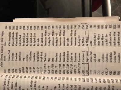

Thank you Ralph for the great pictures, they sure show food for thought
The 1941 Case catalog or price sheet has no mention of a 6380 pattern
The Case 1942 price sheet does not mention the 6380 pattern
The Case 1949 price list does include the 6380 pattern

Pocket knife Traders price Guide Vol.(9) 2010

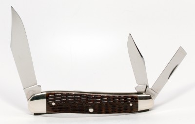

The original posted knife has what I call "alligator jigging," a great example of what Case did NOT do.

Hi folks. Just found out about AAPK site and started reading the forums. This topic caught my eye as I have collected CASE TESTED knives for years. The original post concerning the 6380 knife caught my attention. It is a FAKE as many others have already stated and the jigging is the most obvious reason. It just ain't CASE jigging from any era. However, there are other reasons: 1) the blades are made of stainless steel and 2) the dimensions of the knife are different from a real one. There are other patterns that have been faked. I have personally seen an '88 and a '65 and they have the same jigging as the knife in question ( and stainless blades).
