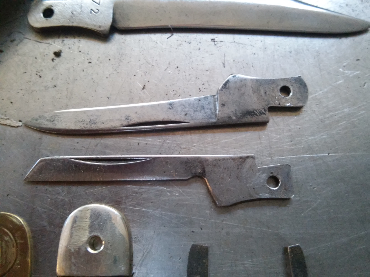

Wow do I have a bunch of 72 projects going on. Thank you's go out to Greg and Dale for their assistance with parts for the first generation that I am restoring. Greg provided a couple of beater second generation 72's that I could use for parts. And Dale for looking through his parts collection trying to find a coping blade for the first gen. Dale did not have any luck with finding one so I finally decided to reprofile the original coping blade. It looks much better now. Then I found a perfect pen blade for the first gen and then broke it while krinking the blade. So I reprofiled the old one and it turned out ok as well. Since both blades are a matched set I don't need to krink them!

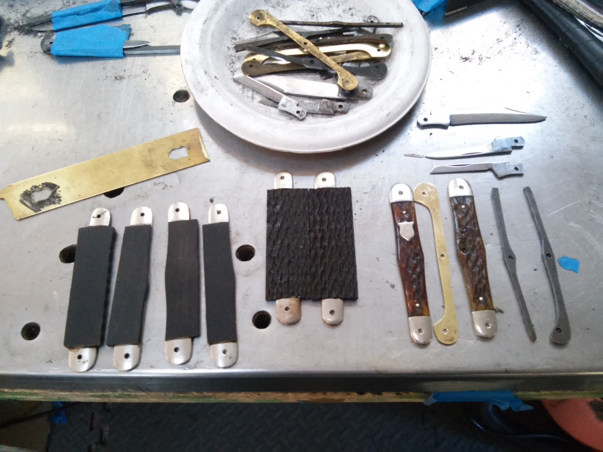

Then there is the 72 that I pealed off some nasty looking old Delrin handles and I am replacing them with Goldenrod jigged bone. I hope it turns out close to looking like the first gen!
Then I have two second generation 72's that getting Ebony handles and both will have shields. One of the two Ebony 72's goes to Greg! Not only did he supply the parts knives used here but the Ebony as well! The other is going in my pocket! Of course the first gen goes into my collection of 72's. Not sure about the Goldenrod 72 yet,might wind up in my store.

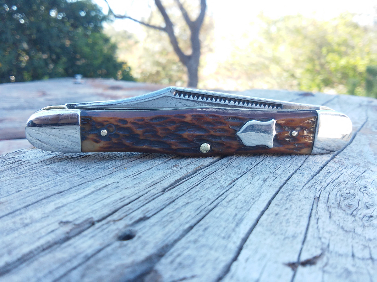

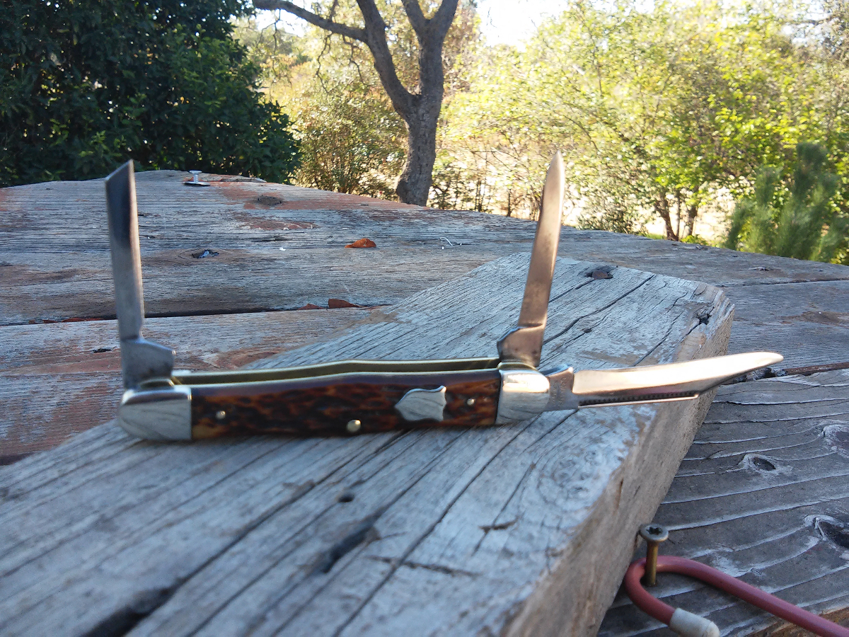

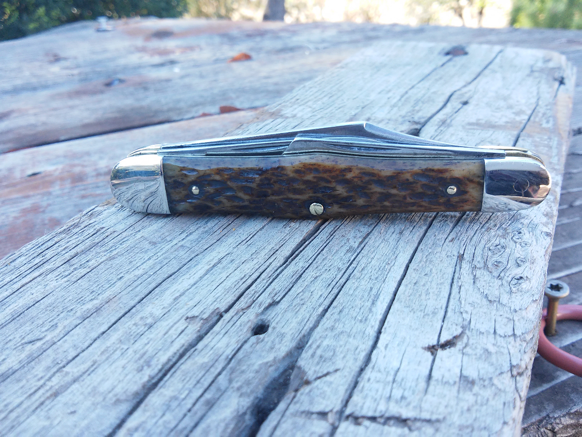

Thanks guys, yes I'm busy. But then I have nothing but time! Forced retirement due to poor health has left me with plenty of time. Well I finished the first gen 72 this morning. Thought I would show it now as I have knives to do for another member here and need to focus on those. I'll be back with the others when I'm done with those!
This one has been placed with my 72 collection. I'll post the other knives that I am doing for Eye Brand Man on a separate thread when I'm done with them. One is a Shrade Walden English jack and the other is a Case Tested XX Coke Bottle folding hunter.

Great work Randy. Looks real nice.

Beautiful workmanship.

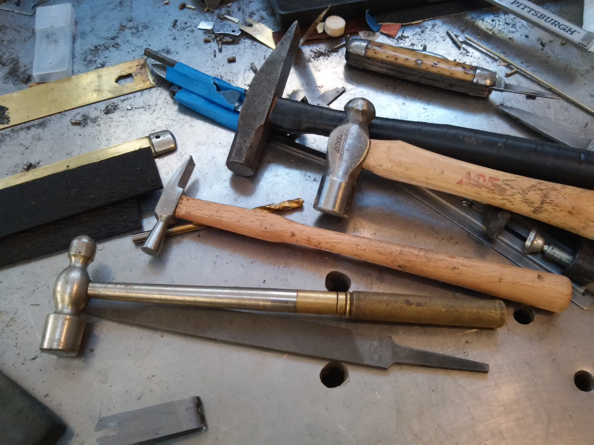

I especially like the finished look of the brass pins. What size style hammer are you using, and are you finishing them with a die?

Thanks Ken. I use a variety of hammers depending what size the pins are. For the pins on the 72 I used the 2 oz hammer with the brass handles at the bottom of the picture.

I tend to be a little heavy handed until I get the process down so I have bought 8-10 hammers ranging from 2oz to 16 oz, in all sorts of head configurations.
My next project is to use diamond rotary drills to dimple the ends of a few punches. The idea is to replicate that "spun" look or at the very least to reproduce the peening you can do.
Do you ever use a "die" to keep your heads in shape or is it all a matter of practice/experience?

For brass pins I just peen a nice mushroom shape with the ball end of my hammer and the final finish is done with a buffing wheel. I thought about a pin spinner at one time. But I am so satisfied with my brass pins I never bothered. I too considered modifying some punches, but as I thought out the process of making heads that way that I decided not to bother. It seemed like a lot of work. Peening is easy. Its having the right amount of pin above the handle surface thats hard to get right. Too long and you bend your pins or the head forms too high above the handle. The fix for that is file it down some more and peen it again! I find that only way they are bound to be too short is if you don't leave enough pin to peen a rivet head on.

Ken I really liked the modified punch approach until I realized that it takes two hands. One for the punch and one for the hammer. I find that holding the knife on the stiddy with one hand while the other does the peening gives me the best performance when it comes to peening. I like to rock the knife as I peen as well as turn the knife as I work. I also wear a jewelers loop as do this as I can see the head form as I work.

You should have both experience hammer peening and punches. Punches are used in very specific situations-like if the original pins were spun or otherwise formed.

Very nice 72s and super work as always Randy. I can’t wait to see the ebony done. You always do an outstanding job. You are one of the guys who inspires me. Thank you for that and keep it up.

That 72 came close to looking like the bone on the First Generation 72s. Excellent work!
