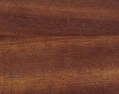

I mentioned before that if you want some to experiment with (this goes for all the knife makers/mechanics here) I have several hundred board feet of Lyonothamnus floribundus (Catalina ironwood) that is approx. 60 years old.
I have 2"x2" squares about 16' long, and I can/will cut them down to whatever length you want. No charge... Call it paying forward.
Send me a PM or Email with an address, and I'll send what you need. No worries! ::tu::
Some images from the trunk, and stem wood
Ken Mc.

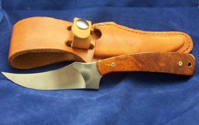

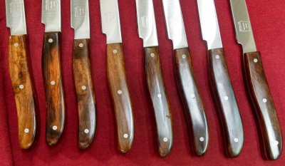

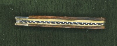

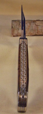

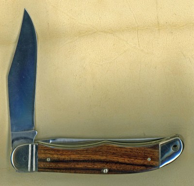

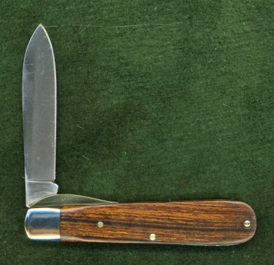

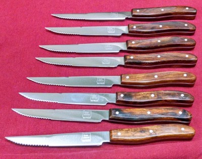

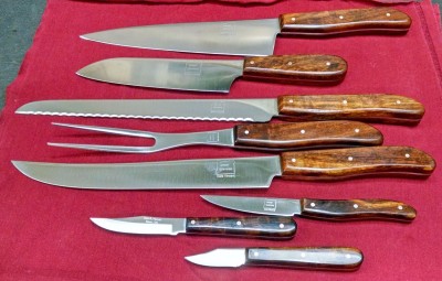

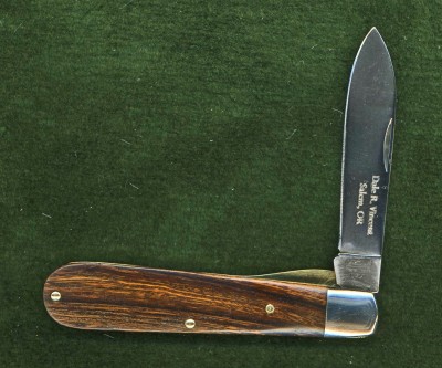

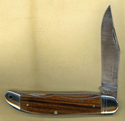

Desert ironwood is interesting stuff to work with, you can find pieces of sand embedded in the wood and you can also find voids in the wood. If you have never worked with it before, probably the first thing you’ll notice is the distinctive aroma that it gives off when you sand it or cut it, and aroma I can only describe as Eau de Dirty Diaper. It is really not the most pleasant wood to work with.
On the other hand it can be absolutely gorgeous! I will post a few pictures of some of the knives I have done with desert ironwood. Although the pictures aren’t the best, I did a set of kitchen knives and steak knives for my nephew’s wife.
I got a good deal on some desert ironwood a few years ago at a show and bought about 70 pounds of desert ironwood at the end of the show because the seller didn’t want to carry it back out to his car. If it would’ve been oak or fir wood I would’ve been able to carry it in one armload as if carrying firewood into the house. As it was it took me two trips from the show out to my car with the wood and I think that was with a lightweight handcart to help with the hauling. The stuff is unbelievably heavy!
There are couple of different ways I have finished desert ironwood, one way is just to buff it with a fine abrasive like No Scratch Pink or Jackson’s White and then apply hard carnauba wax with a hard sewn buffing wheel. This was the first method I had used with desert ironwood. The second method I use and the method that I used on the set of kitchen cutlery is to do one or two light coats of thin CA glue. I found Zap-A-Gap thin to be best suited for this because it would soak into the wood rather than hardening on top of the wood like regular CA's. I used a fine ScotchBrite pad between coats. After the second or third (if needed) coat of thin CA I buffed the ironwood with No Scratch Pink and then apply a coat of hard carnauba wax. You can see what the finished ones looks like in the picture of the kitchen knives.

Wow! Pretty stuff! ::woot:: Dale you don't do any thing half way, great lookin' handles!

Dale the handles on those knives are beautiful. I especially like the Schrade. The handles set it off. The more I learn about knives the less I like Delrin and synthetic. All of the lockback Pakistan knives that were made with wooden handles were so ugly and ordinary it eliminated wood from consideration as a handle material. Knives like these and some of the GEC knives have rekindled the beauty of wood in cutlery. Nice work.
