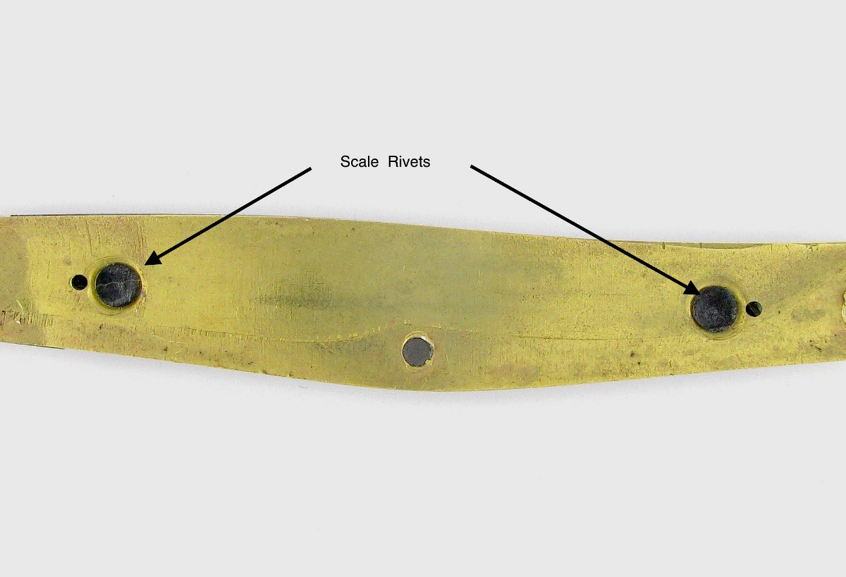

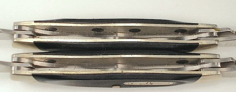

The Delrin and Valox scales for the 303 are a thermoplastic resin and are injection molded to the frame by an outside company. Buck does not have the equipment to do that procedure. The heated plastic is pressed on to the liner and some of the plastic passes through holes in the liner to form a plastic "rivet".
Bert

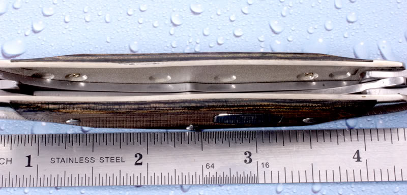

Here is a photo, courtesy of 300Bucks, showing interior of rivets on Dymondwood.
Bert
