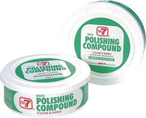

Work it the same as any other material but do not overwork one area, and create heat.
Acrylic will pull, and deform into micro-valleys when it is over worked.
I find that 1500 grit emory paper is as far as I have to go. From there I use Dupont #7 white "Polishing" compound followed by a micro fiber towel to polish it.
A neat trick... Use a benzomatic torch directly over 1500 grit finish, and when you get good with the torch, there is no need to polish.
Practice on scraps tho... it takes a SECOND to ruin it.
