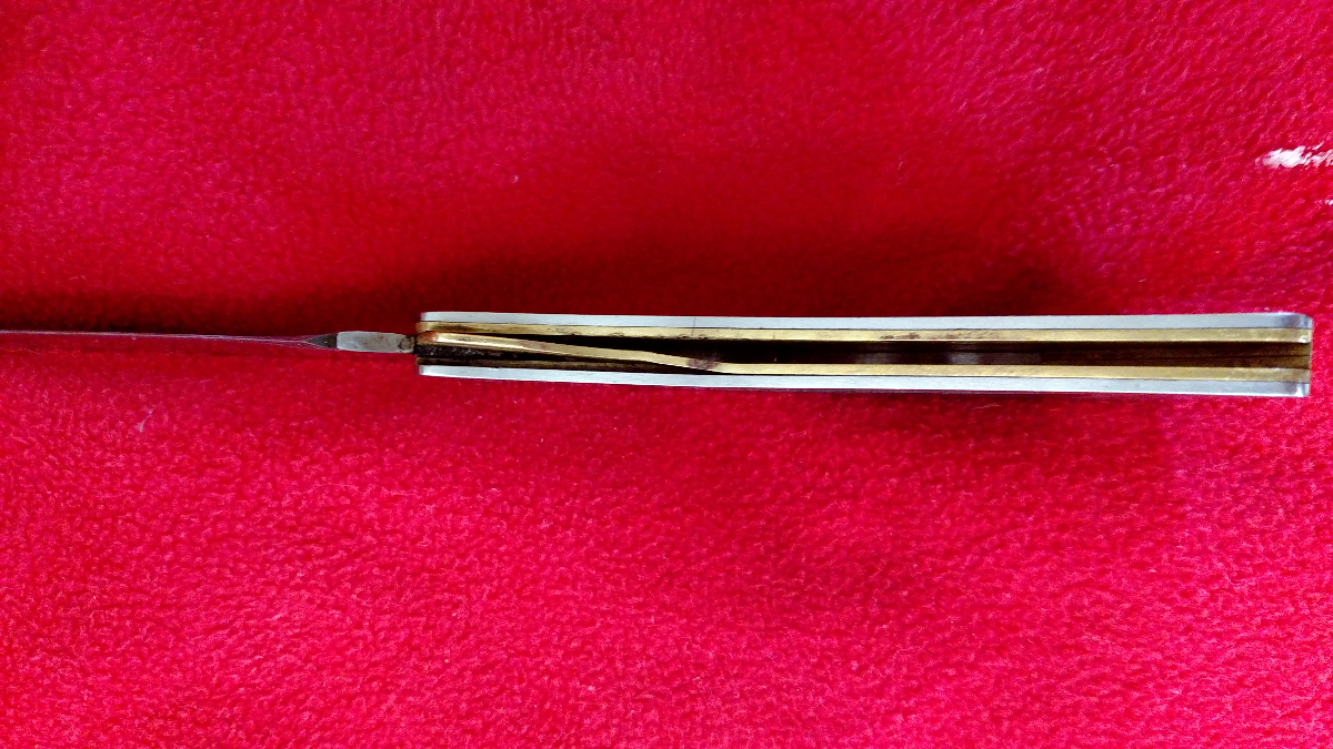

I finally got around to this PK-2 I found awhile back. It's in pretty good shape other than the lock.
This project is a little intimidating to me because I know me.
I can tear stuff up so it ain't fit for the job yard. I don't really want that, so I'm looking for a little advice on the way to proceed.

Can you post a side view of the knife? Never mind, found it...
One fix is to disassemble the knife, and use a small drift punch to "tap" the end of the liner lock expanding the metal to effectively lengthen the lock.
It looks like the blade was forced toward closing, bending the lock so that also has to be addressed.
Either you are comfortable tearing it down, or I am certain a member here can do it for you.

The knife may have to come apart to be properly repaired. I don’t like to drive those pins out with the drift because they are tapered and driving them out can mess up the taper of the hole, essentially reaming it out so there’s no taper and the replacement pin won’t stay in securely.
I use an undersized drill for a center pilot hole and then use a larger drill to enlarge the hole until you have removed the center of the pin down about 3/32” so that when you do tap it out the thinned wall of the tapered end of the pin will collapse inward and not enlarge the hole. This will save you having to drill the hole oversize and re-tapering it.

orvet wrote:The knife may have to come apart to be properly repaired. I don’t like to drive those pins out with the drift because they are tapered and driving them out can mess up the taper of the hole, essentially reaming it out so there’s no taper and the replacement pin won’t stay in securely.
I did not mean to "drift" the pins out. You are 100% correct on drilling them.
What I meant was using a drift to expand the metal on the end of the liner lock (if needed) to prevent 100% plus lock up.
That is of course once the knife is disassembled, and the liner lock bar is straightened or actually returned to its functioning position.
The Vid. I linked shows a fella "peening" the liner lock bar to fix that 100% plus lock up issue.
I really don't think the OP knife can be fixed without disassembly. Maybe you can get it to close but not to work correctly without tearing it down. JMHO
