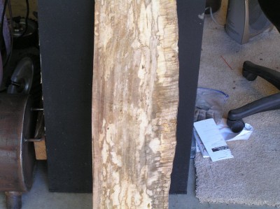

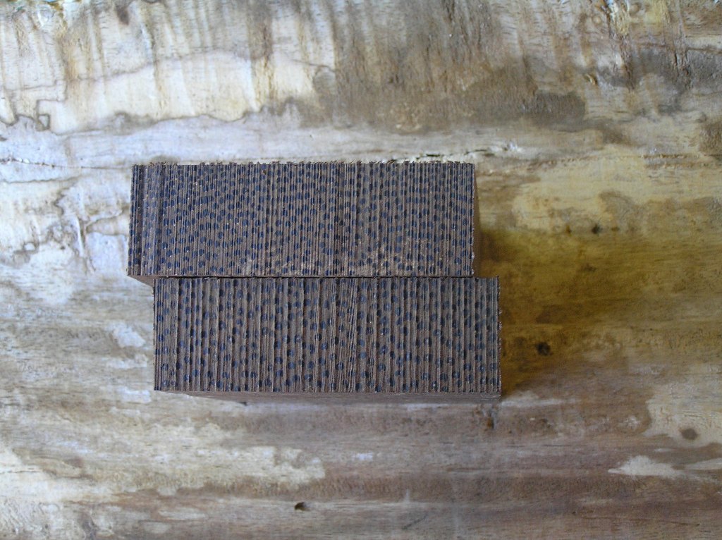

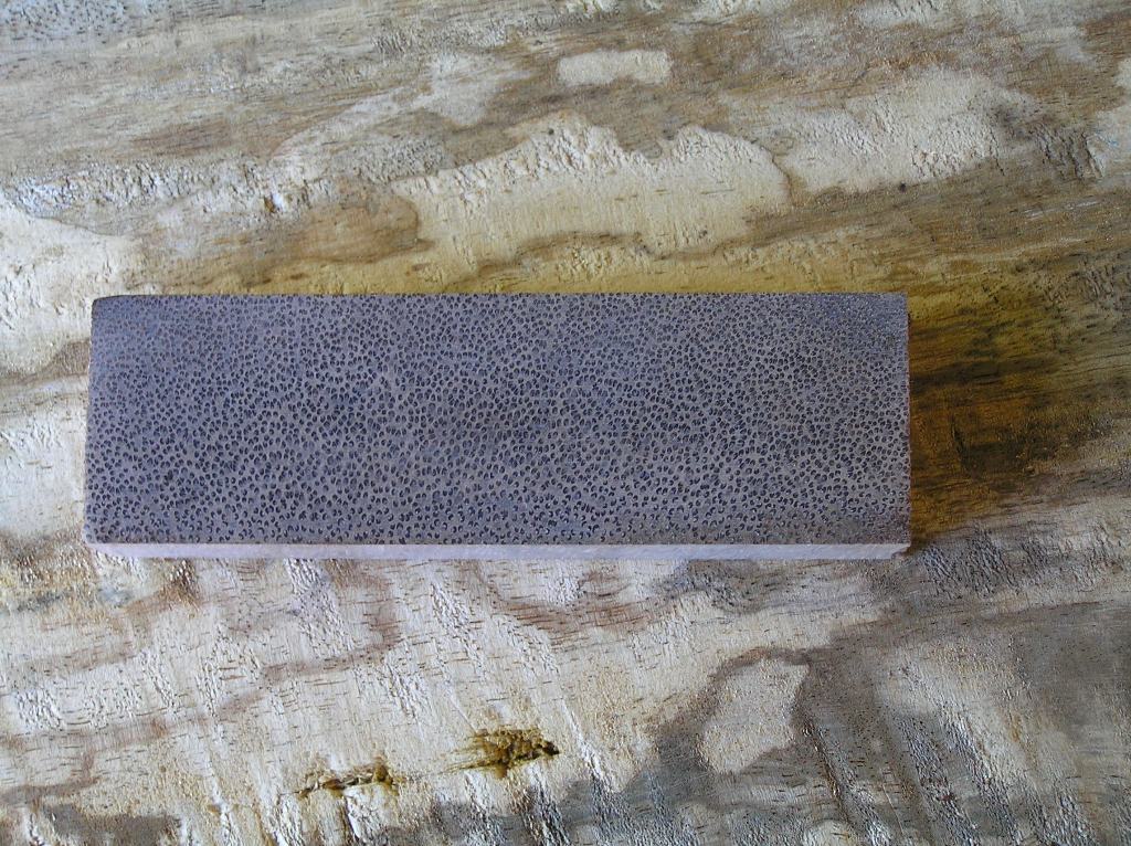

I will send these off sometime this week to be stabilized at K&G in Arizona. Why K&G? In this case I think they are as good maybe better, as WSSI, but my primary reason to use K&G is shipping. I do use WSSI and K&G, so I'm familiar with both. I always use white correction fluid to mark these with my initials and a # to help me keep track of them after I get them back. So, I will put DH200, DH201 and so on. I keep track of them on a sheet of paper and wil be selling them until my cost is next to nothing or nothing. These are 3-7/8 long x 1-1/4 wide. Hard to find bigger Black Palm Lumber. I have these cut to 1-1/8 after I sand the the ends down and be cut to thickness as desired.
It will cost almost twice as much to ship these woods to Iowa, so to K&G in Arizona they go, I live in the same zone.
I also have some Spalted mango to send and I'm waiting on a piece of hard wood that does not need to be stabilized. I am searching for ONE more before I send it off, at 10 LBS, I get a price break.
Black Palm tends to go real fast. ::doh:: I make a couple knives and sell it pretty quickly.
Spalted Mango
Spalted Mango
Red Palm - end cut Grain Already stabilized
Black Palm - end cut Grain.

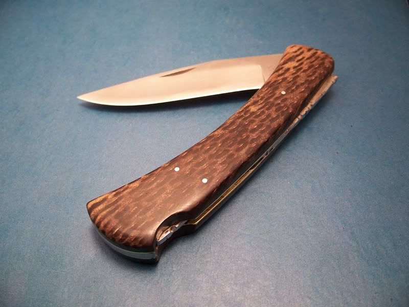

Thanks, some of it I will leave natural, actually most of it. Some will be cut for hidden tang knives and I do plan to color some. I buy the dyes from K&G. I measure it out with a 10CC syringe and this dye is very concentrated -7CC in a quart is quite bright about 30CC for an oz, so I use 7.5CC as a base for quart sized containers. For some colors 3CC (1/10 oz) to a quart is just fine.
For some of the palm I plan to cut 1/2 inch blocks, (cut in half is slightly less that 1/4 inch) looks good on a slippie. ::tu:: ::tu::

looks good on a buck 110 too, I like the stuff alot
