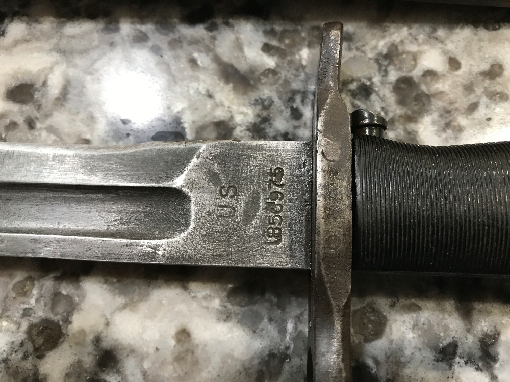

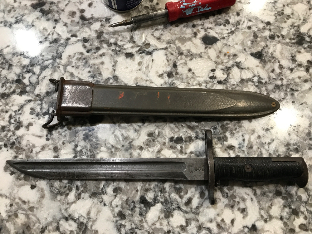

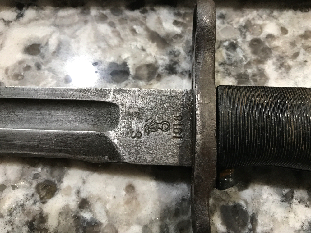

I finally laid the cash down for this cut-down version from a local pawn shop. The "button" was missing, so I purchased a lug/lever, a spring and a button from EBay. The seller specified that this "repair kit" came from a Pal M-1.
So...I used the button from the kit, the spring from the kit (it seemed "beefier" than the original in the knife I purchased) and the original lever/lug.
There was a significant difference in the levers...the original was heavier in all aspects.
Here is the finished, repaired knife. Works smoothly and locks tightly into the scabbard.
Satisfied with the entire process.
And I learned a ton about this piece of history in the process.
