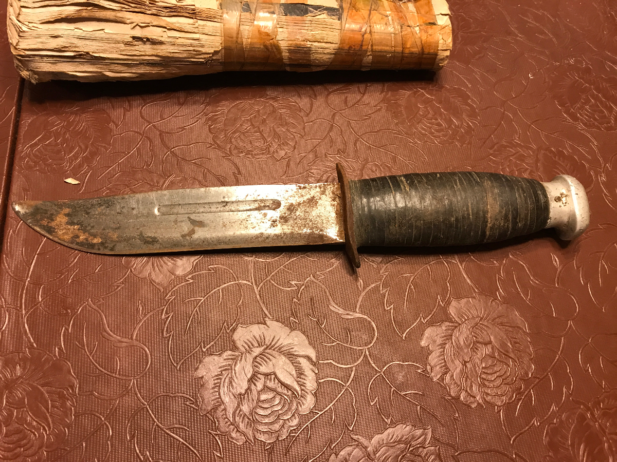

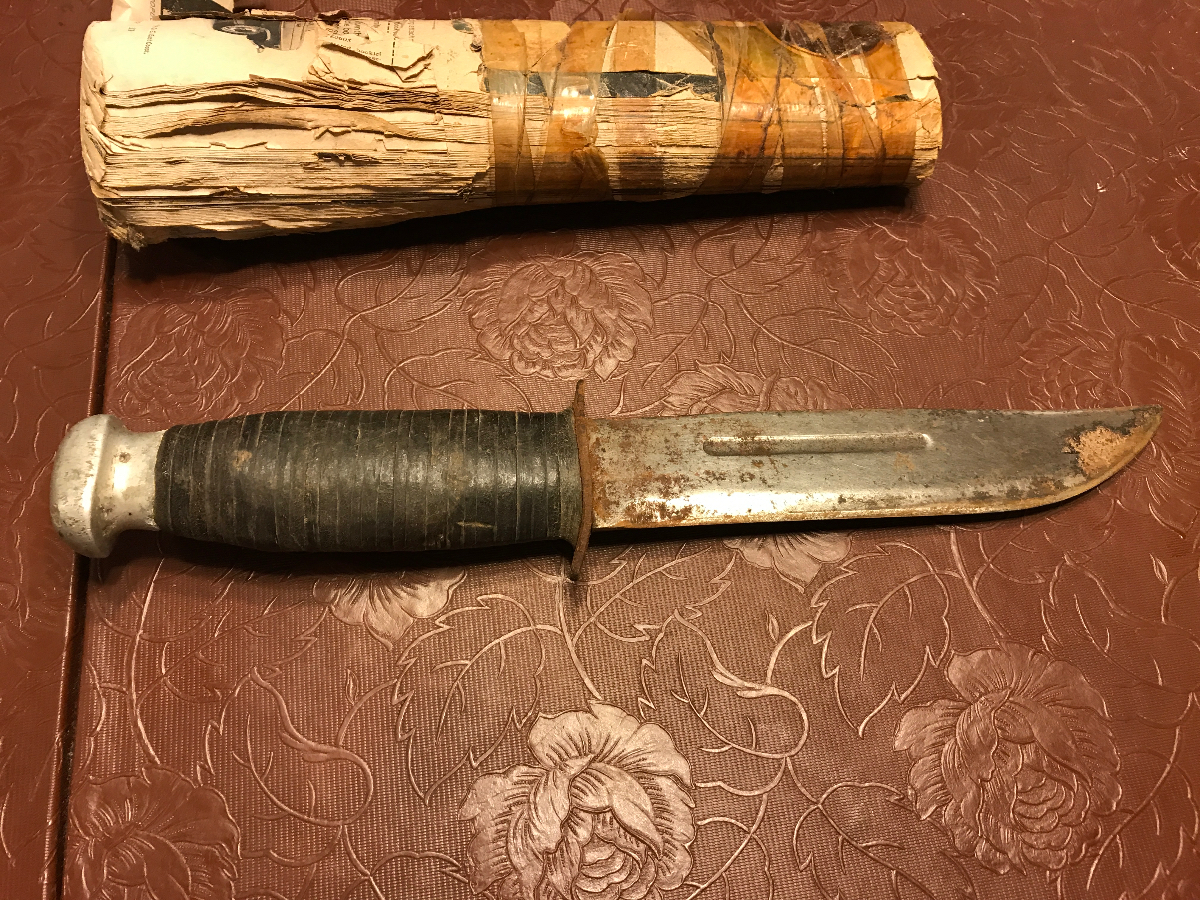

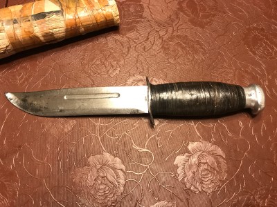

After reading through viewtopic.php?f=38&t=47909&p=570319#p570319 I was inspired to see how well I might be able to clean up a couple of my Dad'd old knives.

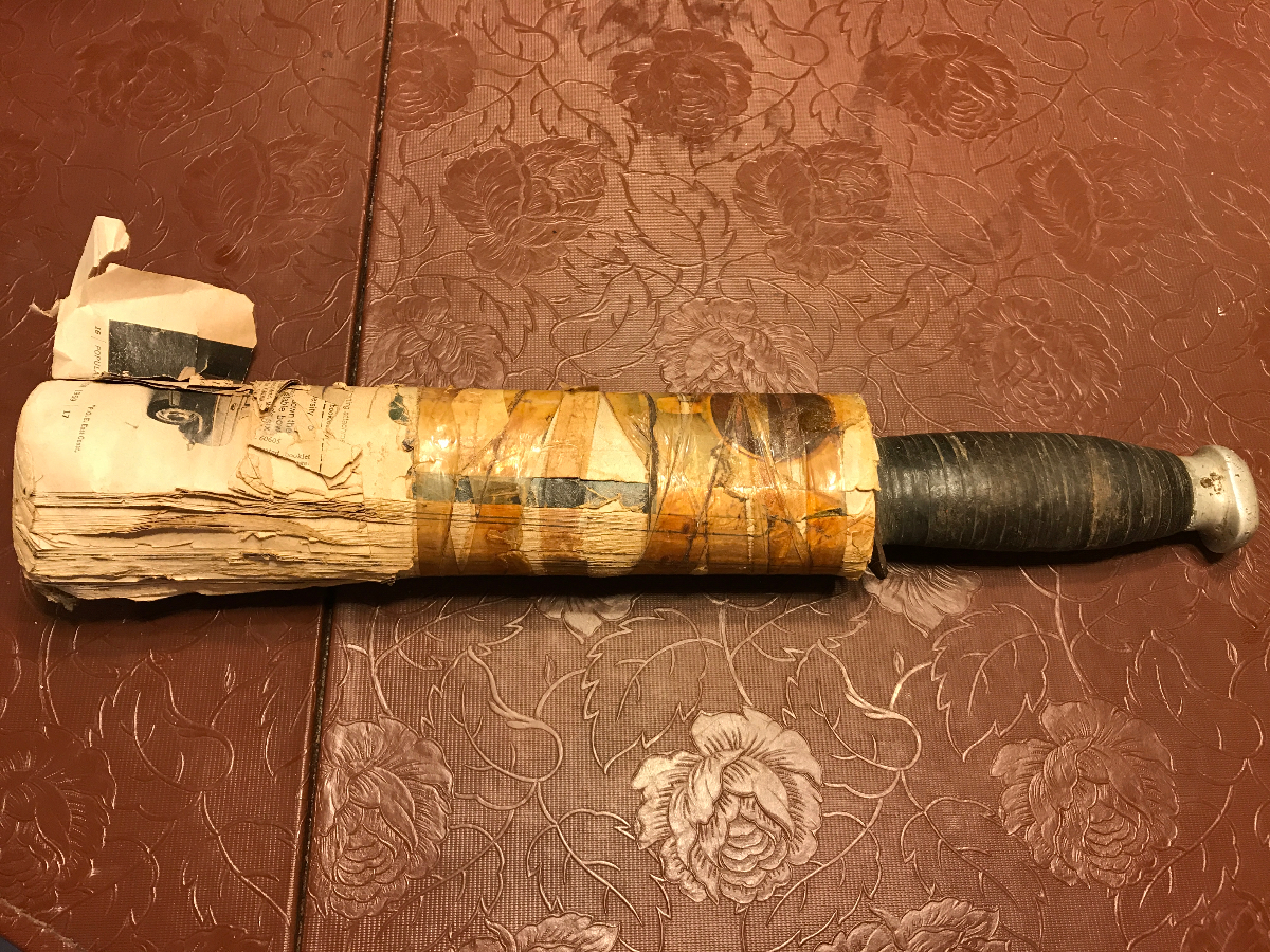

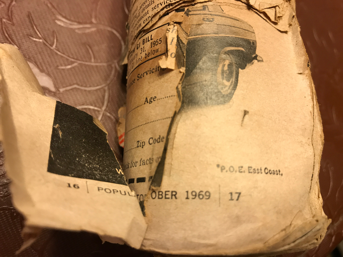

The first one is unmarked, no information stamped anywhere that I can see. It is it its original "sheath" that remember from when I was about 4 years old. I feel like I might remember that it came from his time in the Navy but can't be sure on that. The last 30 or so years it has been in that sheath - which I think I remember him making - stored away in very poor conditions to be honest.

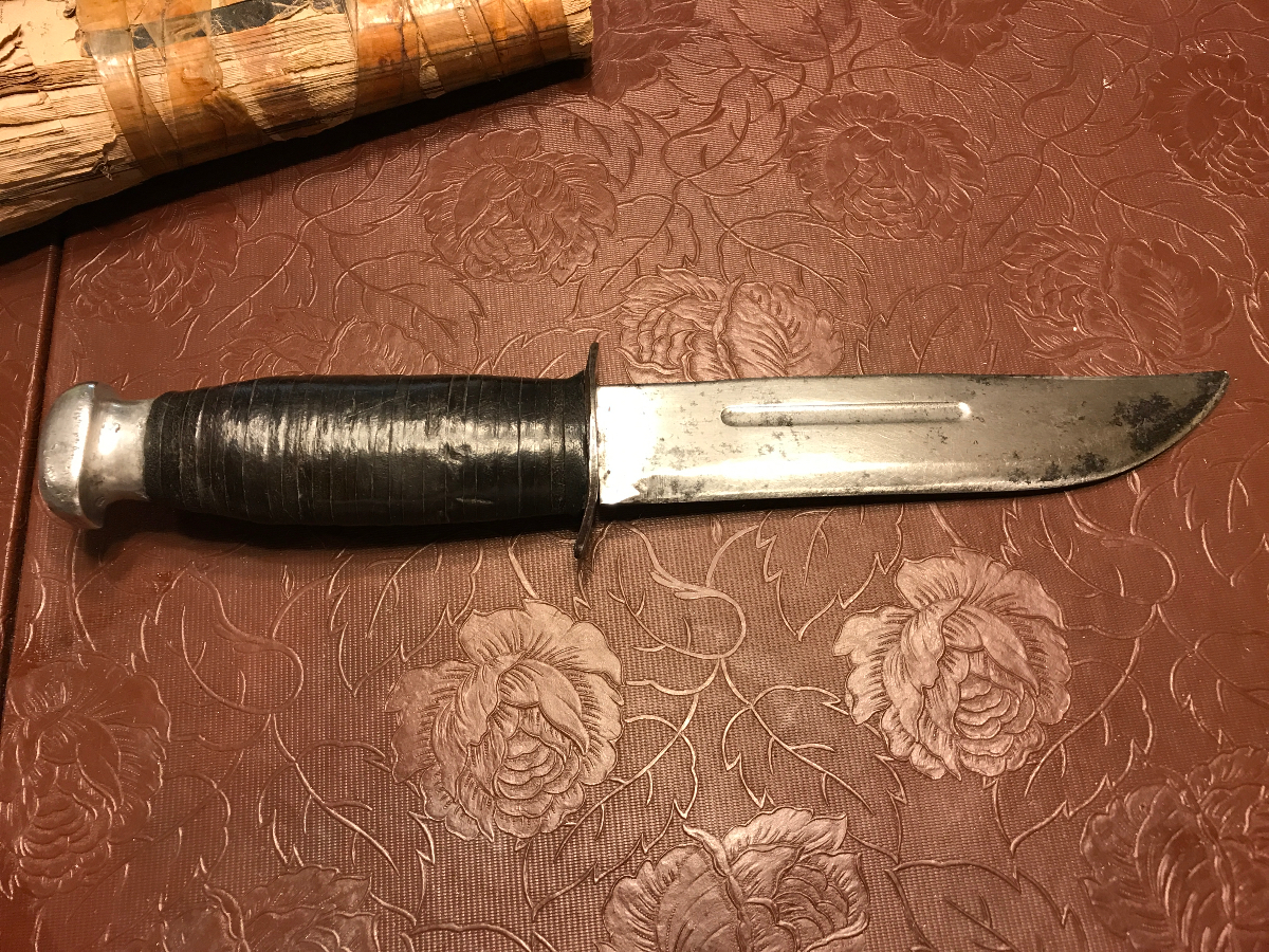

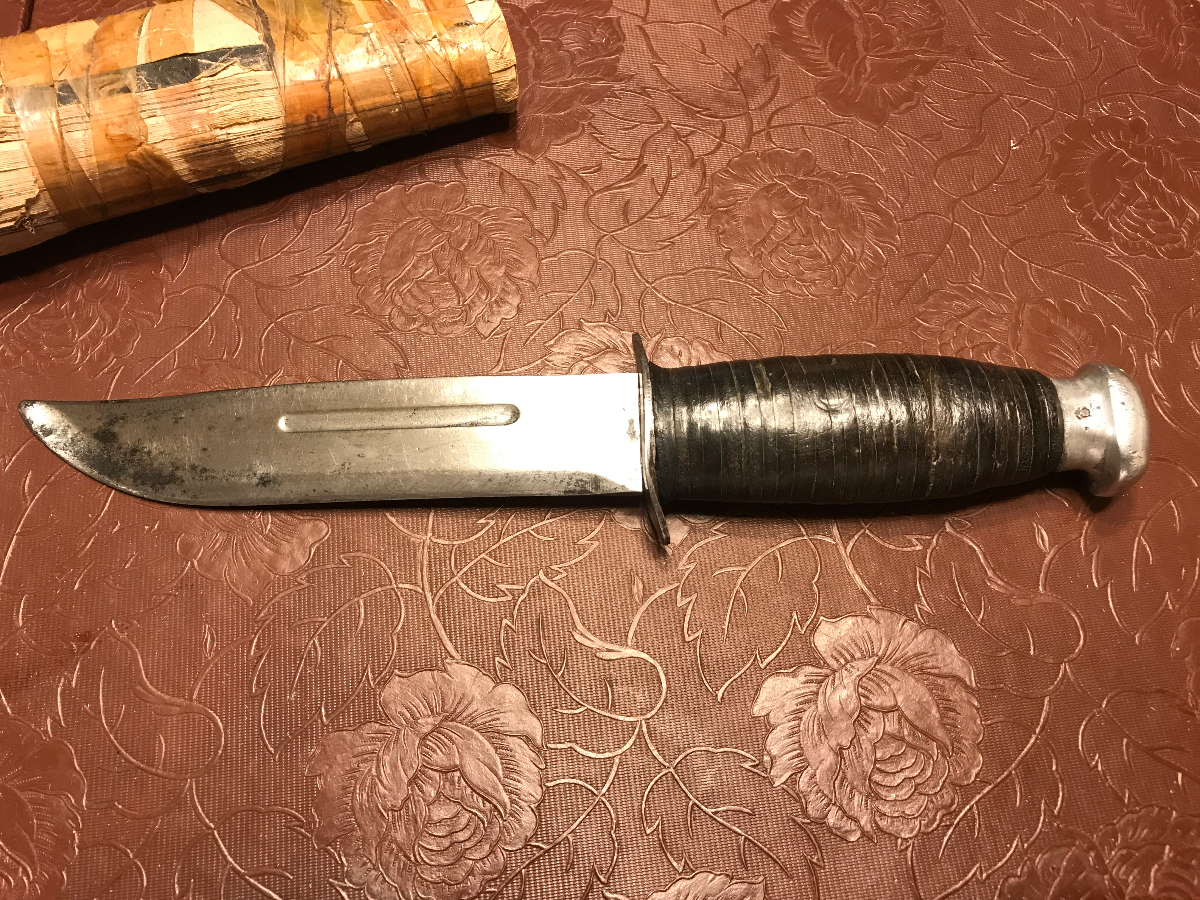

I used basically the techniques in the above post leaving, for now at least, most of the patina (it did take some light sanding to remove all of the rust). I may change my mind later but for now I wanted it to look old like it should not nearly new. I haven't and may not sharpen it; I expect I'll never use it since I never have.

Not bad Greg but next time be mindful of each flat surface of the blade and do them separately to retain the crispness of the grind.

Thanks, Greg. I will be more mindful of that on my next go aroundgsmith7158 wrote:Not bad Greg but next time be mindful of each flat surface of the blade and do them separately to retain the crispness of the grind.

Greg: I don't think I understand the part about "each flat surface". Do you mean the blade should be cleaned in "sections"? I've never done this before but I have 2 Western Fixed Blades that need a good cleaning so I would like to understand what you mean.gsmith7158 wrote:Not bad Greg but next time be mindful of each flat surface of the blade and do them separately to retain the crispness of the grind.

Mike on this one you have the bevel that creates the cutting edge, the blood groove and the main flat of the blade. If if you don't do each area separately you can round off the edges that of the original grind.
Some blades have many different angles such as swedges and deep nail nicks that you need to pay special attention to in order to maintain the crispness of those angle edges.

Okay Greg I think I understand now. Thank you.
