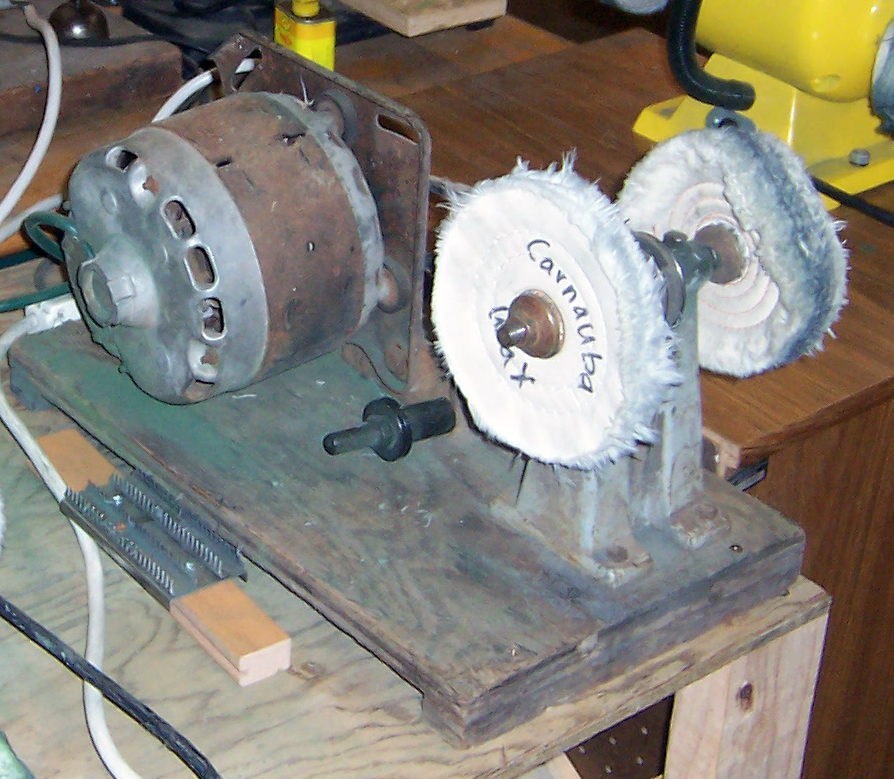

This is a homemade buffer I use. My dad made it and I think he said it is a 1/4 hp washing machine motor.
It has 6 inch wheels on it in this picture but I am currently running it with an 8 inch wheel on one side. Doesn't even seem to slow down appreciably with the 8 inch wheel. It's a great secondary buffer. I need to put together another buffer so I don't have to change wheels is often.
