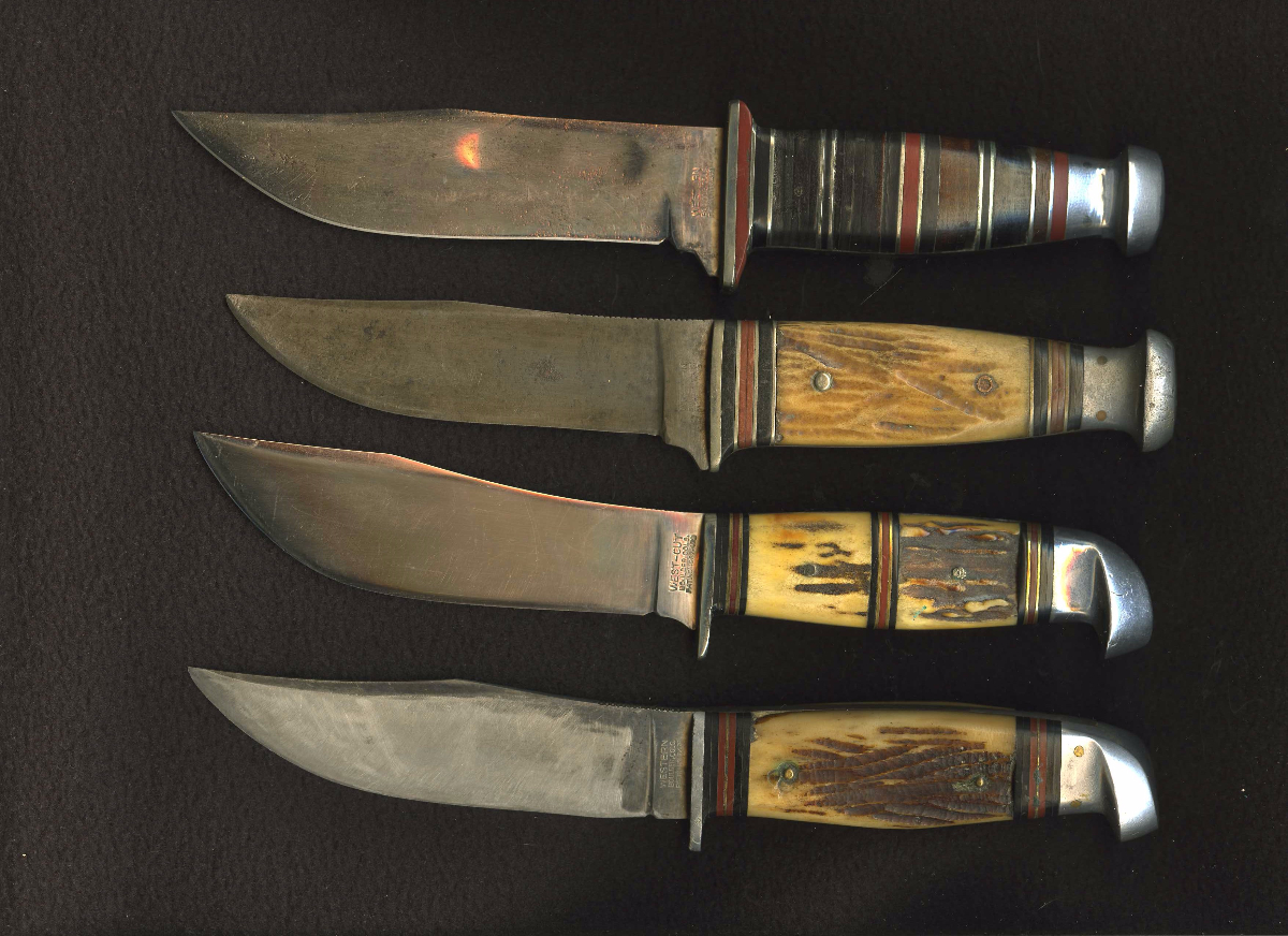

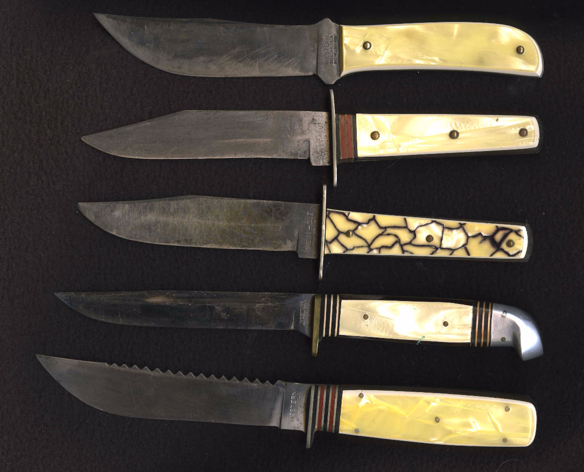

- tongueriver
- Posts: 7239
Re: etched in jello facts
Oh, shucks. Just fer fun:
Cal,
Thanks for the very useful information up above! I am new to collecting Westerns, so this will be really helpful. Secondly, your photos of the old Westerns is AWESOME!
Dave - the new guy.

- Colonel26
- Bronze Tier
- Posts: 10404
- Location: Kentucky
Cal those are fantastic!!!!

- jerryd6818
- Posts: 39458
Cal, you have some real honeys there.
