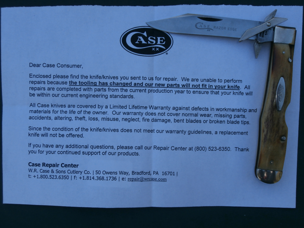

The second was this 1976 Stag Cheetah which was returned unrepaired along with a form letter enlightening me on the significance of the Limited part of the Lifetime Warranty.

Just curious - was the backspring broken? If so I'm surprised that Case did not offer a replacement knife. A broken backspring is always to be considered a warranty issue in my opinion, unless the knife has had EXTREME abuse, like being put through a power trip hammer.

Yes...it broke into two pieces...snapped approximately in half.
According to Case, the reason this knife cannot be repaired is because their "tooling has changed" and "the new parts will not fit [my] knife" (see the bold, underlined print in the return form letter). Like you, I feel that a broken back spring is a perfectly valid warranty claim, but apparently Case feels that a broken back spring "does not meet [their] warranty guidelines" for some reason.
As for abuse: This Cheetah has never even been carried, used or sharpened...it still has the original factory edge and was stored in the closed position (not part-way open or in any way that would maintain constant tension on the spring). So, apparently, opening and closing the knife repeatedly over the course of 40 years is considered "normal wear" according to Case, thus they did not send a replacement knife as per their provision for knives they cannot repair in the Limited Lifetime Warranty.

Well the tooling for the 111 1/2 pattern has changed over the years so I'm sure they probably did not have the correct vintage part to do the repair and it is not cost effective for them to make the part by hand (which is what I would do). With lockbacks like this the spring is CONSTANTLY under pressure no matter what position the blade is in. Still no excuse for the spring breaking. Old stainless springs seem to be very prone to breakage (in many brands, not just case) though, more so than carbon steel springs. It makes me think they didn't have the temper worked out properly. Personally I would have rather had them return the broken vintage knife so that I could seek repair from other sources rather than have one of the modern manufacture knives. They may have took this into consideration when returning you old knife instead of giving you a new one that is worth 1/2 to 1/4 of what your old knife is worth. Just my .02

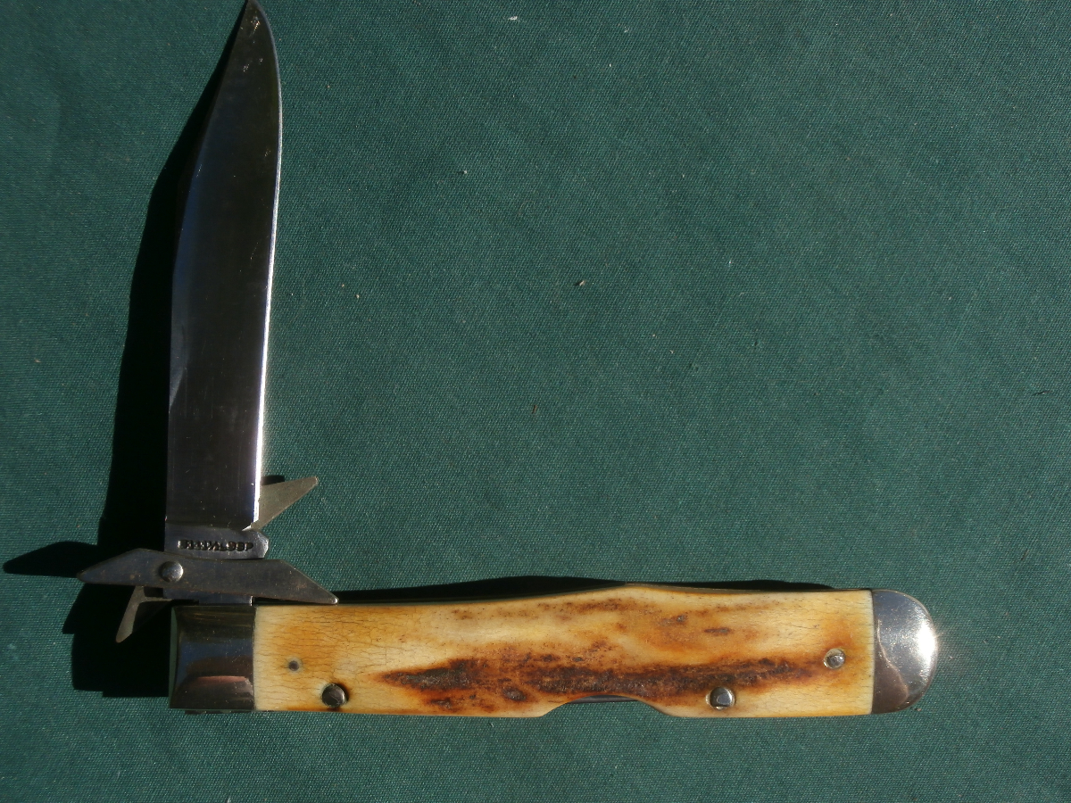

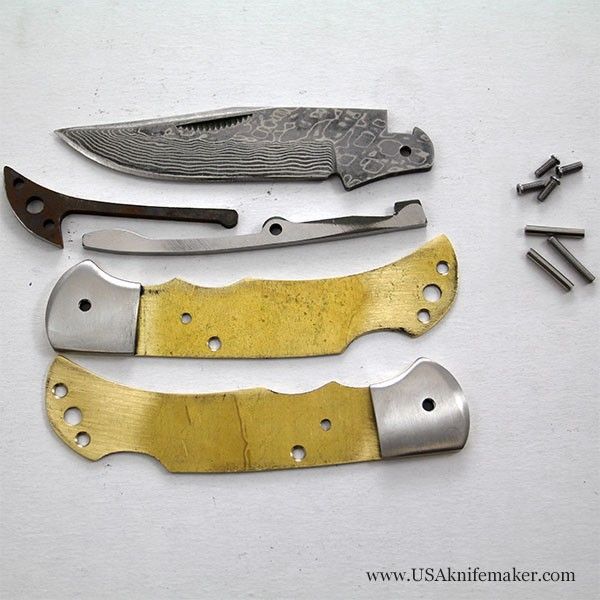

So it can be understood here is a picture of a knife with the Cheetah 2 pc. type of backspring. This is not a Case knife but has the same style of locking mechanism. The one pc. is a tension locking bar and the pc. at the rear has a prong extending out that is in constant contact with the tension locking bar. Over time the prong weakens with age and it snaps. I once spent 4 hrs. trying to make a tail pc. Was really proud of myself that the knife went back together. Within about 10 openings and closings the prong snapped and I was back to square one. Decided to find a donor knife on ebay and make the switch. If you make your own it must be heat treated correctly and that is hard to get right without heat controls. An option is to cut a slot in the remaining tail pc. with a Dremel tool and use a pc of spring stock from Jantz and replace the prong. Other knife makers use that system.
Men make plans and God laughs

Cool...thanks for the exploded view, jbob.

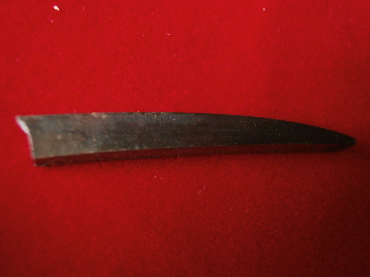

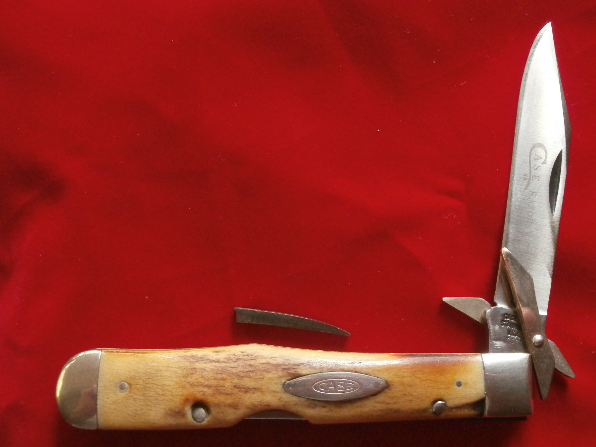

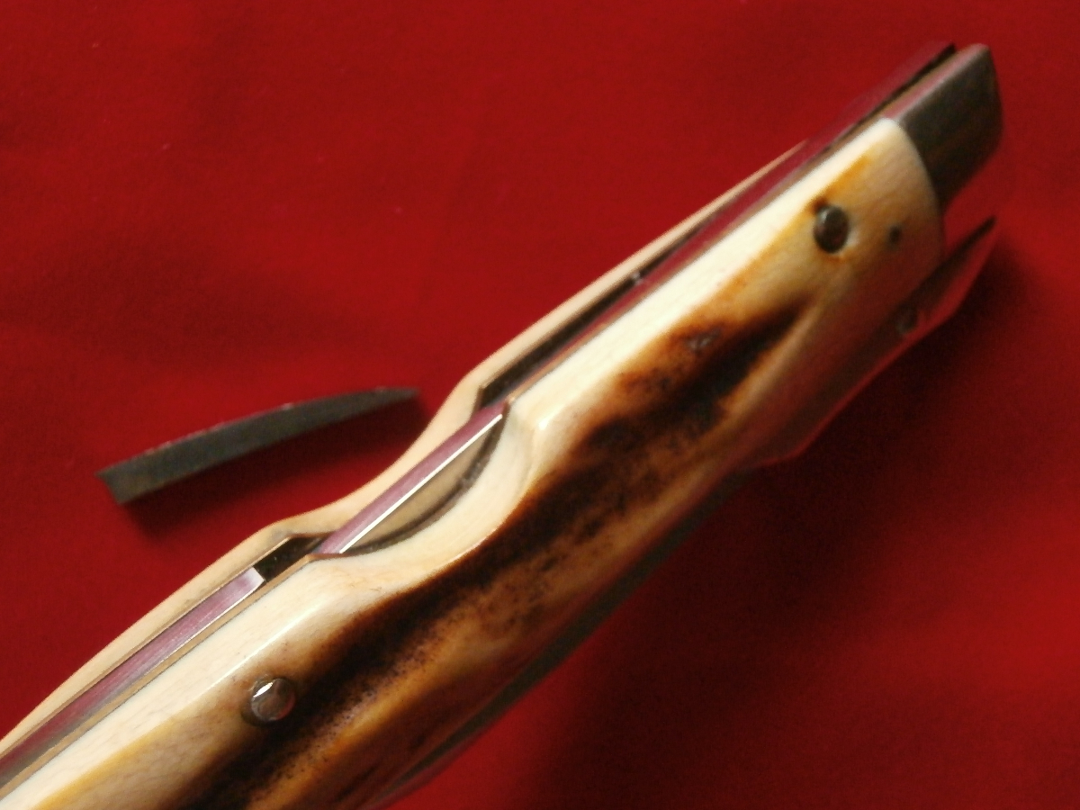

Here's mine with the "prong" that broke off the rear spring.
~Q~
~Q~
