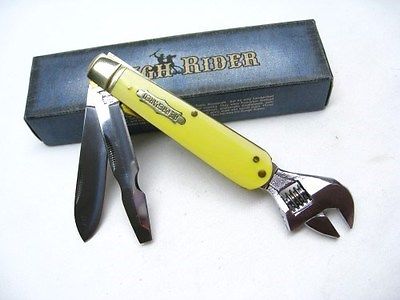

This one was $8.72 shipped. Not a huge deal but the worm thumb adjuster for the Kentucky Socket Set (adjustable wrench) tool has about 1/8" of slop, back and forth, in it. The second and most serious fault is the screwdriver blade lock. It doesn't. The liner lock is just a smidge (that's an RCH for some of you folks) too long and won't snap into place behind the blade tang. At 5-3/8" closed, I don't see anyone carrying one in their jean's pocket so it's just a little (lot) big for EDC. The pull on both blades is 8+. On the very border of nail buster country. Main blade is sharp though. Paper slicing sharp so that's a plus but in my opinion the only one.

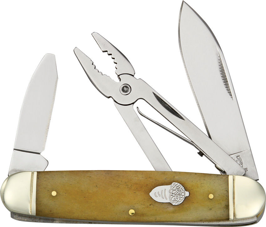

The second one was $11.15 shipped. Out of the box, the springs on this one are about 20% stronger than needed. The main blade isn't bad at about a 6-7 but a picture of the secondary blade is in the dictionary under "nail buster". Not only is it a nail breaker of the first degree, it's a very odd combination. They've taken a pen secondary blade and re-profiled the tip as a screwdriver but leaving a 1" cutting edge on a 1-5/16" blade. ::uc:: The little bugger is just flat out dangerous. The pull on the pliers is strong but not outrageous. However, the joint on the pliers is as loose as a goose. I think I can fix it with a hammer so it's not an electrical problem. The pin at the joint just needs to be peened a little bit. The odd thing about the pliers is the spring. There are two of them side by side like a whittler where the main rides on two springs but at the other end the secondary blades ride on the individual springs only on this knife there are no secondary blades at the other end, just the pliers using two springs. Weird. Like the other one, the main came paper slicing sharp. F&F on both knives is as good as any new knife but I can't get Harbor Freight out of my mind.
