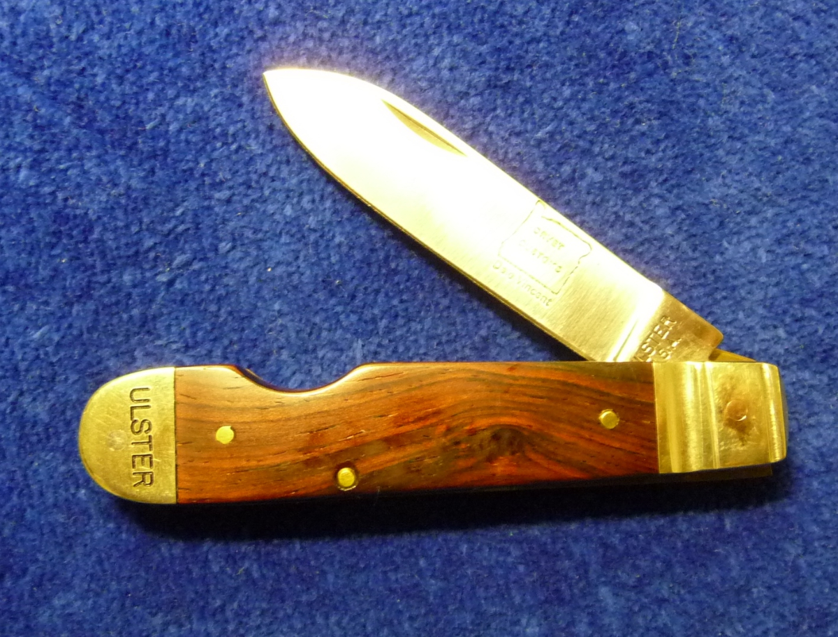

That is an incredibly beautiful Barlow you have there. It is a style that is dear to my heart, and like you had some knives re-handled by Dale. The Ulster started out as a two blade TL-29. Dale did an exceptionally good job on it, and he had to invent ways of getting it to the way it is today The Cocobolo handles are excellent. I have a great respect for Dale's customising abilities. Thank you Dale, they are all on display in my Knife Cabinet.

Ulster TL-29-by Dale
