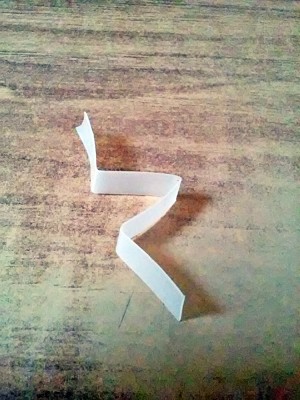

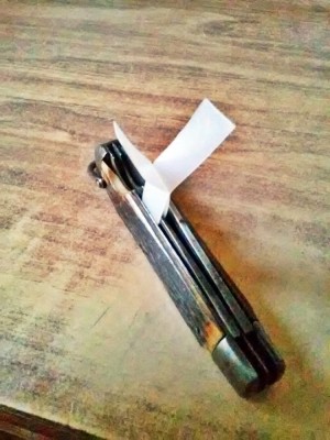

You might contact Case to see what they will do for you. In the meantime a work around is to fold a business card in half or fold a piece of paper then fold that in half. Slip the fold down into the blade well under the blade, keep it towards the blade's tip for leverage and pull up. Easy peasy lemon squeazzy. Costs nothing, saves finger nails and a scrap of paper is almost always at hand.
This one was made from a milk jug.

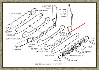

Glen could you post a picture that shows exactly where you file on the tang ?
"corner of the inside blade tang ": i am not sure where this is.
thanks, kj
Posts: 39458
Re: Hard to open Case XX
Post by jerryd6818 »
Roland, I feel fairly confident he's talking about the place identified by the arrow in the picture posted below.

glennbad
Posts: 8184
Location: NH
Post by glennbad »
jerryd6818 wrote:Roland, I feel fairly confident he's talking about the place identified by the arrow in the picture posted below.
Thank you Jerry, you got it exactly!

Good points by all. Here is another thought. Earlier this year I bought a good quality old Schrade Craftsman. It was a nail breaker and my usual remedies or pasting the joint with metal polish and opening and closing a couple of hundred times did not help. Eventually I noticed that the bottom corner of the tang was slightly bent to one side, probably when the blade was stamped out originally. That corner was binding on the liner. I wrapped everything except the tang in duct tape and used a hard Arkansas stone to remove some metal from the bent corner of the tang. That solved my problem. Here is a photo with an arrow pointing the problem area.
