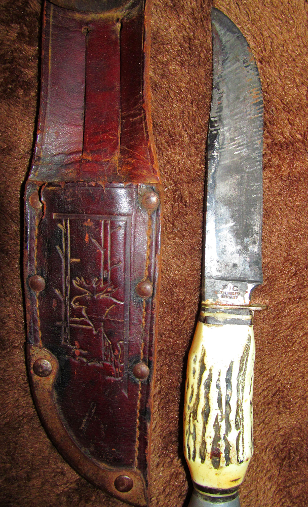

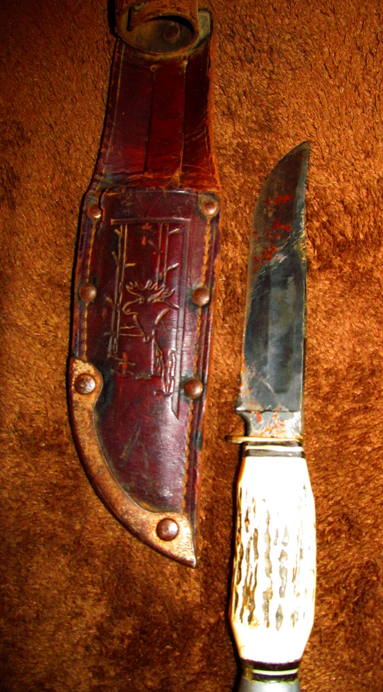

I don't think I made it worse from being in the sheath for God knows how long. My rust treatment turned it like a gun blue, but at least the solid rust is gone.

Steel wool will take the residue off from the rust remover ::nod::

I was wondering if you guys saw the German marks and if the stocks are stag. I think this was a semi valuable blade before its ruination. I will fix her up.

The pictures are not in focus so tang markings cannot be seen. Even the handle is not shown well but most likely is Stag as this is the most common handle material on older German fixed blades. I doubt it is of high value as the Stag handled German fixed blades are very common.

The tang stamp is P.I.C./SOLINGEN/GERMANY.
I don't find that listed in Goins. There were lots of knives of that style that were imported after WWII.
I believe it is Levine that mentions a number of GIs went back to Germany after the war and began importing knives to the US.
I believe Fred Mac Overland was one. Goins dates the Overland Solingen knives as circa 1951-1953.
The Overland knives look a lot the OP knife. Decent quality knives, but not particularly valuable.

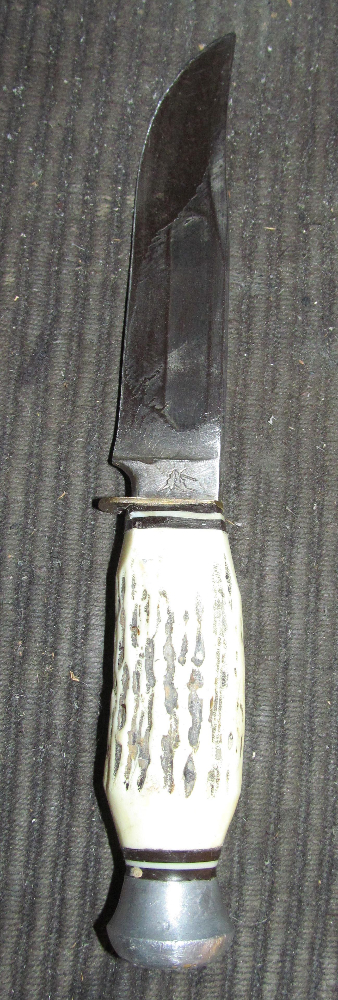

Thanks for the info, I started cleaning her up but will leave as is and make a kydex sheath for better handling and because the leather is torn in spots. Note the tang stamp, a little mountain and a pick.

I think you will find the handle is plastic, made to look like stag. Zillions of these knives around. I keep one as a fast can opener in my kitchen.

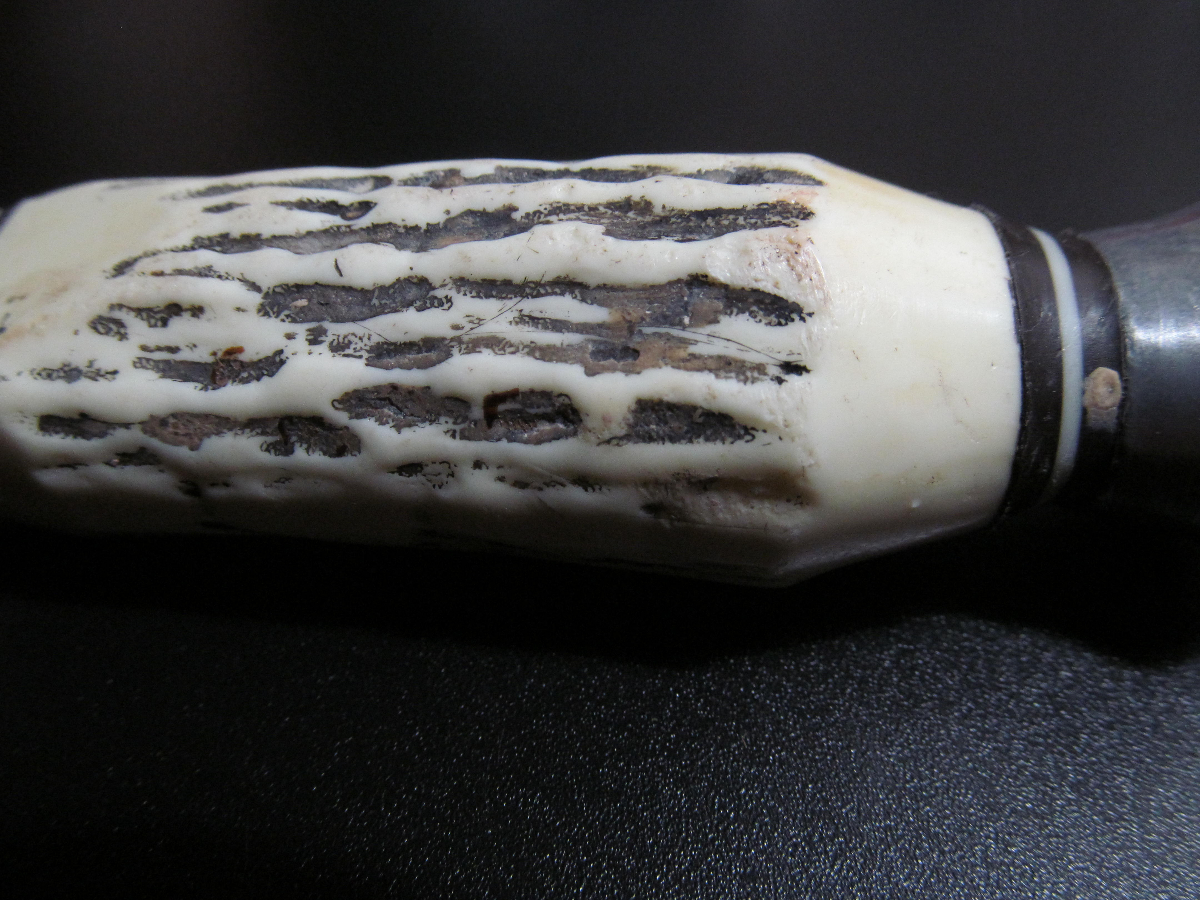

Can you post a 'real' picture of the knife handle. By "real" i mean one in focus that actually looks like the knife itself.

Hope this looks better

It's plastic.

It sure is plastic, from Precise International Corporation NY

Plastic ? i am surprised. All the P.I.C. knives i have seen have had a one piece Stag handle.

Its one piece plastic :D I heated a tiny screwdriver and touched the handle. It had a plastic smell and melted :|
