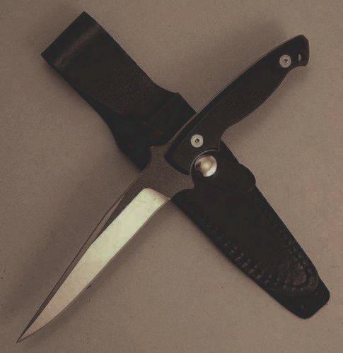

El Lobo wrote:My avatar is a "Whisper" made by knifemaker John Greco.....of 8670 ( a non "stains less" ) Steel.
John often coats the blade to aid in corrosion resistance.
It is a knife made for a particular purpose, and I have not had call to use it.
Bill
Bill....would it be possible for you to post a picture of your "Whisper"? One big enough so we might be able to see some detail? Thanks.
Dewman
"This ain't Dodge City....and you ain't Bill Hickock!"
El Lobo
Posts: 3036
Joined: Tue Dec 14, 2004 4:47 pm
Location: Arizona, right here in the U.S. of A.
Post by El Lobo »
OK then,
This is the biggest one I have right now, as I lost some insurance type pictures awhile ago, and I believe this one is from his site. I hope it works alright for showing grind lines and all. It is a fast, well balanced knife. It is differentially heat treated...soft (mid 40s) at the spine, much harder (58-59) at the edge.
It rides in my vehicle like a good old friend.
Bill

dewman
Posts: 409
Joined: Wed Jan 24, 2007 2:29 am
Location: Central Idaho
Post by dewman »
Thanks Bill. No need for more photos. I was just wanting to see the lines and so forth. Very nice blade, indeed. No need to ask what the intended purpose was/is. I'm very glad you've never had to "put it to use". ::paranoid::
