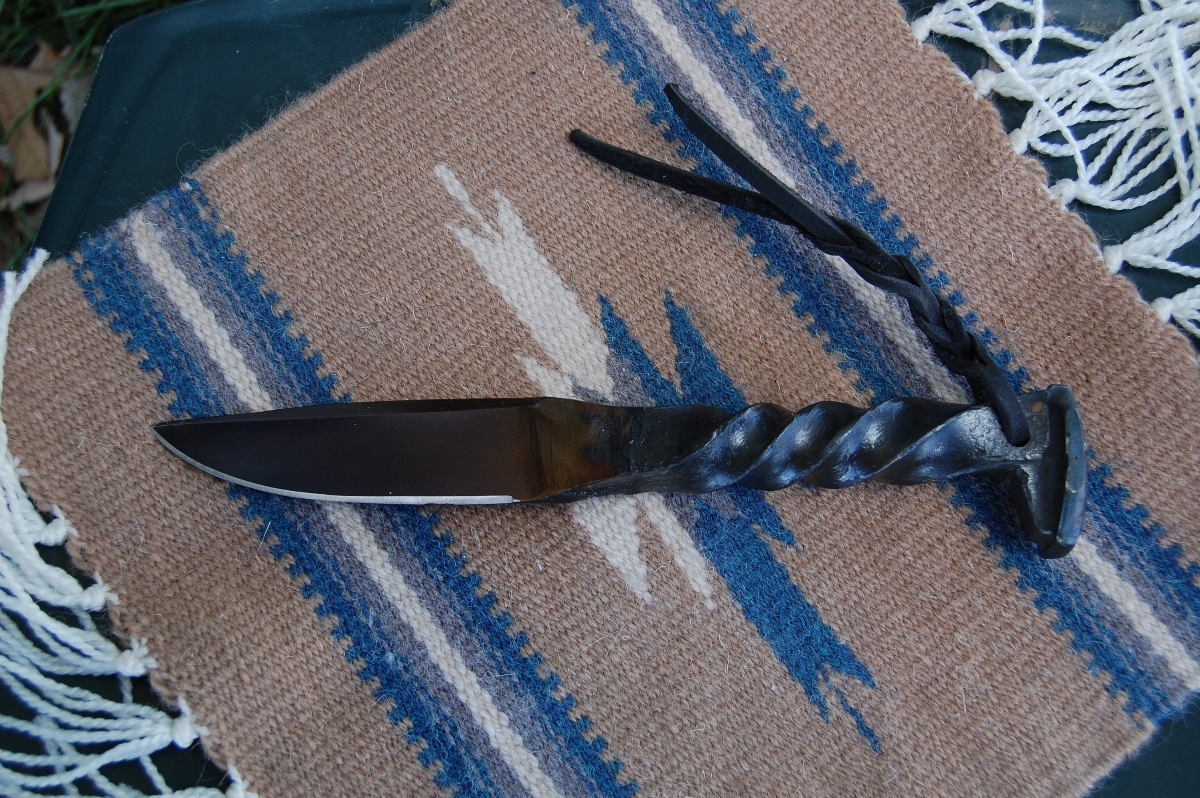

Keith, I can probably make you one but first I would need more info, like do you want a hidden tang, or a full tang, and what type of blade shape. But I need to tell you it won't be a very good using knife. railroad spikes are only made out of 1030 carbon steel (.30 percent carbon) It takes at least .7% to have a steel that will get hard enough to hold an edge. I have made a bunch of them but I just use the head of the spike for a handle and put a twist in it. I will include a photo of one I made serval years ago and I get $100 for one like it, If you want your antler on it , it would be another $50, that would include a sheath. You can contact me by email at [email protected]
