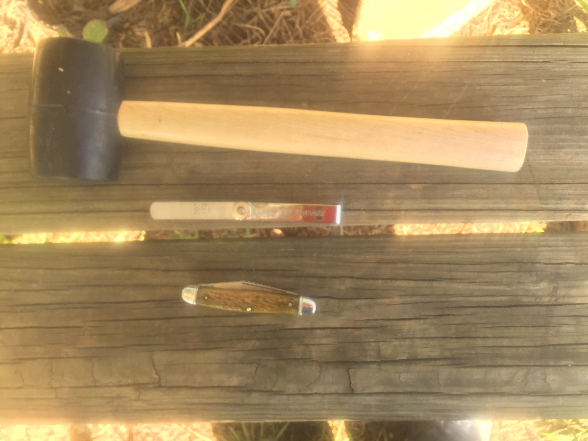

Timely subject as I just finished tightening one up. My old Wards stockman that I love, I noticed had some wobble in the clip blade. I thought I'd checked it when I bought it, but I guessed hadn't.
I took it to the picnic table, put a .007 feeler gauge between the outer liner and the blade tang, and gave it a couple licks with the rubber mallet. I like to use a feeler gauge because I've been guilty of getting them too tight in the past.
Also, I start out with light taps and increase as needed.

I don't believe the rubber mallet is a long term solution, it'll just work it's way loose again, the pin needs to be peened---and filed and buffed/ polished, if you're all anal about it. Tis why i suggested inexpensive, non-Swinden-keyed knives to practice on. DO IT! (p.s., the feeler gauge/ slackener is a good idea, one of those "lessons learned")

SteelMyHeart85420 wrote:I don't believe the rubber mallet is a long term solution, it'll just work it's way loose again, the pin needs to be peened---and filed and buffed/ polished, if you're all anal about it. Tis why i suggested inexpensive, non-Swinden-keyed knives to practice on. DO IT! (p.s., the feeler gauge/ slackener is a good idea, one of those "lessons learned")
Yeah I learned about the feeler gauge the hard way. Lol.
The mallet may not be the best, but I don't remember having one come back loose. This one may, we'll see.

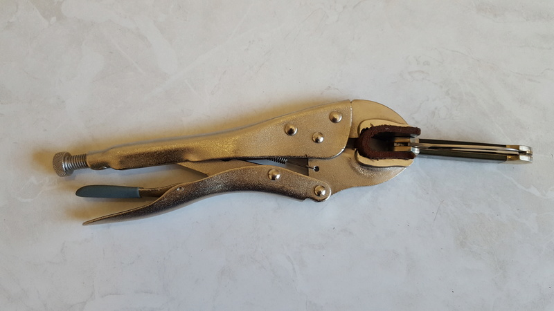

pressure pliers and leather strip. it's easy to calibrate the pressure.

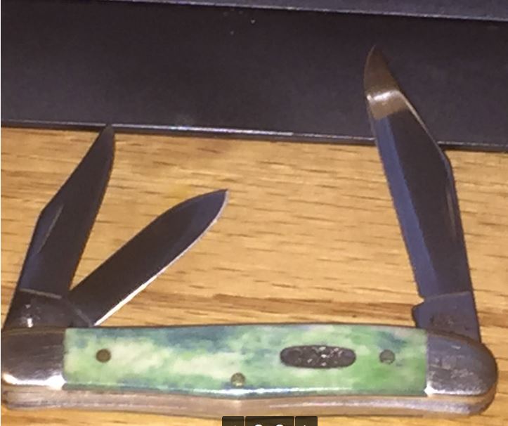

I recently found a new Case small whittler - appaloosa mottled green, really nice dress pants knife. The main blade had too much wobble right out of the box (shame on you Case, but thats another story), and usually when this happens (as I have no tolerance for wobble on a new knife), I just resell it. I like this particular one too much to do that so I figured the boys at AAPK would lead me in the right direction.
Well, after futzing with it for a while using the leather and vice method (it's a fine line between getting it too tight where it won't snap closed at all & just loose enough so it snaps somewhat with no wobble) ... I'm ok with a little less snap & zero wobble. THis is pretty cool - I will be able to "fine tune" my knifes a little better now - thanks for your advice - appreciate it !!

As a big fan of the green Case Appaloosa and a collector whose #1 pet peeve is probably blade wobble, I think you made the right decision. That's a fine-looking knife. ::tu::
I think I may need to further investigate the "leather and vice" method. It might be a little less heavy-handed :lol: than the mallet-and-towel or "peen and pray" methods I'm aware of to tighten up a loose pivot, and I've got a few nice knives in the collection that I'd really like to keep but don't get much use due to a little bit of blade play.

Use locking pliers
Tsar Bomba
Posts: 3637
Re: Side-to-Side Wobble
Post by Tsar Bomba »
rarreola wrote:Use locking pliers
Good idea on the Vise-Grips. How big a turn do you use when you reset the pliers? I would think a full turn might be a little too much, no?
rarreola
Posts: 234
Joined: Wed Dec 15, 2010 1:39 am
Post by rarreola »
Just 1/4 turn
