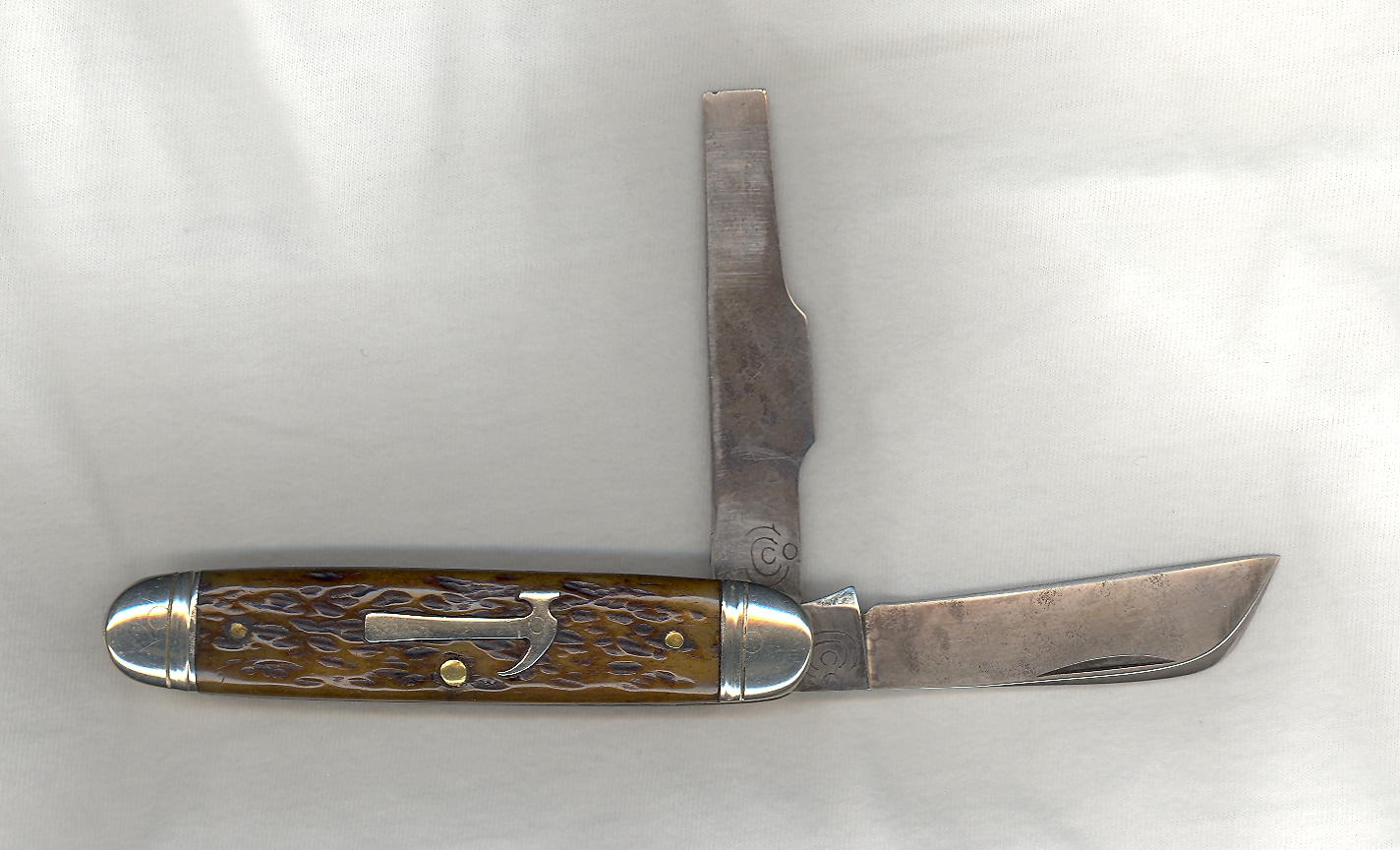

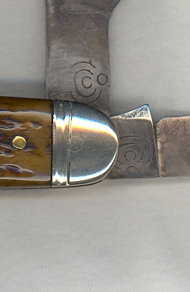

I got this knife at the Wilmington show several years ago. I thought for sometime that it was a Curtain & Clark but I no longer think so. It is a 3 5/8" jack with a claw hammer shield, a sheepfoot blade and chisel blade. Never seen it before. The tang stamp is a "co" inside of a larger "C", and both of those inside a large "C". Both blades are stamped. Any ideas???
CCCo carpenter jack_001.jpg (45.7 KiB) Viewed 2723 times

according to goins it's the canton cutlery co.

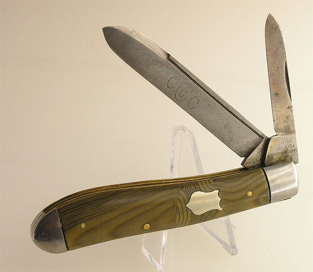

here is a curtin and clark picture i borrowed. blade etch is similar but not the same as the tang on your carpenters jack. the tang markings are straight letters. still think it's a canton.

nifbuf, I think it doesn't have enough "C"s to be a Curtin and Clark.
Curtin and Clark Cut. Co. needs 4, if you have the "Co." in there, and your tang has 3. The blade etch on the other knife has 4 though. Not definitive, but worth noting.
Canton made some odd utility knives. . . . .maybe.
