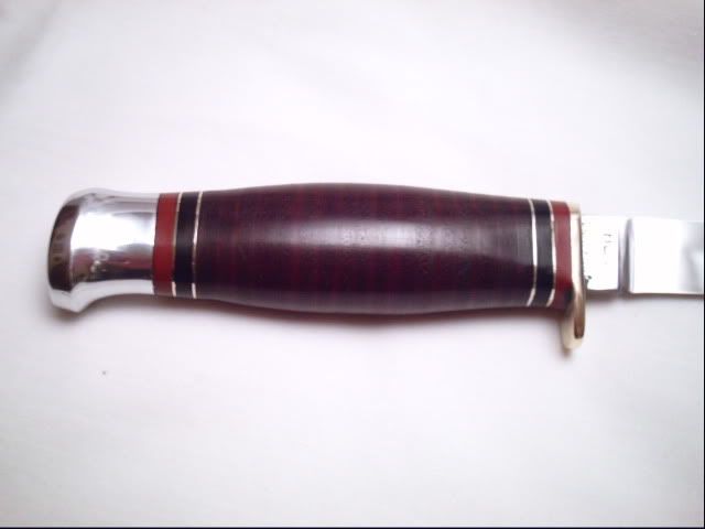

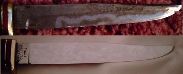

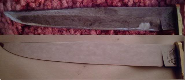

I just loooove stacked leather handle knives. I came across this one at a flea market (it's that time of the year again!) this morning for $5. It's marked "premier lifetime" and on the opposite side is marked "H20 sheffield england". The leather washers were rough, but not really dented or scratched up, just swollen unevenly. The blade had been sharpened on a grinder and was pretty screwed up, luckily it was saber ground and I had plenty to work with. I like a flat grind for a working knife anyway, so flat gridning this blade would remove all the nasties and make for a thin cutting edge. I'll let the pictures tell the rest of the story, she's fit for the field now. (that's the reflection of the texture in my light box on the blade just so ya know :) )
The crazy guy with the grinder messed the tang up and knocked the grindlines all out of whack so I had to true those up as best I could.
