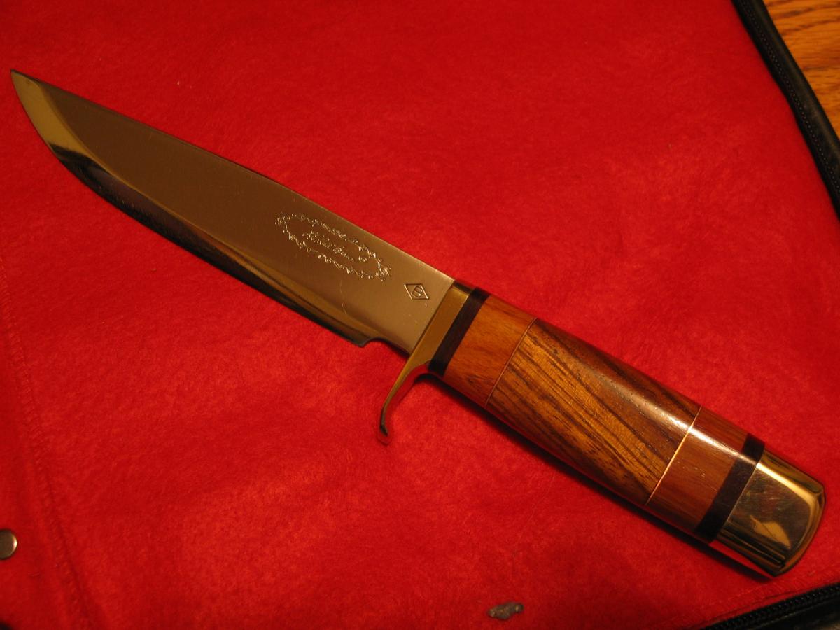

cato
Posts: 1025
Joined: Mon Dec 20, 2010 11:34 pm
Re: What is acceptable cleaning of vintage knives?
Post by cato »
how do you like me now....
gsmith7158
Posts: 8617
Post by gsmith7158 »
Bravo Cato!
First rate job. That baby has got the WOW FACTOR now.

cato
Posts: 1025
Post by cato »
Nice 3 F ,
I am with mumbleypeg, on slow and steady, most of the cleaning is knowing when to stop
and which knives to clean , i was able to get a couple of custom fixed blades, i have been working
on for awhile cleaning up, they were mainly neglected with light sharping , but my only ones
this one is the L. E. (RED) BROWN HAPPY WITH THE WAY IT IS TURNING OUT
