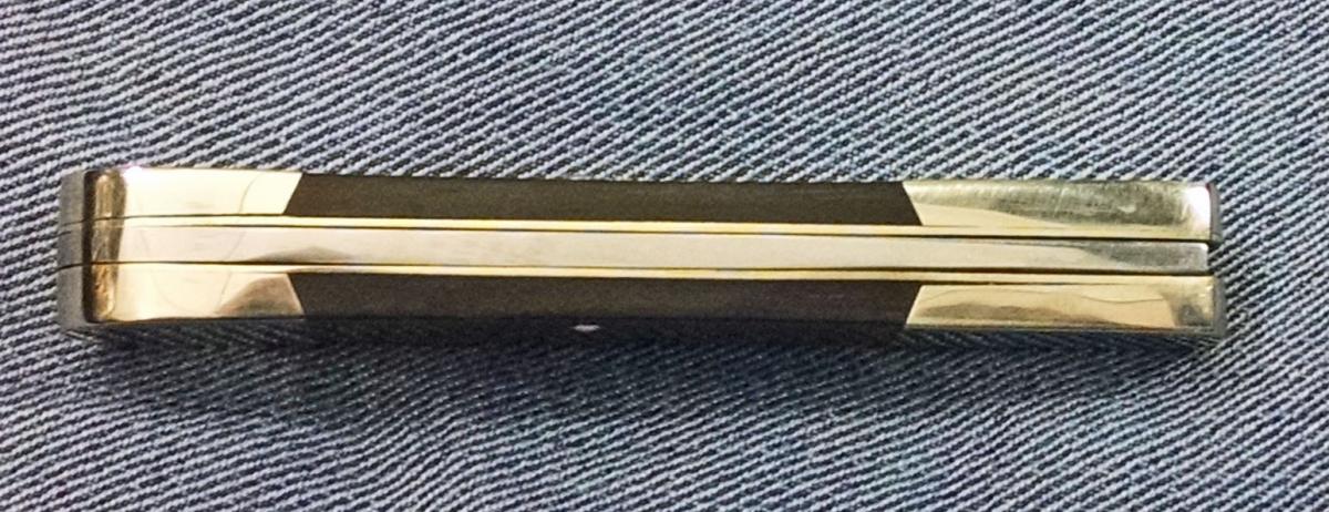

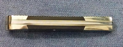

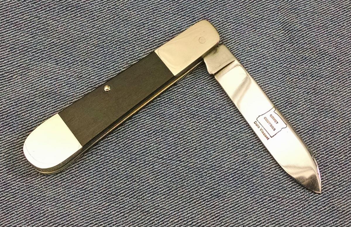

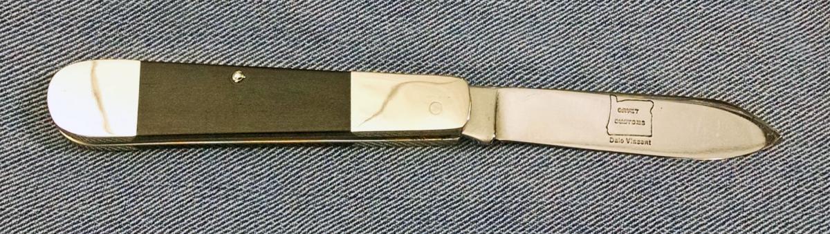

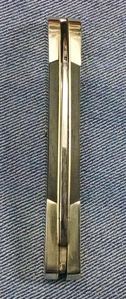

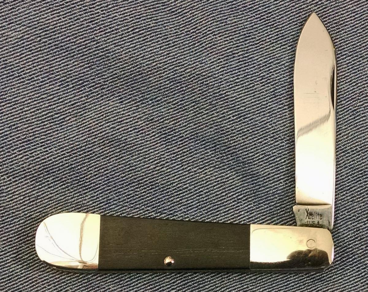

I have often said there is no more versatile knife for the knife mechanic than the TL-29.
Believe it or not this knife was made from a TL-29.
I used the blade, spring and the two outer liners of a TL-29 to make this knife, though I have not come up with a good name for it yet.
I added long bolsters, like a Barlow and added rear bolsters. I beveled the edge of the bolster so the handle material would slide under them, making handle pins unnecessary.
I used super black Madagascar ebony for the wood.
I used a new blade that came from the Camillus factory.
This knife was many years in the making. It was one of those projects that got shelved for several years and sat in a box in the shop, waiting for me to have the inspiration to finish it. Finally I had enough inspiration to visualize the way I wanted to finish it.
Let me know what you think.
