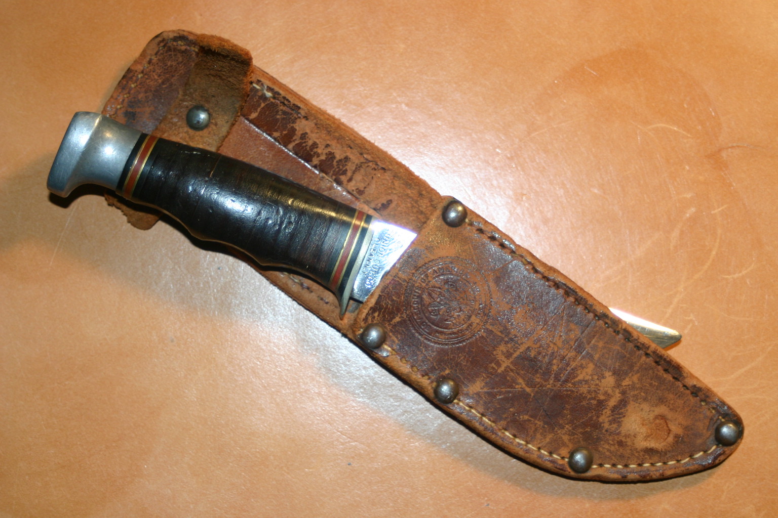

I would say that has to depend on the shape of the sheath......here's one that came with the knife. This one for sure didn't add to the value of the knife, in my opinion. I couldn't wait to get home to replace it.
Looks like they could have used one more rivet huh??
::nod::
