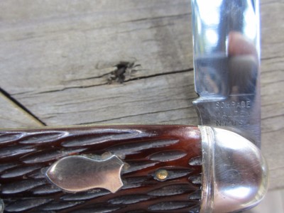

Thunk these 804's were bone handles
but this looks to be outgassing
Hope one them **edit SCHRADE whales come a swimmin by this post

SteelMyHeart85420
Re: Ima wearing Capt Ahabs' head scarf
Post by SteelMyHeart85420 »
They sure look like bone from here
Post by glennbad »
They also look like bone to me. However, the knife may have been stored next to a knife that was outgassing.
Post by djknife13 »
Are the blades tarnished or just the bolsters. It doesn't look like outgassing to me. It looks like they were stored near something damp, like in the bottom of a metal container. I'd wipe them off with some metal polish and see if it comes back. I bet it doesn't. ___Dave
Post by MrBlister »
Dave .. the blades are in great shape..
small clip and coping are like new... big clip is
scuffed up but NO tarnish or corrosion
Post by ozzie marie »
Blister,
The stamp puts it 1946-73.
The STAINLESS stamped on the reverse makes it interesting. I don't know if I ever seen that before.
Clean and polish those scales up and then lets take a look at them ::nod::
For comparison, here's an 856 with bone scales that has the same stamp.
Keith
Loyalty and Respect are not purchased and owned for a lifetime, they are earned everyday.
Please visit my store at:
http://www.allaboutpocketknives.com/ozziemarie
Posts: 39458
Post by jerryd6818 »
Dave, as everyone has said, the handles are not Celluloid. They're either bone or Delrin (would make the knife after 1965 or so). Get out your magnifying glass and look for the haversian canals (little tiny dots) on the handles. If they're there, it's bone. If they ain't, it ain't. It's almost impossible to tell the difference from a picture but the whitish stuff in the pits of the jigging sure looks like Delrin Haze (my made up name for it). If the handles turn out to be Delrin, just scrub them down with a rag with some machine oil (3-IN-One oil or similar), they'll clean right up.

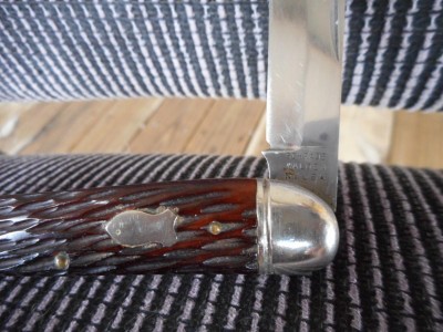

Post by MrBlister »
Welp .. here she is after a
lil rub with Semichrome..
Jerry .. theres a edge shot of the scales..
the color variation tells me it likely bone
HET yawlll
and thanks in advance
Post by tongueriver »
Your knife looks like bone to me. Schrade seeded out a few stainless blades in the 1950s but not many. They may have been received poorly by buyers (?). Here is a shot of a 1950s Schrade Walden bone muskrat with a stainless blade. The bone looks very close to the bone on your knife, Dave.
