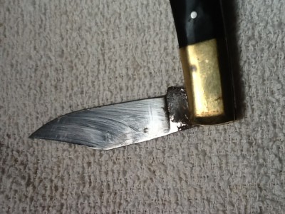

Assess the discoloration…..Try and avoid using sandpaper if at all possible to make an old knife shiny again.

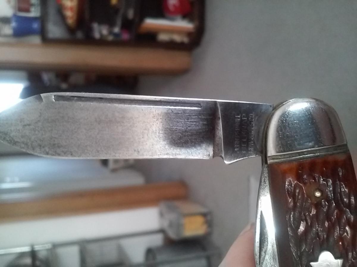

BASIC 15 MINUTE KNIFE CLEAN/POLISH
The knife originally had light rust appearing. I rubbed with fine steel wool. Touched certain areas with #2 pencil lead, then hit with steel wool, then finished with a Flitz Metal Polish rub down on the knife’s blades and bolsters.
This process leaves the patina (stained steel) pretty much intact and helps the knife maintain its “aged” look. Took me all of 15 minutes to accomplish this 3-step polishing/cleaning process.
In addition I force a rag between the liners to clean the inner parts of the knife, then add a drop of Quick Release Oil to each blade tang.
DONE. Not shiny, but restored to solid working condition. (Most knife collectors who use their knives prefer patina.)

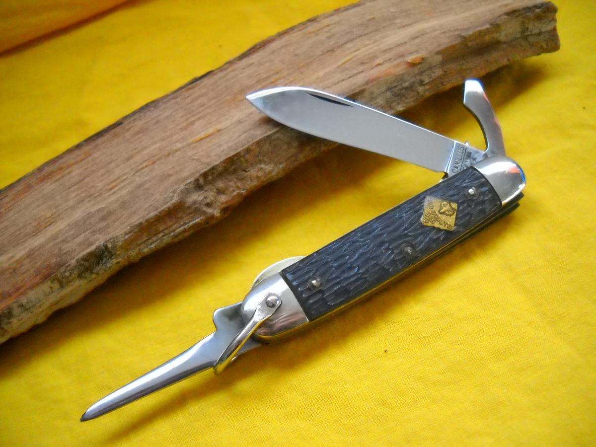

SHINY RESTORED KNIFE - HOW TO
If the knife cleaning/polishing/restoring is ok with what’s above, then read no more…...if not however, you’ll need some sandpaper (wet or dry) and Hulk loads of elbow grease to bring your vintage knife to an epic shine!

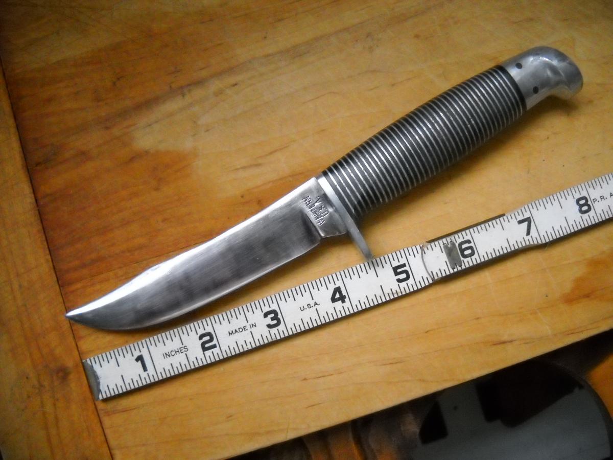

POLISHING KNIFE BLADES:
Start at heavy grit 100 and work your way up to 2500. Each time you move to another sandpaper grit try and obtain a reflection in the blade so you can see yourself…..kind of hard to do with 100 grit.
This the the ELBOW GREASE SECTION!!!
Using the sandpaper remember- Up, down. Left, Right. Mostly I go left, right strokes a few dozen times, then up/down strokes a few dozen times. What you want to try and avoid is making deep groves by stroking the knife blade ONLY left and right vigorously on the sand paper. Mix it up. Left right…...up, down. Do each way 20 times, then repeat until you're beginning to see a shine!
After you begin to see a reflection, move to the next grit. From 100 grit to 200, then to 300, 400, 600, 1000, 1500, 2000, 2500. Repeat the above sanding steps until you can see what color your eyeballs are!

FINALLY:
When polishing/restoring shine to your old vintage knife, polish with Flitz Metal Polish and a polishing cloth. Then oil your blades with mineral oil, and drop a drop of Quick Release Oil into each blade at the joint (tang/bolser area).
