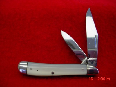

I have a couple of concerns regarding this knife on eBay (see link above) Item number: 130165357872 and would appreciate any comments. I am using Sargent's 6th Edition, page 185, with a picture of a Tested XX 9220 cracked ice w/long pull, and my personal XX 9220 im. pearl (pictured below) as references.
1. Both Sargent's Tested XX and my XX have the clip blade up front when the knife is opened to the right. The eBay knife has the clip blade farthest away.
2. Both Sargent's Tested XX and my XX have the nail pulls on the clip blade and pen blade facing opposite ends. The eBay knife has the nail pulls on both blades facing the same direction.
3. Both Sargent's Tested XX and my XX have smaller pins holding the handles vs. the larger pin holding the spring. The eBay knife has all large pins. Also my XX has NS, not brass pins.
4. Both Sargent's Tested XX and my XX have a round, almost egg shaped bolster where the blades are pinned. The eBay knife has a square bolster.
5. This bolster/end pin is visible on the eBay knife.
Thanks for any comments. Also additional photos for my XX can be seen at: http://stethem.net/case9220.aspx

looks like a kutmastyer vthat was retanged
