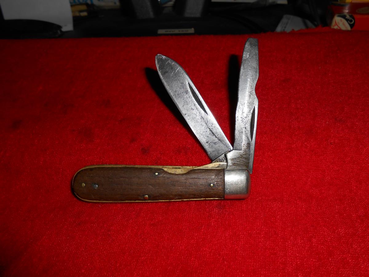

old case electrician's knife restore

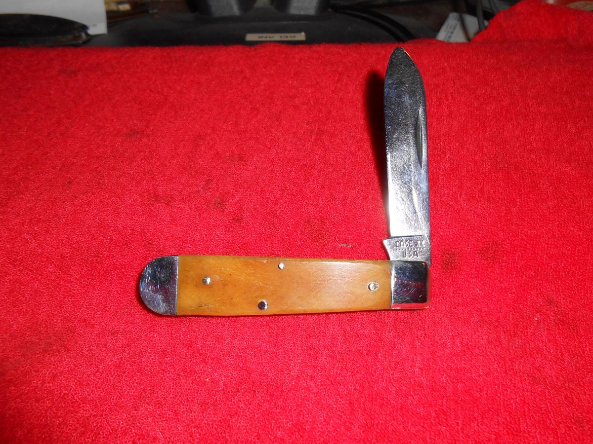

Re: old case electrician's knife restore
nice job, got that 2OT look going on
Nice job.
Be careful, customizing knives is far more addictive than collecting them!

thanks. how would I go about putting a case shield on the handle
