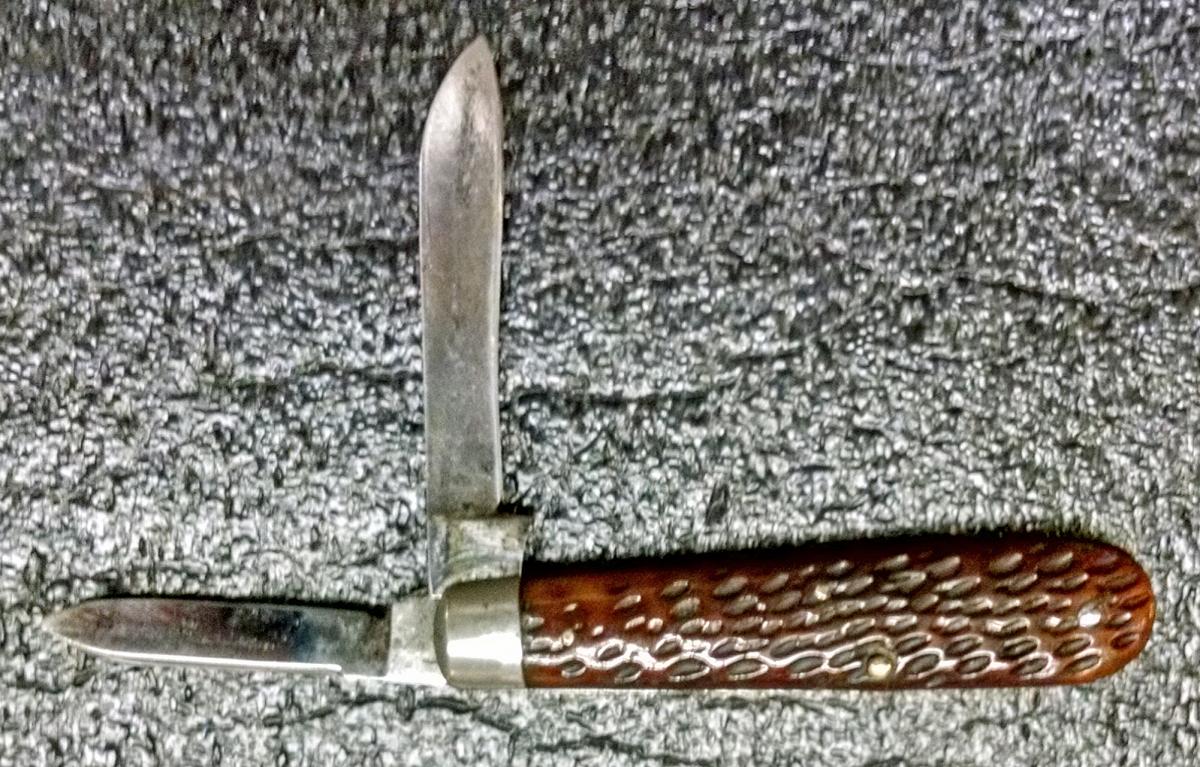

I saw this old Wallkill jack on ebay and had to give this one a try, it was just too nice to let it go for under $20.
Here is the seller's picture-

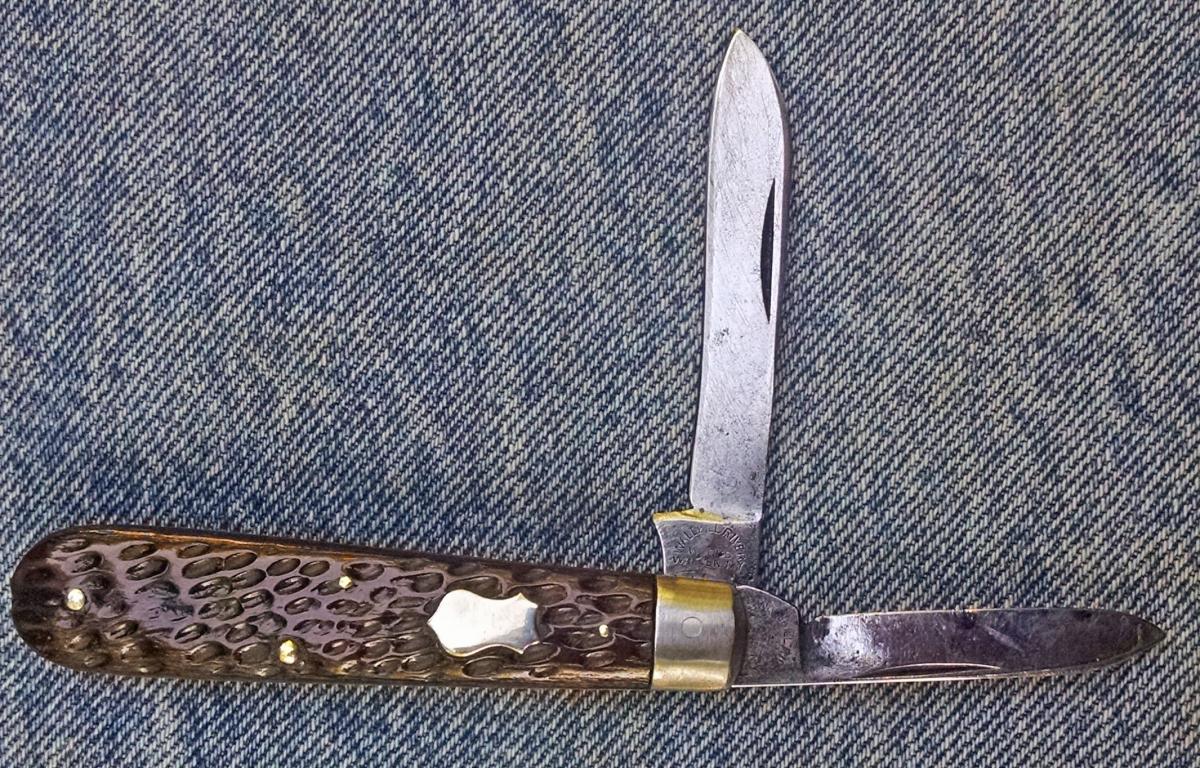

Here is what it looked like on my work bench-
There was a deep crack between the bare end and the rear pin. I could see the liner through the crack if I held the handle just right. The crack extended up to the shield.

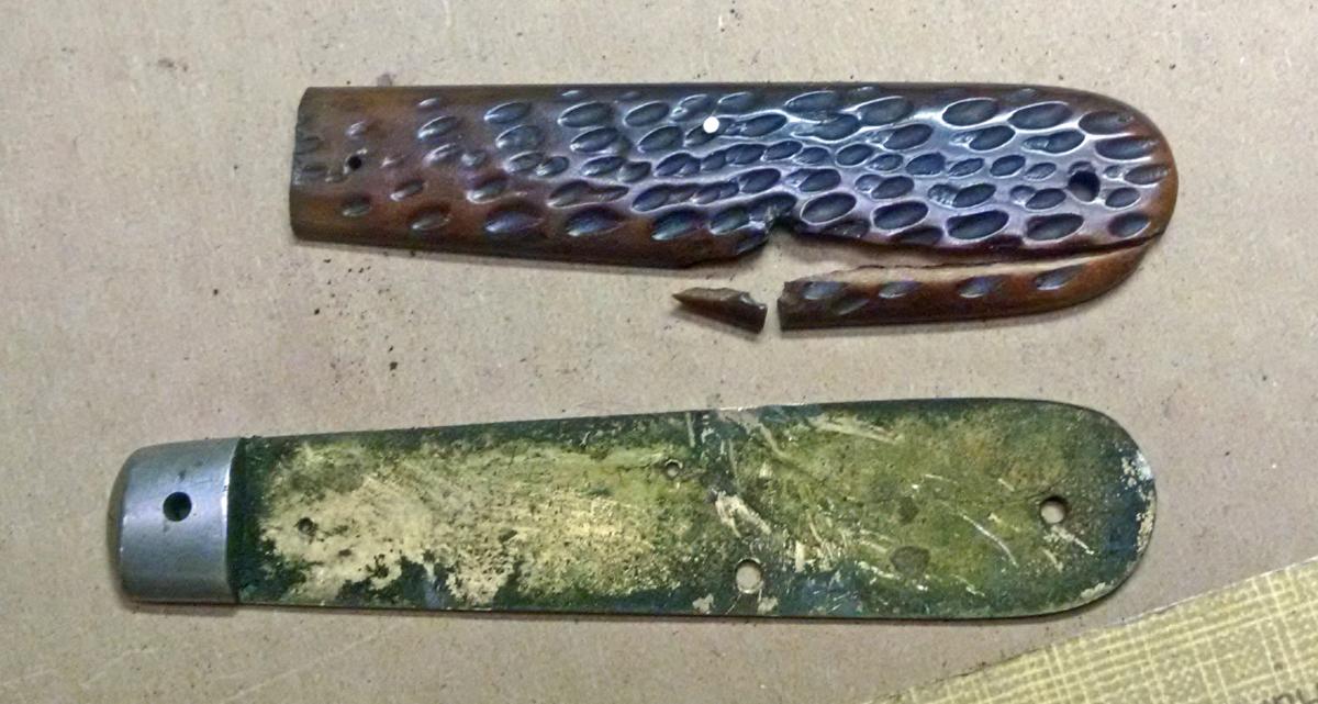

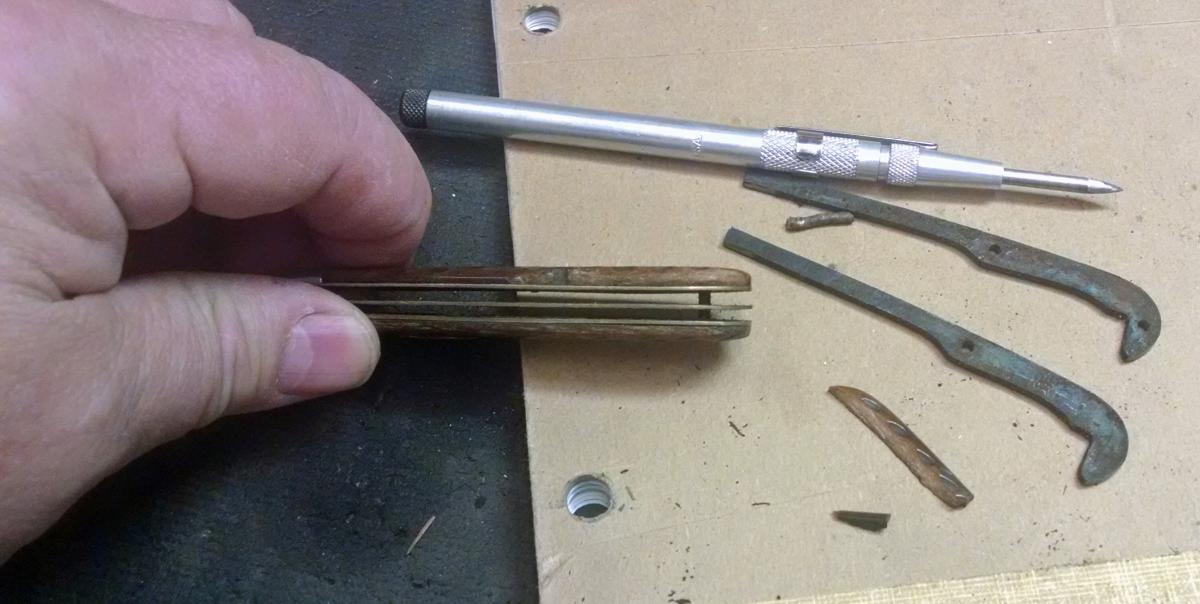

The bone was obviously too fragile to open the knife with a razor blade as the stress on the pins would no doubt shatter the old bone handles. I drilled the rocker pin then attempted to knock the pin out with a snap punch. What I was afraid of happened; there was already a crack in the pile handle at the rocker pin and the stress broke out a small piece at the pin.
I gathered up the pieces and cleaned them with alcohol and then later I epoxied them onto the liner.
Since the springs were free floating on the bare end they fell out when the rocker pin was removed.

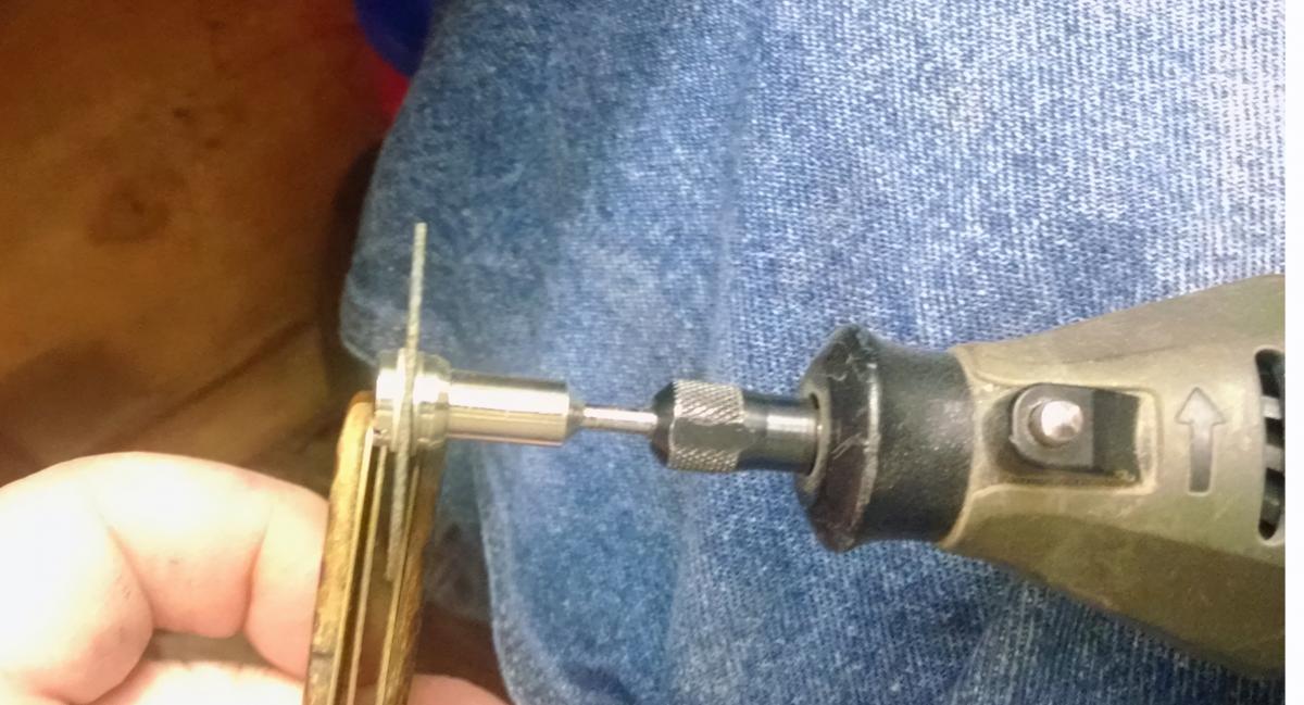

I had to cut the rear pins with an abrasive wheel on a Dremel so I did not further stress the fragile bone.

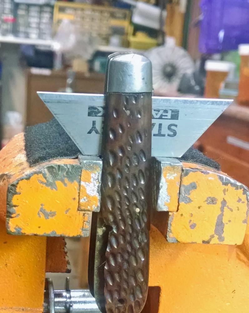

Since the bolsters would take the stress caused by cutting the pivot pin I was able to cut it with the razor blade method.

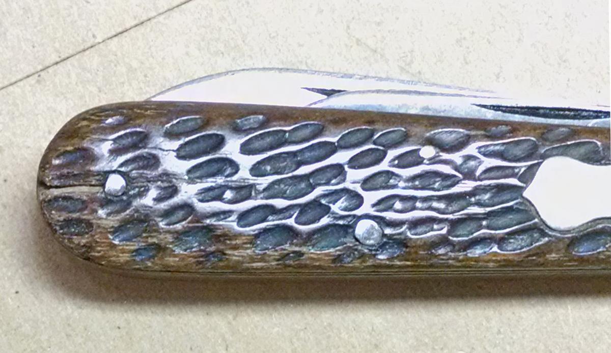

I was able to remove the mark side handle intact and washed under it with Burchwood Casey Gun Scrubber and then alcohol. That left it clean enough to use Zap-A-Gap thin and then the Zap medium CA adhesives to fill in the crack in the mark side handle. It took probably a couple dozen or more thin coats to full the gap.
The pile side handle was a bit easier, since the bone was off I was able to clean it better and scuff up the liner so the epoxy would stick. After the epoxy dried I filled in the remaining gap with Zap.

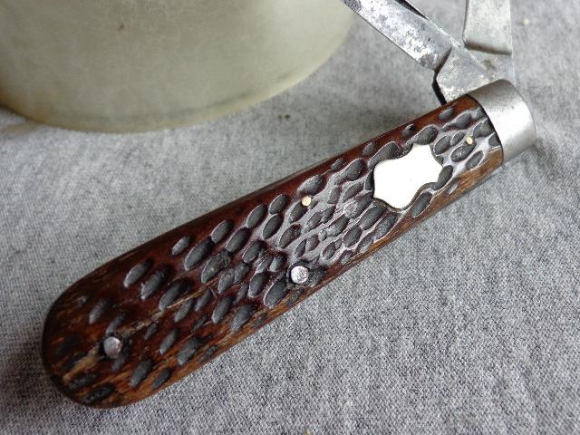

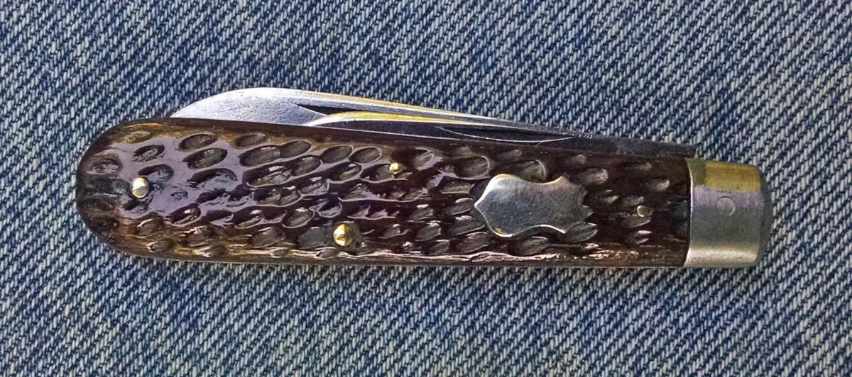

Here are the after pictures-

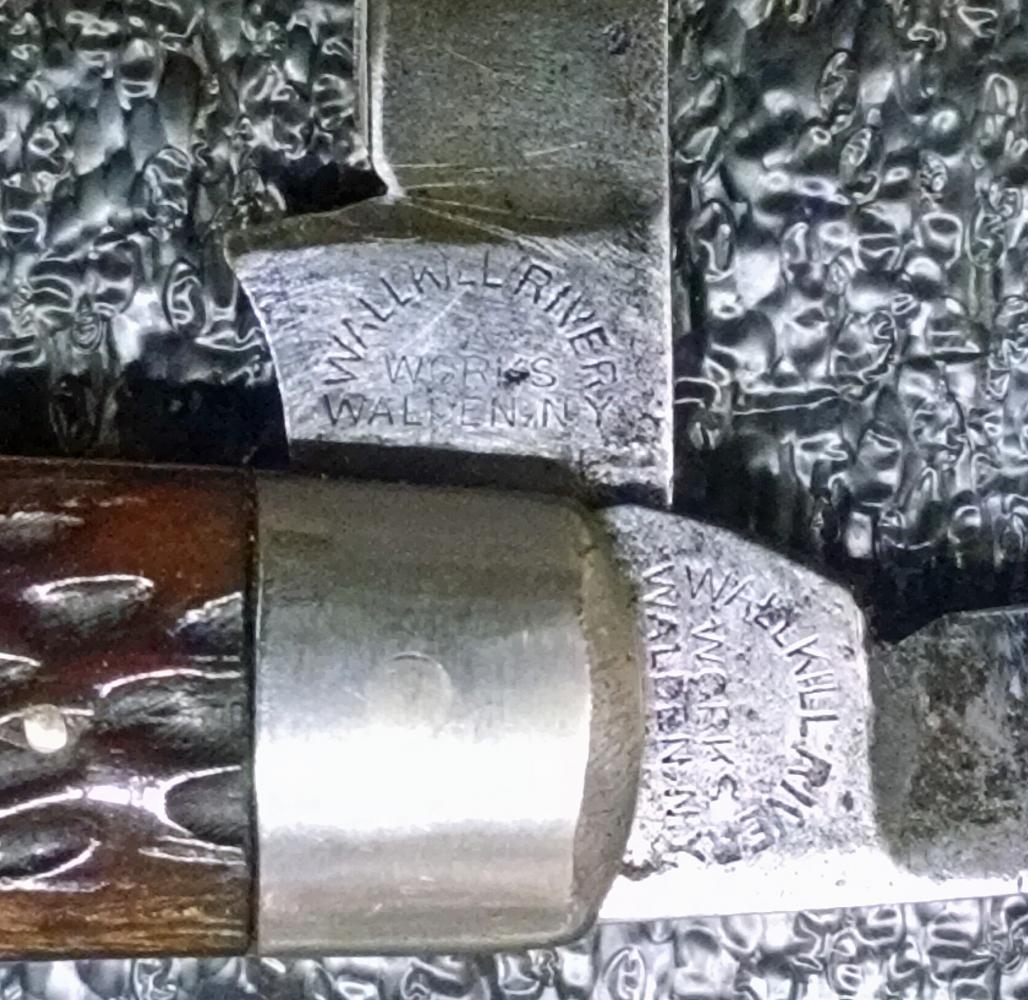

The Wallkill brand was a brand of New York Knife Co. The Wallkill & Wallkill River Works brands were like Camco was to Camillus, it was their economy line, not quite as nice and fancy as the NYK Hammer Brand.
Goins dates the Wallkill stamps as being used circa 1920 to 1931 when NYK closed.
