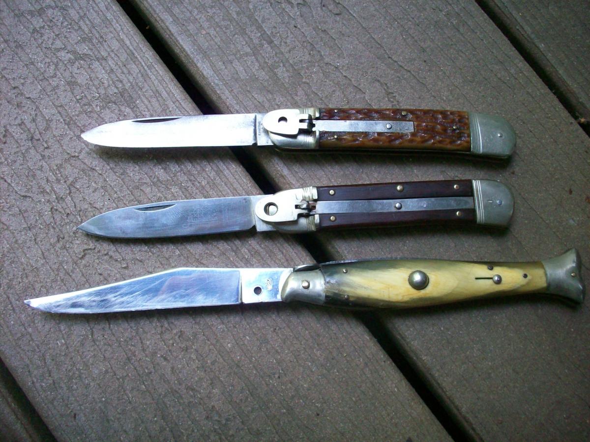

Thanks guys. I'll dig the bone one out of my safe clean and oil it and then prop it up next to my wood one I just got and get a picture. ____Dave

Pictures of my "lubricated" autos. Wood one I just bought marked Hubertus, bone marked E. Christians, and horn fishtail marked B.V.& F.
