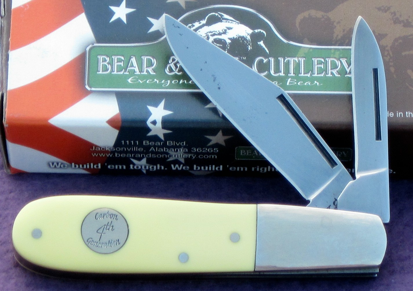

If you are asking if any would be good to use to whittle with I would say probably not.I'm new to whittling to so all I can give you is what I have learned so fair.Git a good knife to use,don't go cheap on it.You need a small blade,the smaller the better but the knife handles needs to be large enough to hold and use for long periods of time.I have never got a knife just for whittling butt I do plain on getting a nice Flexcut soon.If I was going for a new pocket knife for whittling I would look at a Bear&son "carbon steel"for the price.You can find them for about $25.00 new.But again if I was to buy a knife just for whittling it would probably be a knife made just for that IE"a Flexcut"Just my opinion.

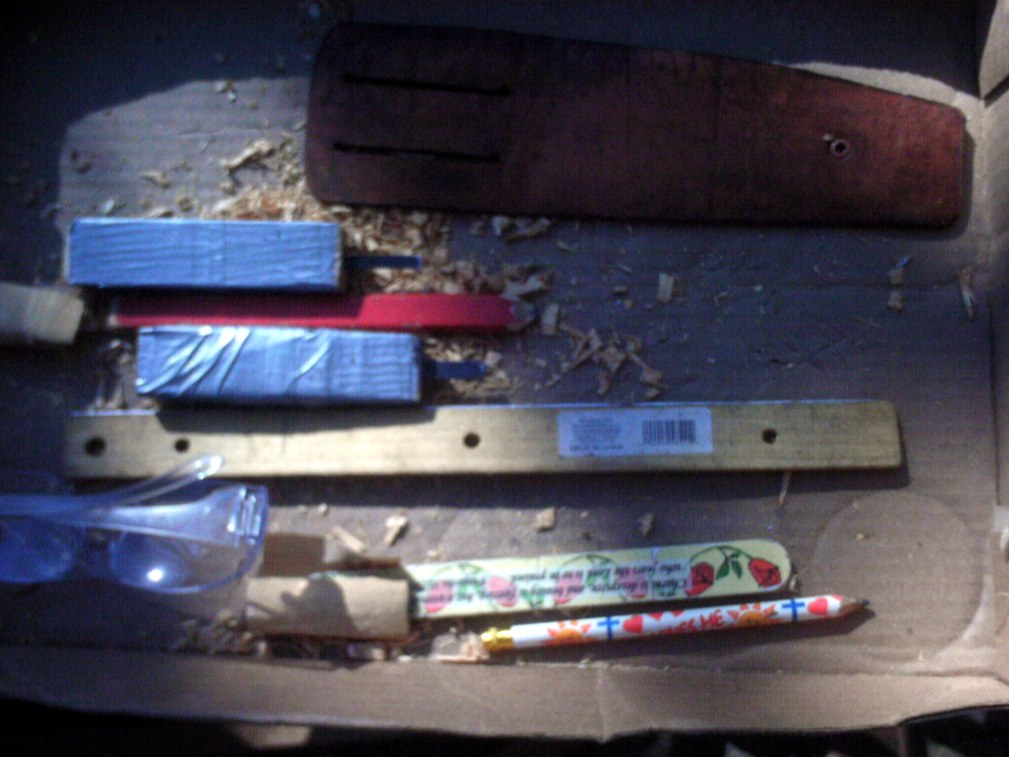

I'll show you what I use right now.Take a good look at the last pic I have posted,it has 2 tools I made that will make your job of whittling so much easier and cleaner.If you need any more help with the tools I spoke of let me know and I'll git some good pics and directions for you to make your own.Good luck and keep whittling.Phillip
