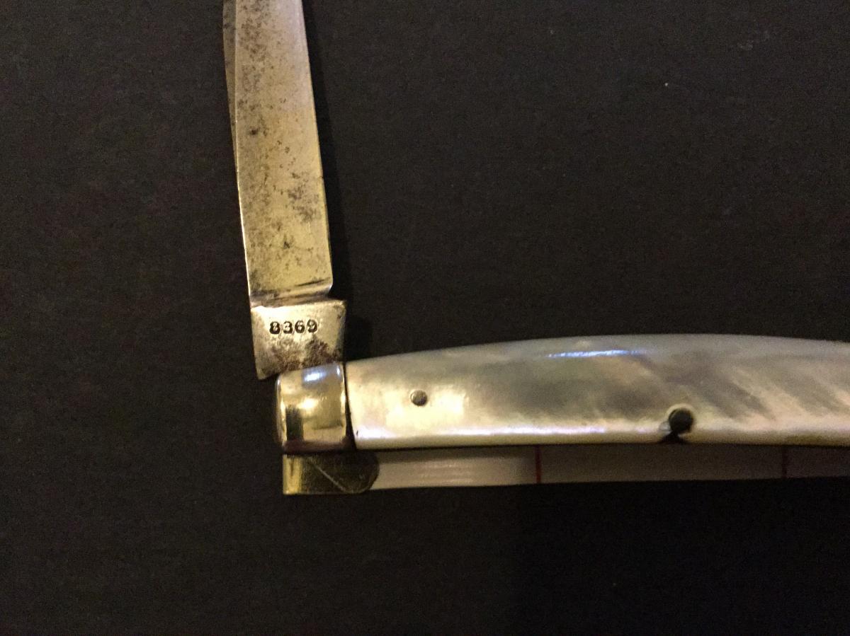

Case 8369
SamM
Posts: 65
Joined: Sun Mar 01, 2015 1:09 am
Location: Northern Nevada
Case 8369
Post by SamM »
Trying to find more info on this Case 8369. The smaller blade and file have 'Case XX Tested' in a circle which places it in the 1914-1920 range according to the Case website. The main blade is stamped 'Case Bradford PA' with Bradford below Case and PA below Bradford and 8369 on the reverse tang. I tried getting enough detail to have it show in the picture, but I wasn't able to. In any case, that stamp puts it in the 1905-1920 range. The case website doesn't return anything for '8369' and the web has failed me. :(
The knife has some condition issues, the MOP is cracked in two places on one side but all in all, the blades are in good condition for it's age and walk and talk quite well and the bolsters are striking.
Any information at all would be greatly appreciated!

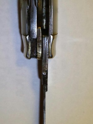

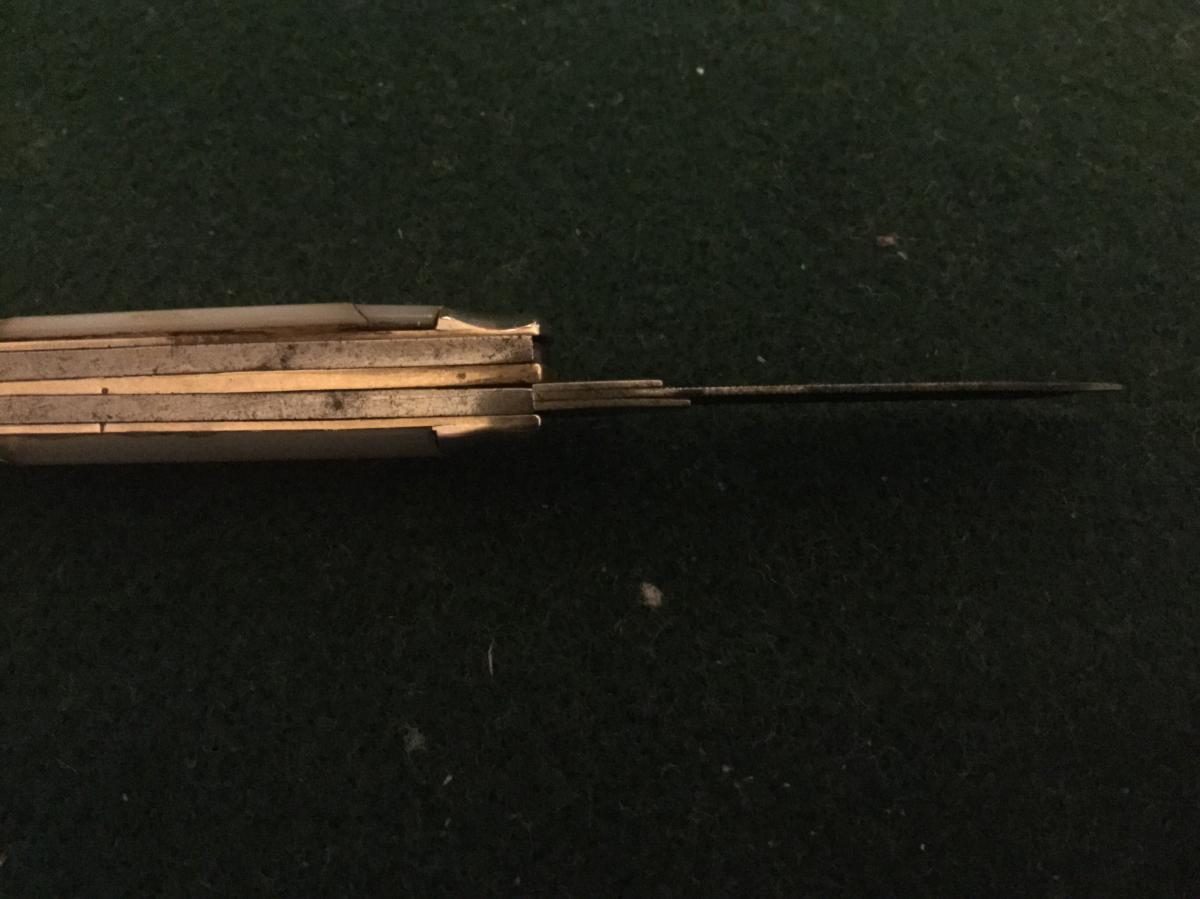

SamM
Posts: 65
Re: Case 8369
Post by SamM »
Hopefully these are better pics of the file construction. You'll notice the tang is higher on one side than the other.
United States Army Veteran
Jan 1987 - Aug 2009
Mumbleypeg
Posts: 14595
Location: Republic of Texas
Re: Case 8369
Post by Mumbleypeg »
Most interesting construction. Any thoughts on why Case made the file blade in this manner?
SamM
Posts: 65
Re: Case 8369
Post by SamM »
Is it possible Case had leftover files from a different pattern and they used shims to adapt it to this one?
The file is kept in place by the pin and a small weld. Of course, I don't think it would be prudent to take it apart, but it would be interesting to see if the file had a stamp under the tang.

msteele6
Posts: 2000
Joined: Tue Jun 19, 2007 8:29 pm
Location: Houston, TX
Re: Case 8369
Post by msteele6 »
Do you notice any appreciable difference in the way the file opens and closes as compared to the way the other blades feel? Does it snap open and closed like the other blades? Does it have extra wiggle when open?How about the position of the spring that the file rides on, is it way up or down in the open half-stop or closed position? How about the patina on the file as opposed to the backspring and the other blades, any appreciable difference?
Does anything make you suspicious that the file is a replacement? The reason I ask is that I personally have never seen a file constructed in this manner, however, my experience in Case knives (or any other) of this age is limited to a relatively few examples. Also, it would be wise to carefully examine the stamping on the file to search for any abnormalities.
If Case obtained their files from another source (or even if they made their own but made them in a standard thickness), they might have to make some modification to make them fit, however, this doesn't seem to me to be the easiest modification, the only other multi-piece files that I have seen are two pieces, not three.
It would be informative for any collectors out there to weigh in if they have any comparable (or anti-comparable, if that's a word) examples.
SamM
Posts: 65
Re: Case 8369
Post by SamM »
msteele6 wrote:Do you notice any appreciable difference in the way the file opens and closes as compared to the way the other blades feel? Does it snap open and closed like the other blades? Does it have extra wiggle when open?How about the position of the spring that the file rides on, is it way up or down in the open half-stop or closed position? How about the patina on the file as opposed to the backspring and the other blades, any appreciable difference?
The file has the same snap as the small pen blade opposite it. The half-stop feels identical on both (light) . None of the blades have any wobble. The file spring is flush when closed, exactly as the pen spring is. The file spring is ever-so-slightly recessed when the file is out. The unserrated tip of the file matches the patina of the other blades, the file itself is a uniform dark gray/black.
If the file had been shimmed on only one side, it would contact either the liner or the main blade, or at least have very little margin for error.
The file shim has the circled Case stamp, I would think it would be quite a challenge to create two shims to bookend the file so it functioned correctly.
The shims are so well matched to the file shape at first I didn't realize I was looking at three pieces.

Mumbleypeg
Posts: 14595
Re: Case 8369
Just my opinion but I believe the knife was made that way at the factory. The question is, why? And if Case made it that way, as many Tested or earlier knives Case made with file blades, surely someone has seen one like this before. To get exposure to a broader audience than those of us who regularly read the Case Collectors forum, maybe you should post the pictures and question regarding the file blade construction in the Knife Related Q&A forum.
msteele6
Posts: 2000
Re: Case 8369
Post by msteele6 »
M'peg,
That is an excellent suggestion. The only thing I can think of is that Case bought the file from another source (file making is, as I understand it, a fairly specialized skill) and that the thickness had to be adjusted to fit.
As you say, this can't be the only example, if it is original.

knifeaholic
Posts: 5329
Re: Case 8369
Post by knifeaholic »
It was common for Case file blades, even into the XX era, to be made in two pieces, the "shim" piece at the tang with the long file blade pinned on to the tang piece. I do not have an example in hand to look at. If you have my book see page 33 for the 6279 F SS pattern, its hard to see it though.
Mumbleypeg
Posts: 14595
Re: Case 8369
Steve, thanks for the info. Any thoughts as to what the reason was for doing it that way, as opposed to a one piece blade?

knifeaholic
Posts: 5329
Re: Case 8369
Mumbleypeg wrote:Steve, thanks for the info. Any thoughts as to what the reason was for doing it that way, as opposed to a one piece blade?
Ken;
I can speculate on a few reasons.
The file blade is a different animal as compared to a cutting blade, requiring a different manufacturing process. It may be that the tang needed to be stamped and heat treated as a separate piece like a regular blade, then have the file attached to it since it would not be feasible to make the blade as one piece.
Especially since the long files on the older knives were intended to be flexible files so that they performed better as nail files.
Mumbleypeg
Posts: 14595
Re: Case 8369
Thanks Steve. Makes sense. A similar thought occurred to me but I discounted it. In Case's current manufacturing process, after tempering the blades they re-heat just the tang portion of the blade to "de-temper" it. This gives the tang the same hardness as the backspring, thus preventing excessive wear that would result from two metals of differing hardness rubbing against one another. Initial thought was perhaps due to hardness of the file blade metal they used the two piece method on the file blades to accomplish the same thing. Decided if they could accomplish it by re-heating the tang, why bother with a welded two-piece blade? ::dang::
