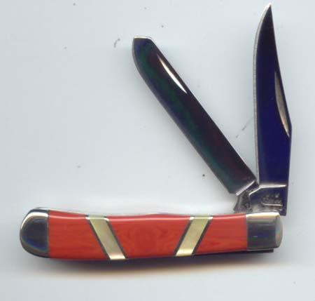

I think MITCH posted one in the Trapper thread. It looked like this.....

Most Spiny Oyster I've seen is available as Reconstituted Stone slabs and blocks. I usually buy them custom cut at 1/8 or 3/16 inches thick. These different Spiny Oysters include Purple, Yellow, Orange, or Red Orange spiny oyster and is usually 14% polymer and 86% shell. Many of these species don't get very big and if they do, $$$$!
It's pretty easy to work with, just don't go to fast, a divot may appear. :shock:
