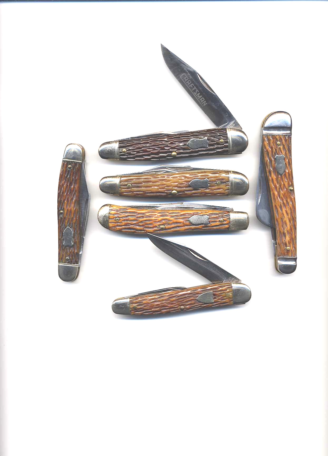

LT, Thanks to you! This is good information. I could not find this in my books, it might be there I don't know. I always try to do my own research before asking for help but I was at a dead end on this. I have copied the information and put it with my knife books. I have several of the USA Waldens in peach seed bone and some in the NY stamping also some Cut Co. knives. Again Thanks for sharing you knowledge.
