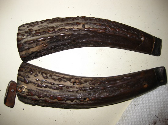

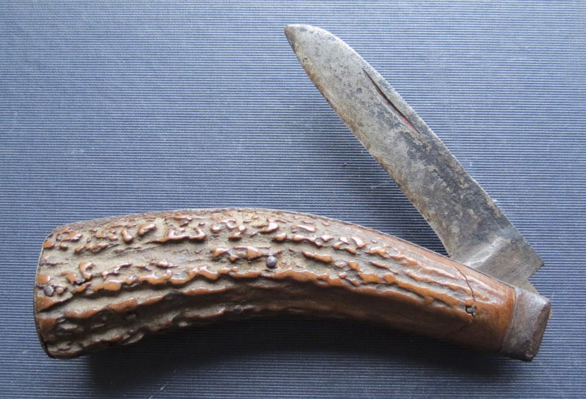

One step at a time. I can now clean a knife. Now I want to disassemble a knife starting with removing the scales. The stag scales are good, sort of and the rest history. The pruner knife has a butt plate too so want to understand how that is connected to the frame (spring).
Do you tap the pins through?
Do you drill the pins out?
I want to preserve the stag so the least trauma the better please.
Gary

I'm not sure why you would want to disassemble this fine old knife. Removing the old scales would really serve no purpose other than maybe to remove rust from under them;assuming it has iron liners.
Removing any scales usually involves a certain amount of risk in damging them either by breaking or cracking.The only pins that go completely through the knife are the blade pivot pin;the rearmost pin and the spring pivot pin at the center top of the handle.The scale pins only go through to the liners.
Drilling them out is a chancey proposition as centering the drill on such a small item is difficult at best.Trying to center punch them usually results in a cracked scale when the punch slips or too much force is applied to the opposite side scale.Making sure that the drill takes out only the pin and not the surrounding material is a real crapshoot as a lot of the pins bend when being hammered in so they are not totally vertical.
The butt plate is likely attached to the back spring via hidden rivets. If I just had to take this knife apart I would probably drill out the rearmost rivet(it is relatively large and probably the straightest)and swing out the scales to access the inside for cleaning.Not sure if this procedure would work on a knife with a butt plate but it is worth a try.
Conversely if you are looking to replace the blade;I would drill out the pivot rivet only.You probably won't be able to swing the sides out due to the butt plate but it is one solution. Just my opinion.

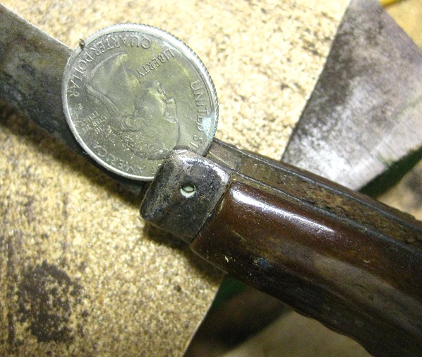

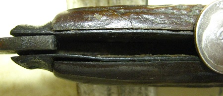

A few more condition pics.

Personally I would not take the stag off that knife. Old stag can be very brittle and I have had it crumble on me even when I removed it ever so carefully!
I would use Zap-A-Gap on the cracks and re-pin the blade if that is the gap between the blade & liner you are showing with the quarter.

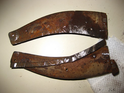

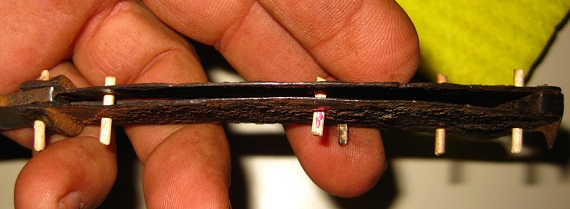

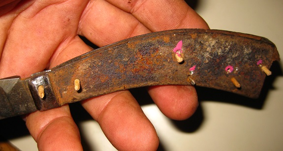

I drilled out the pins. Peeled the butt plate off (totally sep unit held by two pins). Left the liners on the stag and sawed the spring out giving me two pieces.
Then I pulled the stubs (snags) of the pins that were exposed. Scales never knew what hit them. I will now repair the stag and build a new frame.
Have not decided about blade.
Gary

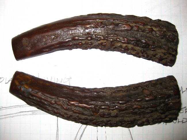

Super glue and stabilize scales.

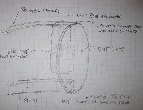

draw picture of butt plate connection and parts for future use.
secure liners, bolsters, blade and butt plate together for future ref.
pink marks are my bad...drill throughs from pin attack.

I like your drawing. Once I get a knife disassembled, if it's one I haven't done before I usually make a drawing of it by tracing the parts onto graph paper and make notes of the pin sizes so I get it repaired with the proper size pin. It's just easier to me to measure the old pins when I take it apart then to dig through the parts and try to figure out which pin went where and measure it then.
I have a whole notebook of drawings and notes. It's especially helpful for some knives that have unique features about them. I also have full-size drawings of certain critical parts I often have to make. Just makes it easier for me in the long run. Maybe I'm just lazy. :lol:

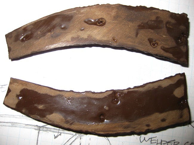

Thanks men, I thought it was going to be interesting to see how an old knife was put together.

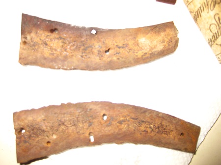

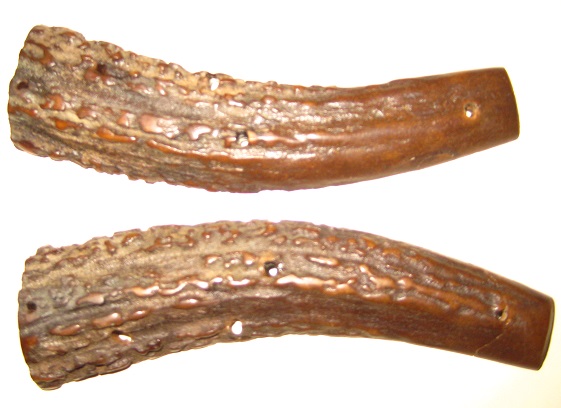

Next I dyed some JB weld to fill depressions and level the stag scales.
Sanded on flat surface and still not completely flat but close.
I feel the scales are much stronger now and repairs do not show too bad.
Pin holes will need to be re-drilled to match rod material.
Gary

I had 3 options
Local epoxy company Fasco products
West Marine Epoxy
JB weld
I added allot over rec % amount of color agent to the epoxy. Some dried and some took their time but dried.
I was looking for a color match so the grey JB with dye came right in color wise and dried on schedule.
West marine is clear and too liquid.
Fasco product didn't dry on time. Took 48 hours to harden. Had me scared.
The JB bond is good and I can sand it. Color dye test dried true to wet mix so I went with good old JB.
Had good body too.
Gary
