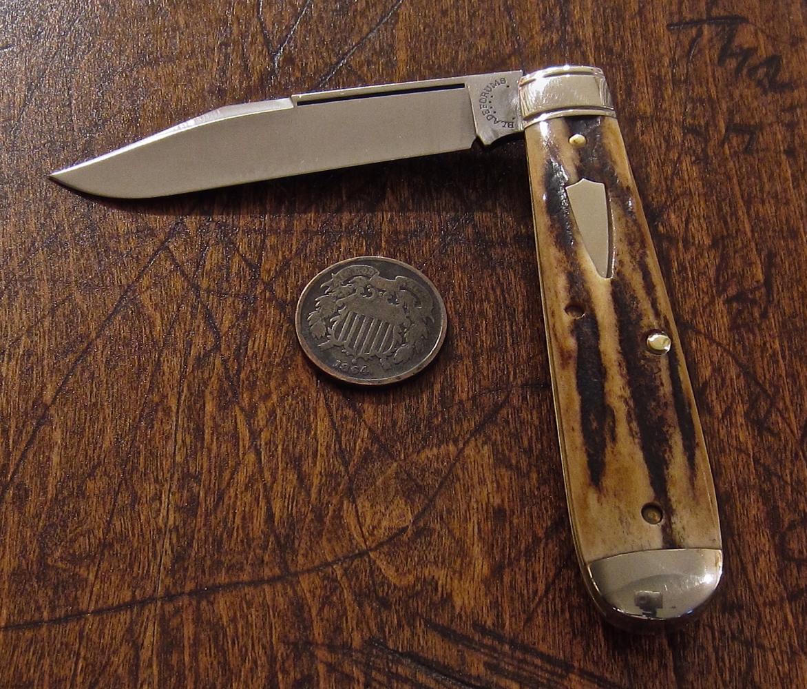

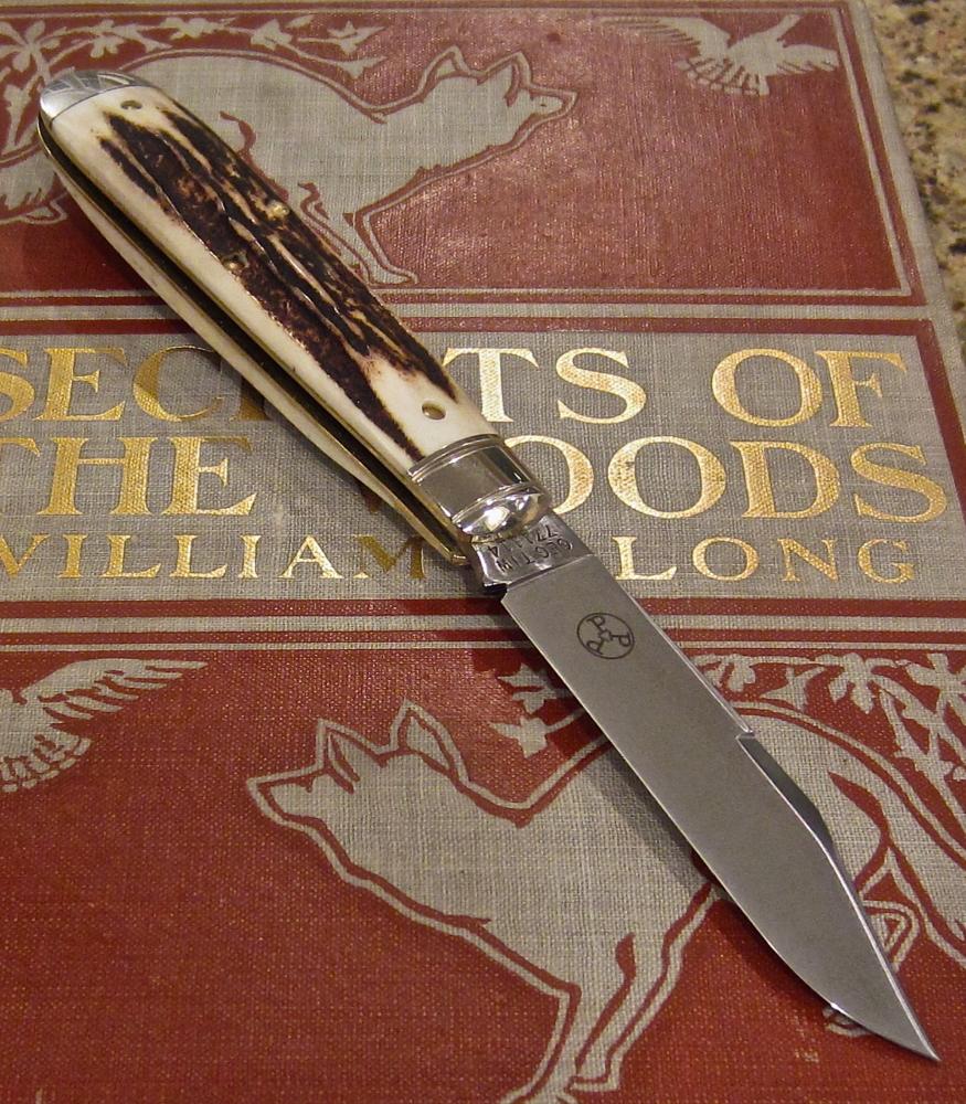

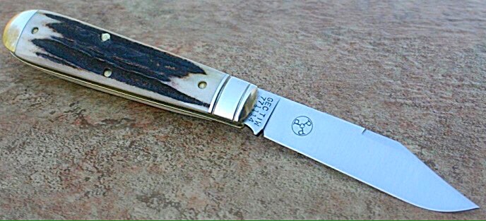

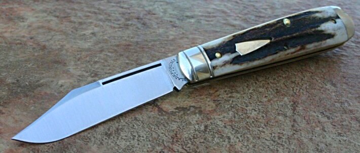

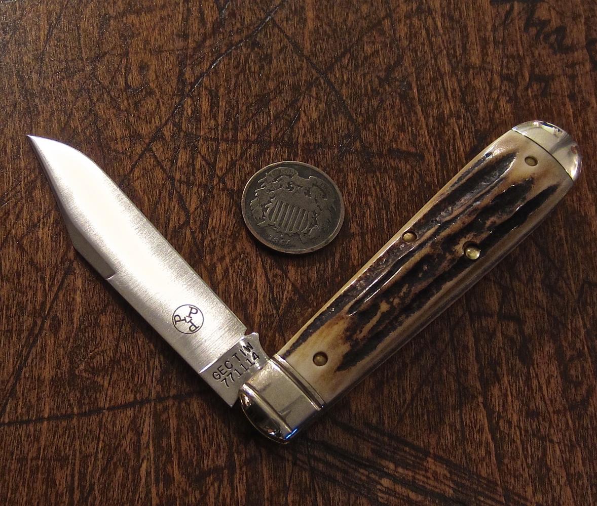

Well I did this little job over the last couple weeks, when I had time. I'm going to show several pictures, the first two shots are when I received the knife. As you can see, the knife came with too much black area and way too much white as well. Then the third pic is after me sanding the handle a bit to show separation between the ridges and valleys in the handle and the other pics show after I applied some Potassium Permanganate to it to darken it up a bit. Thanks again for the guidance, Dale! ::tu::

Nice work Perry, the pics really demonstrate the change, big improvement I think. Ironically enough I think it looks more natural now that you have tinkered with it a bit!

Thank you David, Mike and Trevor! ::handshake:: About the easiest mod you can do is to dye stag. All you need is the PP of course, qtips and some rubber gloves.

Perry that's a vast improvement IMO. The end result reminds me a lot of some of that great 60s stag from Case. I like it! ::tu::

Thank you much Phil amd Colonel! ::handshake:: That's exactly what I was going for, classic, vintage Case stag! ::nod:: ::nod::

Seeing those side by side really shows up the difference Perry. ::tu::
Very nice mod, ::nod:: but be careful, its very addicting! :mrgreen:

Looks pretty damn good Perry--I did the same thing to a Stag Case Muskrat that didn't carry good in the pocket just scrubbed it down till it was smooth you couldn't even tell I did it--
