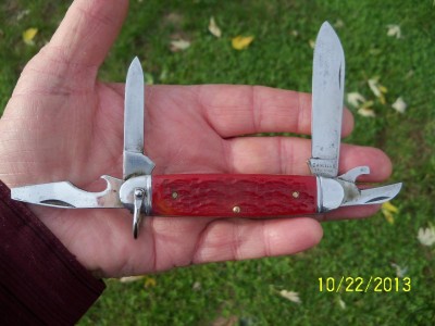

Since my knife attraction is to the older, pre-WWII to just post WWII, most of the knives I get in are in need of a little TLC. Nothing agressive, a soft cloth and some Semichrome polish or Brasso. I remove all active rust, both red and black with a No. 2 lead pencil (thanks for that tip Jerryd) and polish with the SC. I polish the blades, the bolsters and caps, the handles and the backsprings. If the bone handles appear excessively dry, I'll give them a little drink of lemon oil followed by Semichrome. If bolsters and caps are steel/iron and really bad, I will use a piece of Scotch-Brite and a little Semichrome. I have bought some knives, primarily CAMILLUS, with the "shrinky-dink" handles and have them rehandled to make them attractive to me. If no one else likes them that's fine by me, cause I'm a hoarder. All-in-all, every old barn needs a little paint now and then. I think these two turned out pretty good, thank you Bob.
Before After Before After
