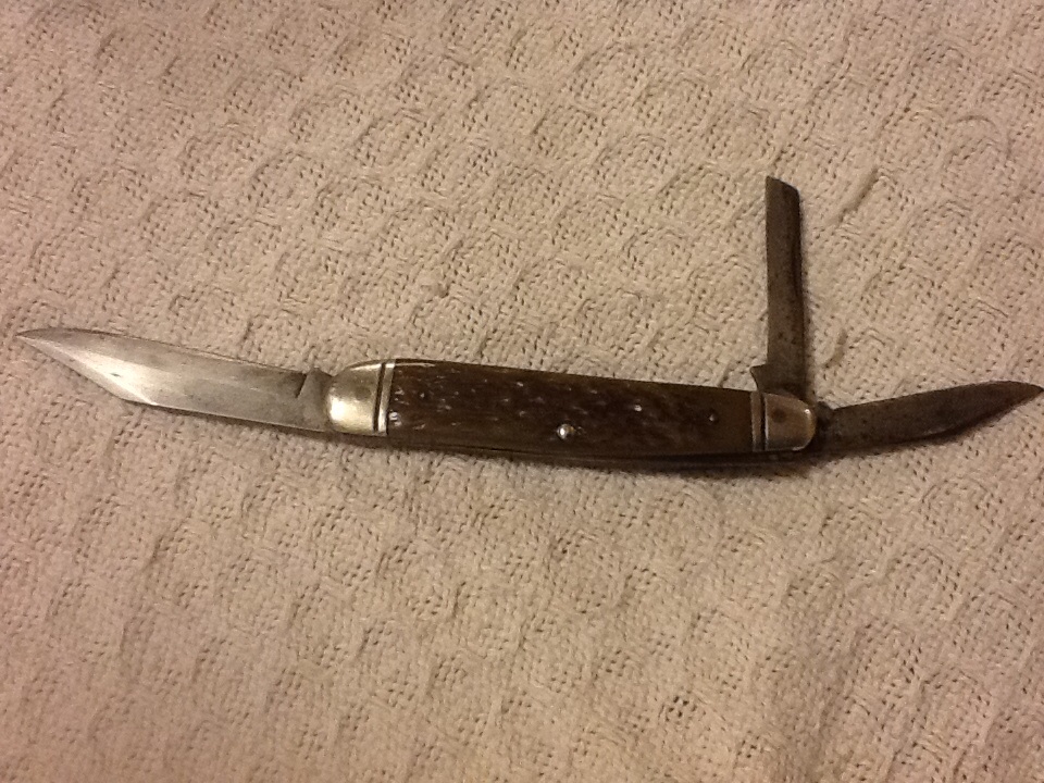

Gentlemen, I'm still learning about these old Western knives. I love them, and man what steel, but the more I fool with them the more I'm convinced I'll never become an expert, lol. Here I have two two old whittlers. One that I know is the real deal is marked 461, so that's what I'll call them.
The first one comes to me from Coffeecup, the real expert. It has well worn blades and a big ol hunk missing out of the handle on one side that's been filled with paint. But man does it get sharp, it's tight, snappy, and a real nice edc. As you can see it has a shield, it's marked Western Boulder Colo made in USA.

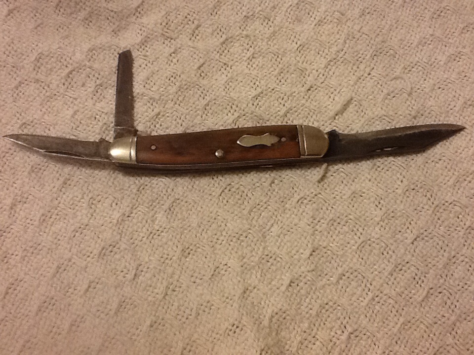

The second one has no shield, is marked Western Boulder Colo, and has no pattern number. Now Coffeecup has informed me on another knife that not having a pattern number marked is not an uncommon thing with older westerns, so that doesn't concern me so much. Here are my questions.

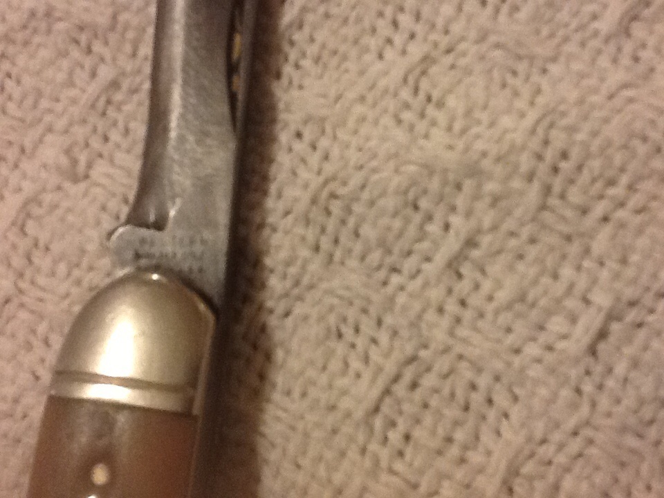

1) Are both knives from the same time period? I ask because of the different tang stamps. If not which would you say is older?
2) The pins on the second knife are definitely of a different material than the bolsters. Does this mean the knife has been apart? Could it be factory?
3) I thought the lack of a shield was suspicious on the second knife. But the few pics of this model I've found on line show no shield. Does any know when the stopped putting shields on this pattern?

Here's the second knife.

The second one has been repined but may still be correct. I have a beautiful 461 like your's that isn't pattern stamped with the Western States "arched" stamping(pre 1950) along with a few latter ones I would have to do some digging to locate. Around 1953 Western's pattern number for your 1st knife was 6346 and came in bone and composition (No.2346). About that same time they made a B364 black composition with a shield, and a 6346(same number but different frame and blades) also a whittler, 1/2 inch smaller, pen blade instead of the coping blade. That same time they made a B346 black composition same frame and blades as your 1st knife. To complicate things even more, latter on they made a 6504 that they actually stamped 'whittler' on the back of the master blade, but this one is on a stockman frame, not a actual whittler pattern, but came with a heavier spring than the 657 stockman. They used that 657 frame back in the boulder days with bone scales (latter were delrin) and a Calif. clip master blade and a yellow composition scales one with a regular master blade, both unmarked. Sorry if I'm confusing the issue with too much info. Western kind of did there own thing. They were famous for giving their employees alot of freedom on their fixed blade knives to use wharever spacers they were in the mood for. I ve collecting Western for 20 years and still find variations on the same pattern number. Do the blades seem to fit the frame on knife No.2 It doesn't look right to me. good luck. Dave

Thank you Dave. That's exactly what I was looking for. It seems there are few absolutes with western.
The fit issue is probably due to my photo skills. In hand the blades on the one are more worn, but they fit identically in the frame.
I agree it looks to have been repinned for whatever reason. Blade fit, type, etc is spot on from what I can tell.
Now, as to the frame, I did notice one thing. The bolster on the knife with the shield is a tad larger. The shape is the same though.

From the comments here, having the knife in hand, and looking at the few examples I can find online, I believe its genuine. I believe it's been repinned for whatever reason, but the frame, blade fit, etc...lead me to think its genuine.
It's good enough, and I paid little enough that replaced pins won't make a difference as an edc. I'll pack it and whittle with it, I'll let my sins worry about replaced pins after I'm gone.
