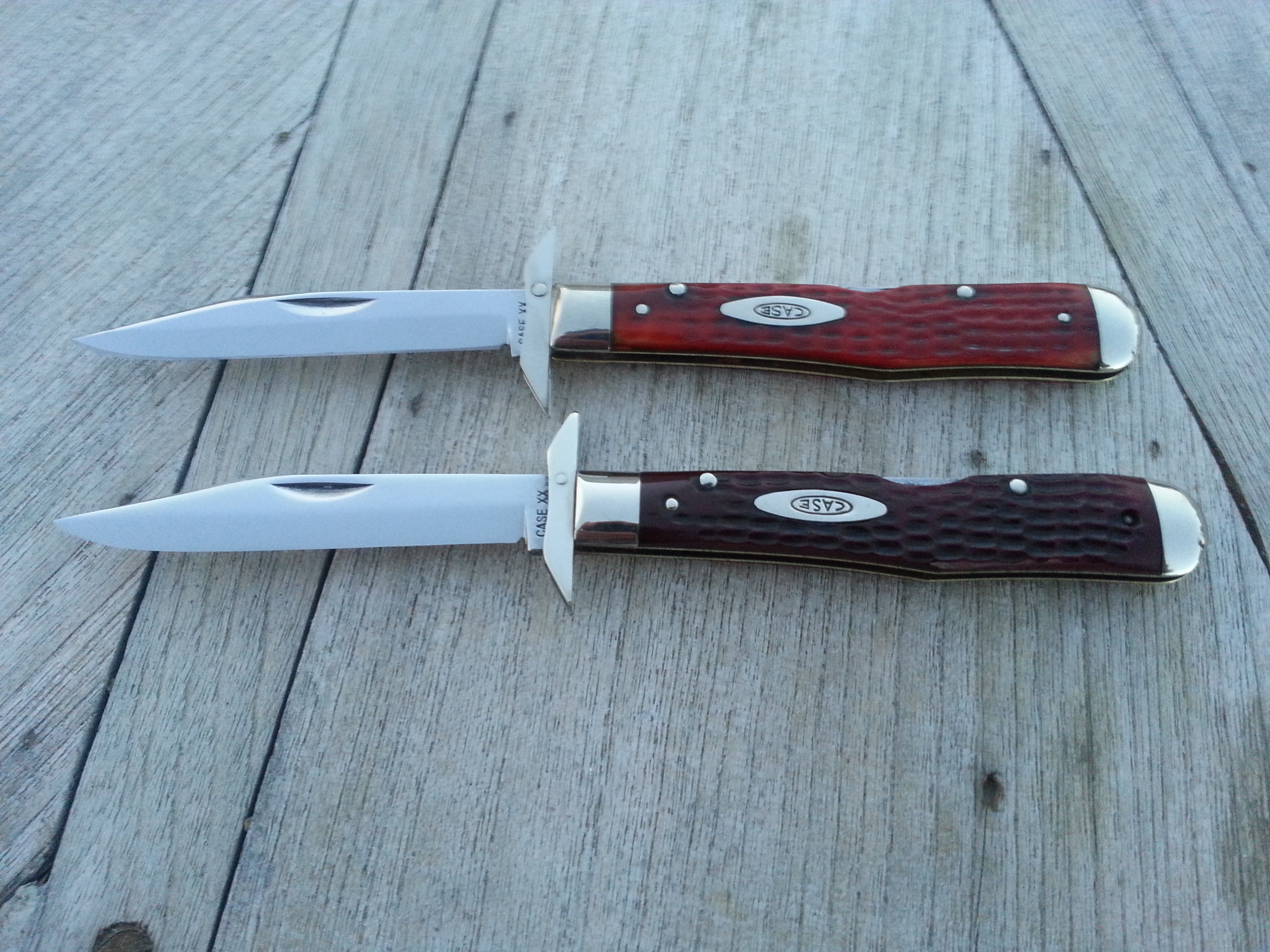

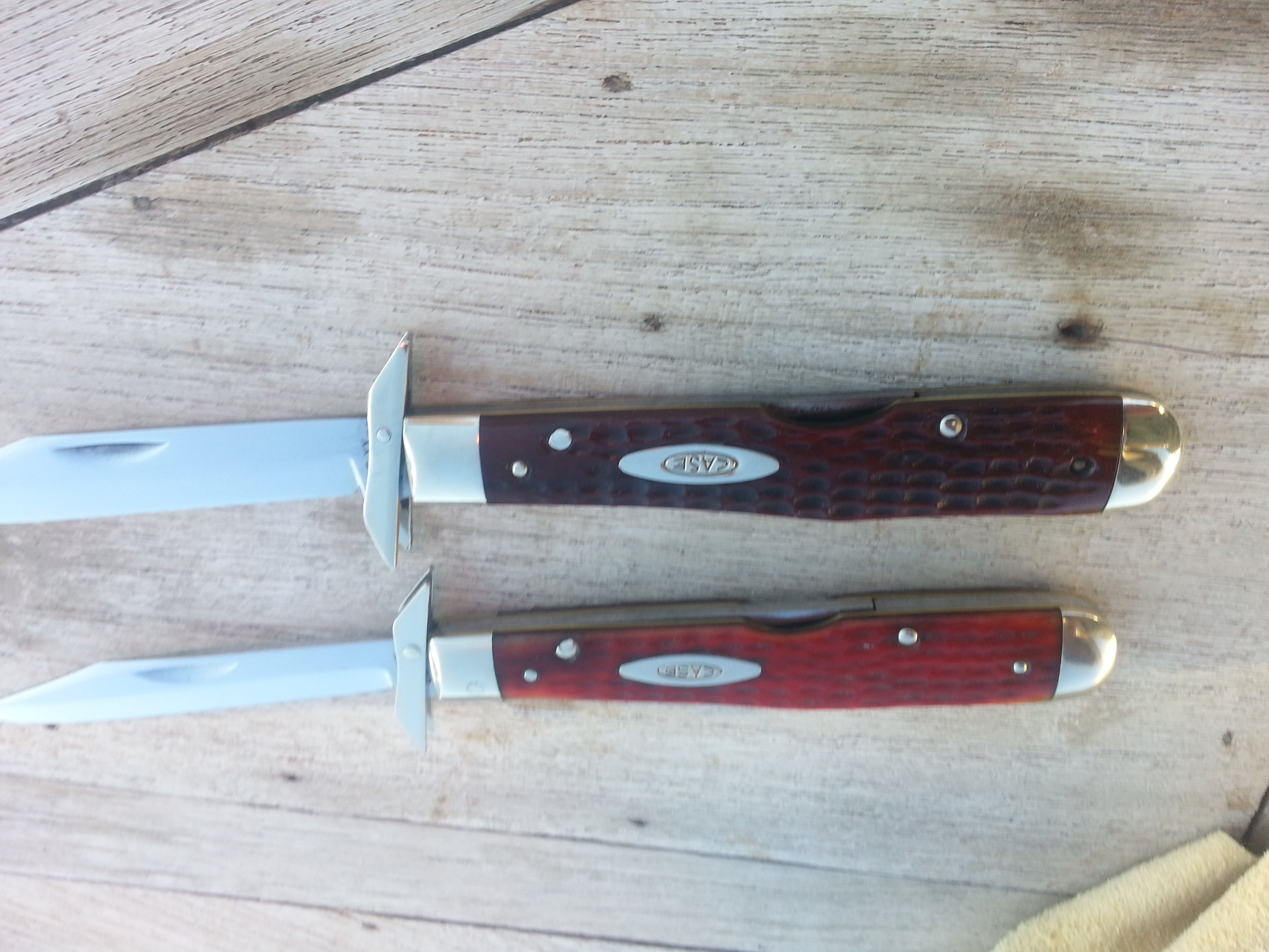

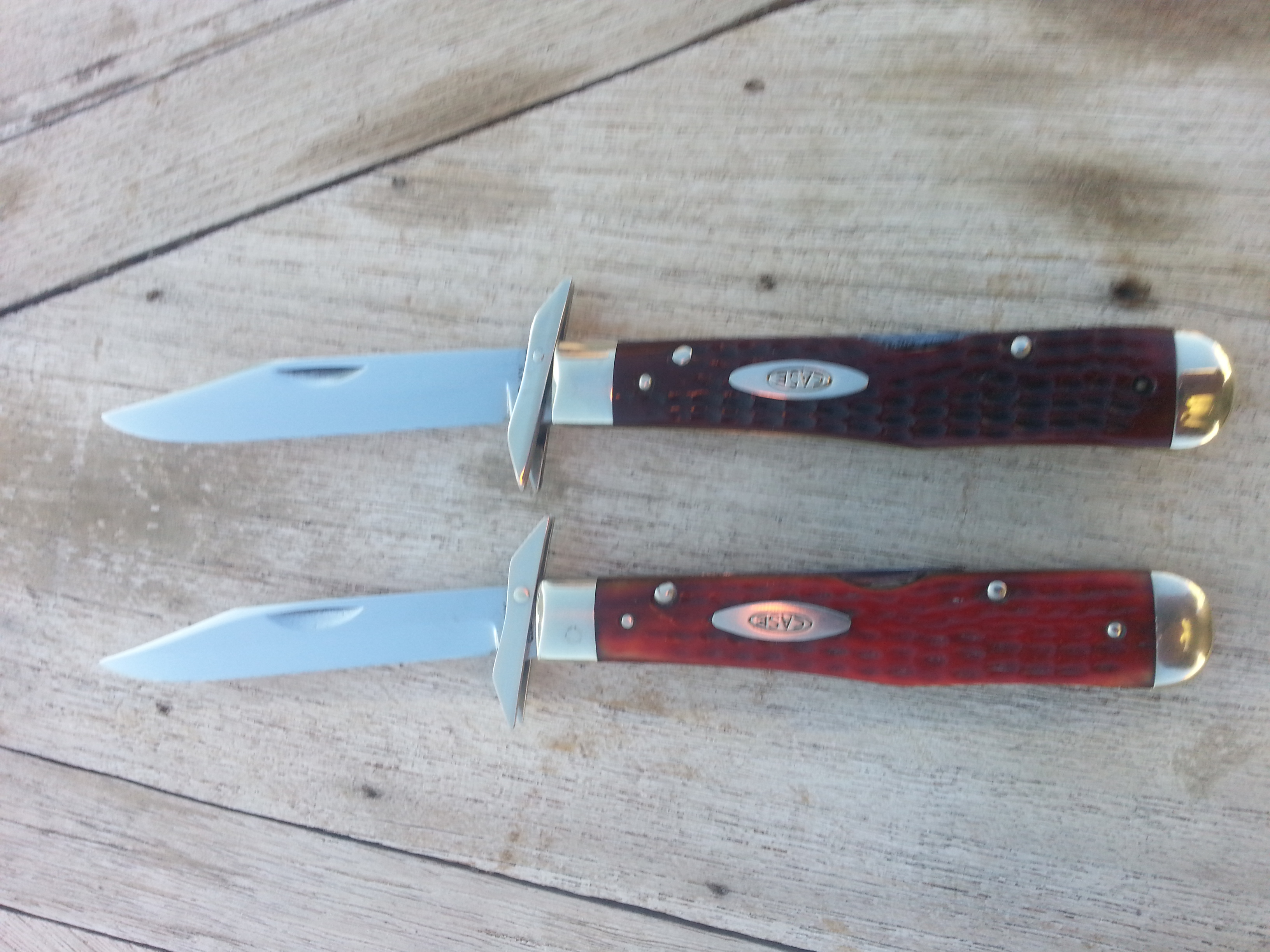

I have 2 CASE 6111-1/2L knives with loose swing guards. Oddly, both are USA era. I have about 25 or so other knives of the same pattern with no issue. Needless to say, it is irritating (to me at least).
Both blades lock but the lock does not go flush with the backspring when opened. So there is some up and down play. If you push the blade up, the lock goes flush with the backspring. At that point there is still major slop/ up and down movement to the swing guard, as seen in the pics below. Both knives also have some side to side blade play. You may also be able to see the locks not flush in the pics.
Anyone seen this before and know the cause? What would it take to fix it? Anyone fixed this before even if on another makers swing guard?
The strawberry red knife in the pic is a rare USA factory error with no model stamp. Would love to get her fixed assuming that beautiful red bone stays intact during the process.
Sorry about the pics but I think you can see what I am talking about from them.
Thanks for the help. Regards, Jerry

it can be fixed, i've done it before

yup usually worn or damaged parts
