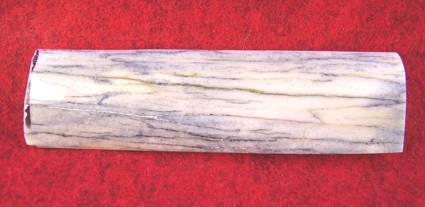

Here's a photo of the burnt deer antler. Notice the black flecking toward the end. Rather interesting, eh?

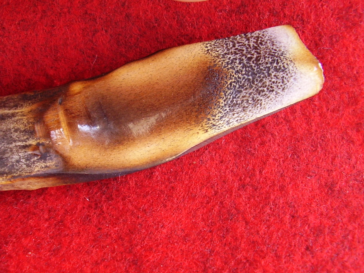

Also, the second photo is of an elk leg bone that was old and had a series of serious cracks in it. With copious amounts of 5-minute epoxy, I was able to fix it and after polishing it, the cracks took on the black of the polishing compound. I'm thinking, if I was to burn it enough, polish it to a slight amber color, then give it a treatment of lacquer-based wood stain, it might take on the looks of some mastadon ivory.

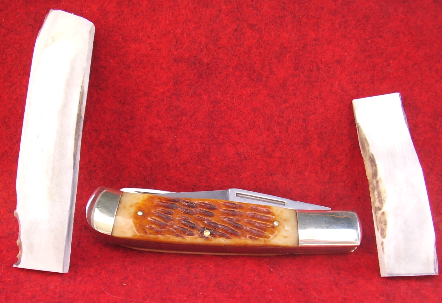

The last photo is of my latest victim, with the deer antler slabs I intend to use as handles, giving them the burnt treatment.
