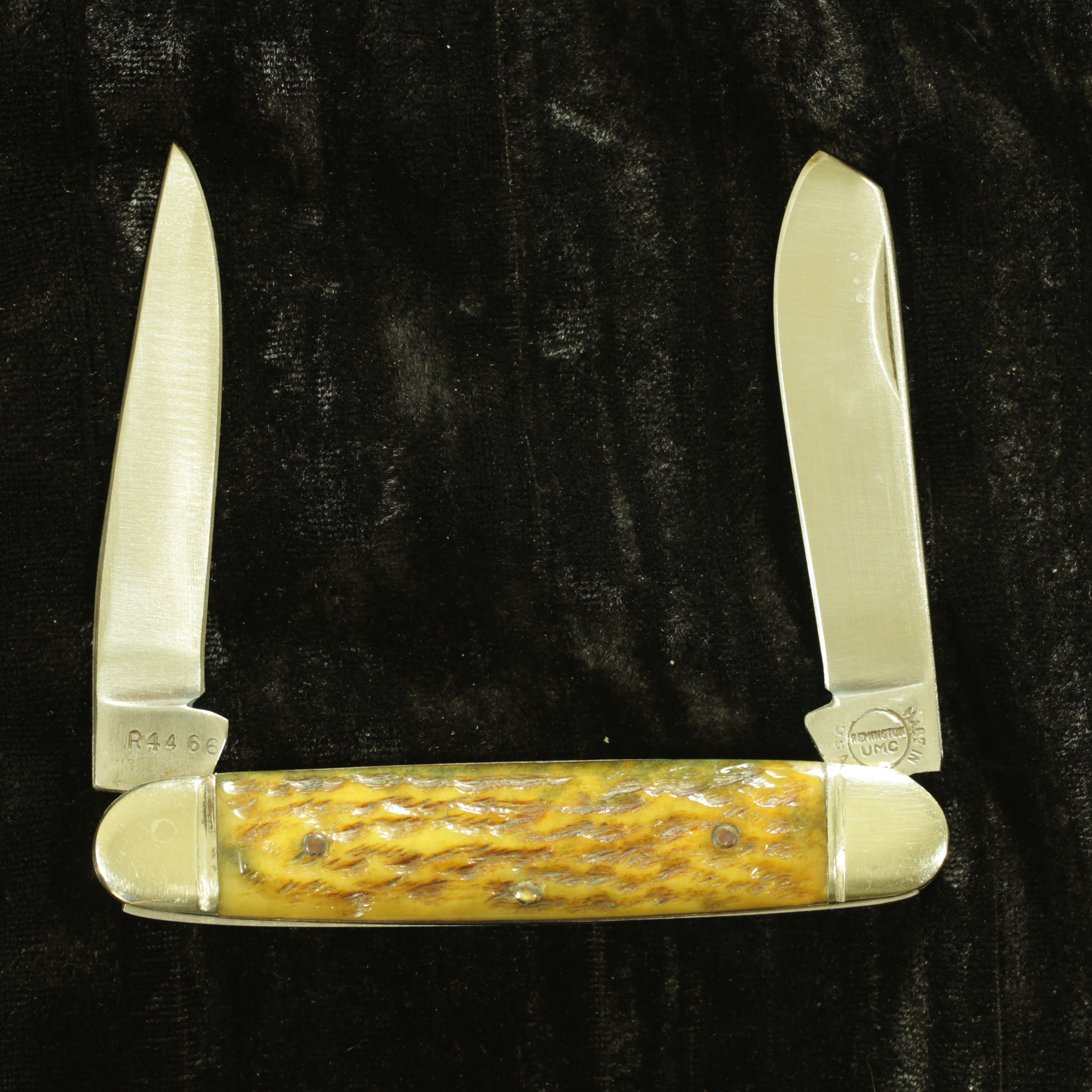

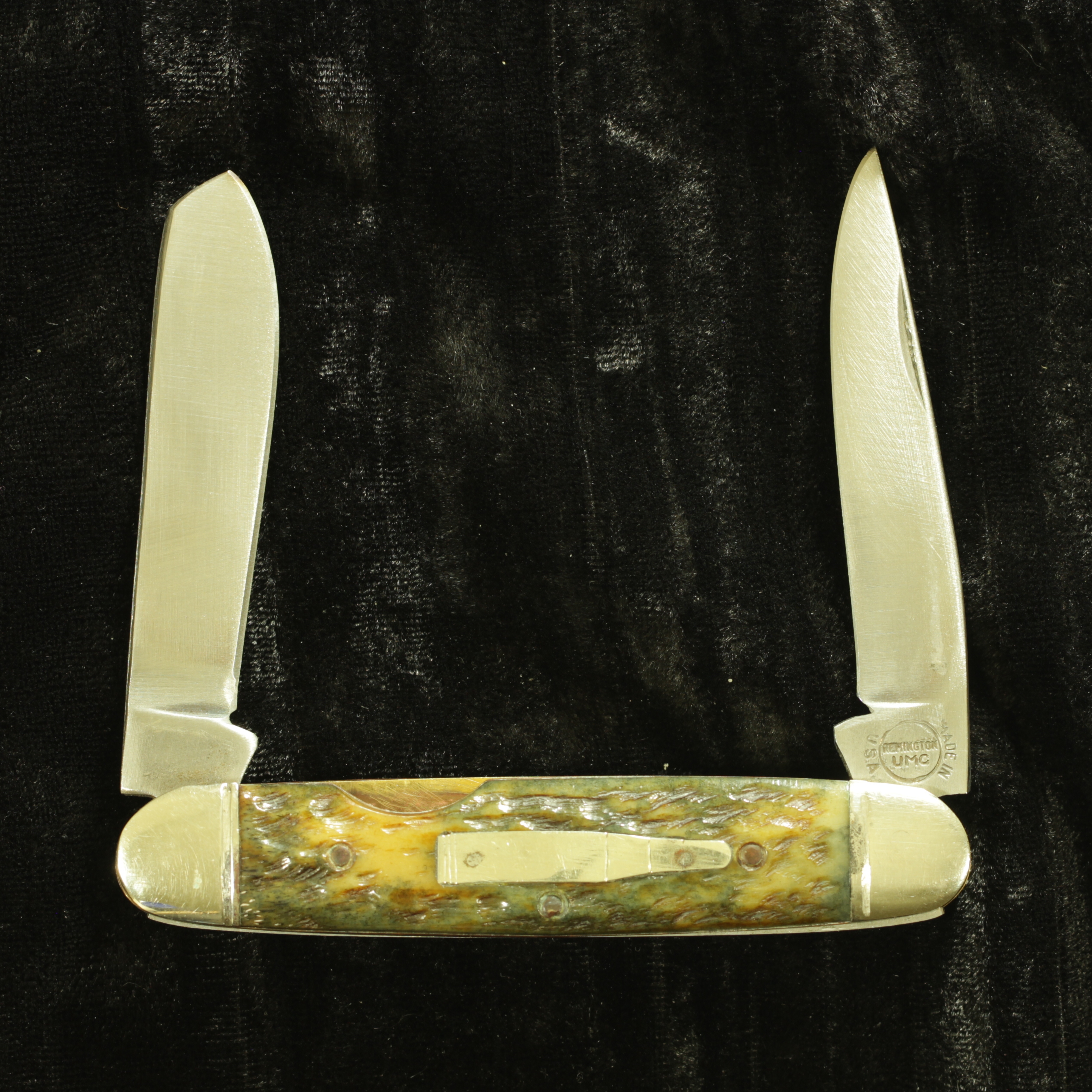

I know this knife is not genuine: measures 3 11/16" closed, not 3 3/4", bullet shield is crude with two shield pins showing,
"Remington UMC Made in USA" tang stamps coarse looking - master blade stamp double struck - pattern number stamp off center and very unevenly spaced, grooves on lined bolsters crude looking, blades unfinished looking - grinding marks still apparent., "stag" handles don't resemble any Remington stag Ive ever seen. While the knife looks unused and never sharpened, there is no blade etch. There are more subtle signs though the preceding may be sufficient to substantiate the fakery in this knife.
Anyone knowledgeable who can confirm this would be appreciated. My mother was burned on eBay before she passed trying to by me a birthday present - I guess she didnt find out til after she bought it that it was a phoney. I found it in her home - she never mentioned it and I want to confront the seller since the statute of limitations for fraud perpetuated against the elderly is 4 years - the seller listed it as original vintage and she paid over $700 for it. Thanks.
-Bill
-Bill

I am 100% positive the knife shown is neither authentic nor genuine. I'm not sure who is responsible for the manufacture of said knife but I've seen them on Ebay occasionally. I'd venture a guess of maybe once or twice a year. A copy of the auction for that knife would be the next step , to see if it was represented as a genuine Remington Bullet. Most of the time if the seller knows its a fake, they will word the auction so that they can't be held liable for the knife.

Thanks, all. I already have copies of the original listing and the PayPal transaction and the listing as it is displayed in my mother's eBay purchase history and I already know how to go about prosecuting the seller. The transaction was on 3/28/2012 and while eBay is off the hook, the seller is not and eBay will gladly throw him under the bus when he is investigated by law enforcement for fraud, hence the disclaimer in every listing, "Seller assumes all responsibility for this listing."remington collector wrote:I am 100% positive the knife shown is neither authentic nor genuine. I'm not sure who is responsible for the manufacture of said knife but I've seen them on Ebay occasionally. ...
I'm here at the knife forum for knife advice, not legal advice...to have the fakery of the knife validated by another collector or collectors with credentials, if possible.
At remington collector: If you have any such credentials please include them with your opininon on this knife. Thanks!
Thanks, again, to all and for your kind words! - Bill
