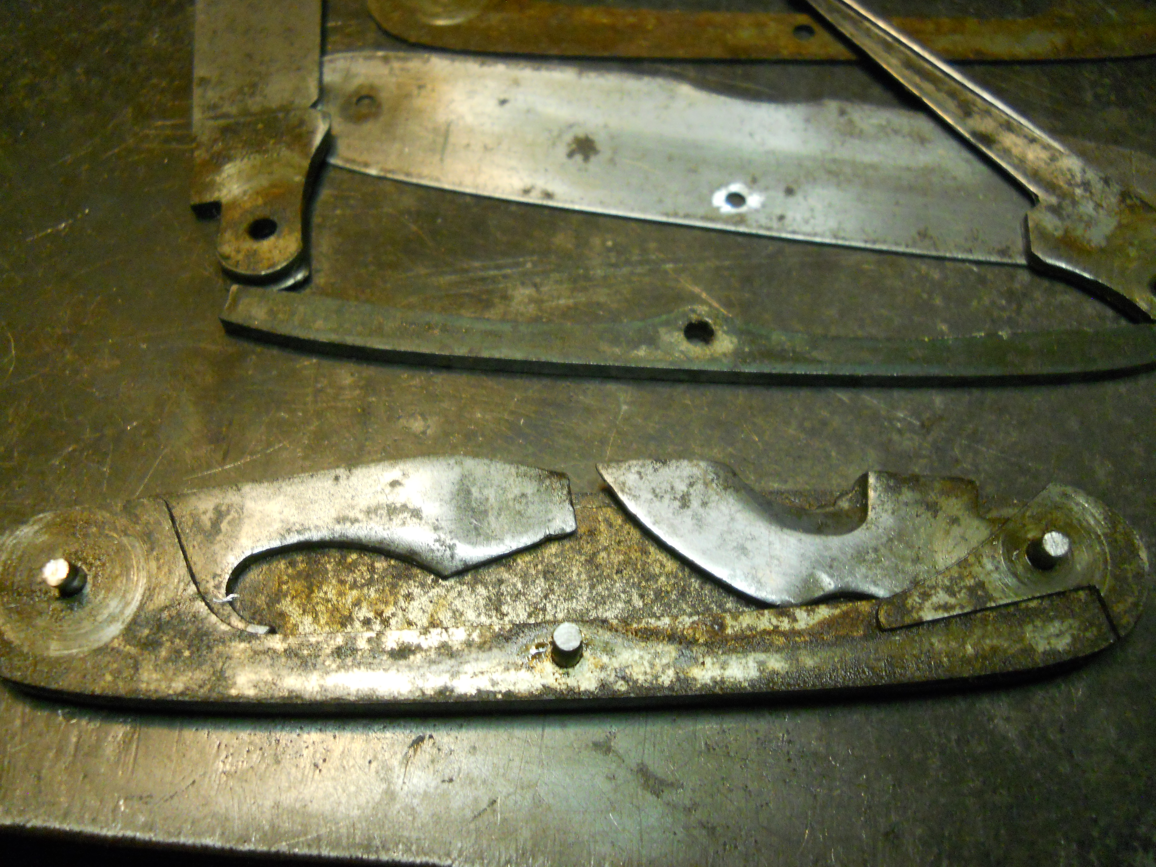

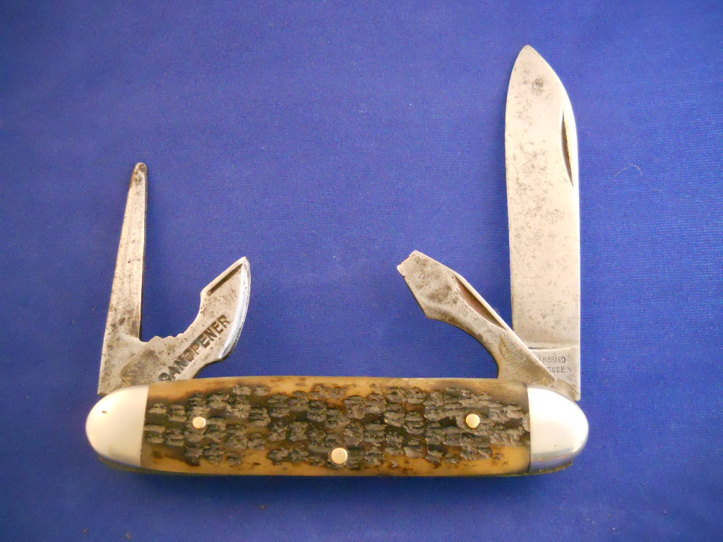

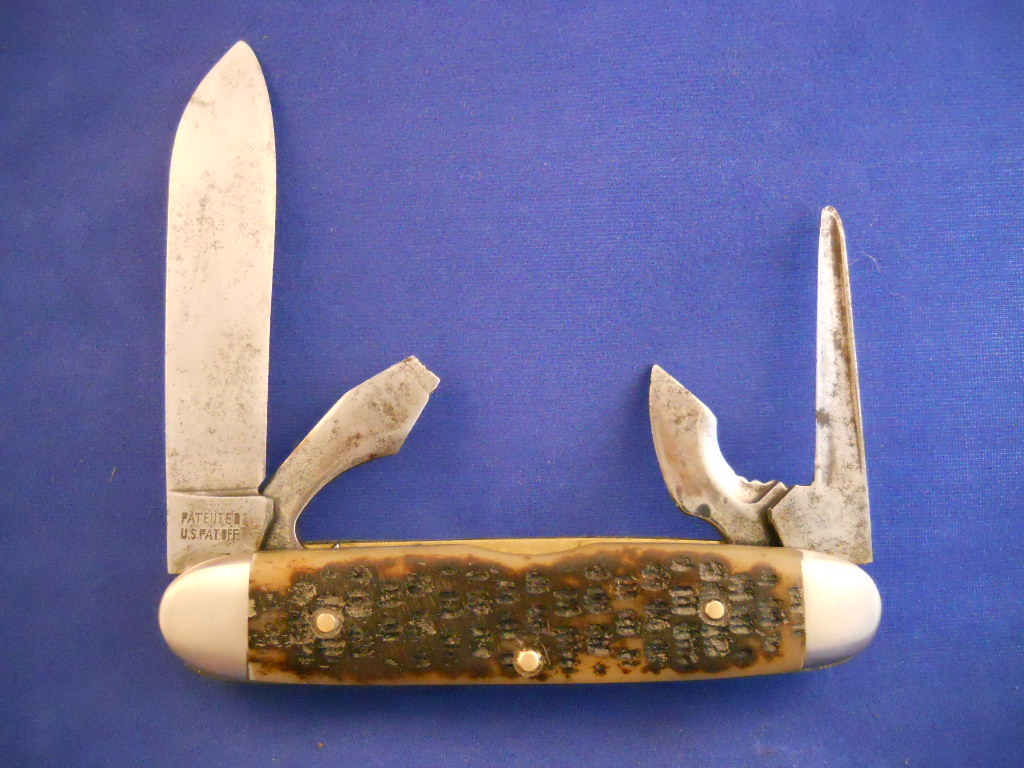

This old A. Kastor "Clover Brand" was a shell handled knife that Scott sent me last year.
The shells were shot - and how do you find new ones for this???
The knife was made pre-war (1941, as Goins` has it) at the Imperial factory. ::nod::
I made the liners out of .032 brass stock (old ones were steel and had the little embosment
to accept the tab for the shell) and added the NS bolsters. Then I covered it with Culpepper's
"Black Cherry Amberdeen" from their discount bargain bin.
This is the first Camp/Utility I have ever done - it's got some interesting spacers to off-set the
blades for clearance...
...... Joe

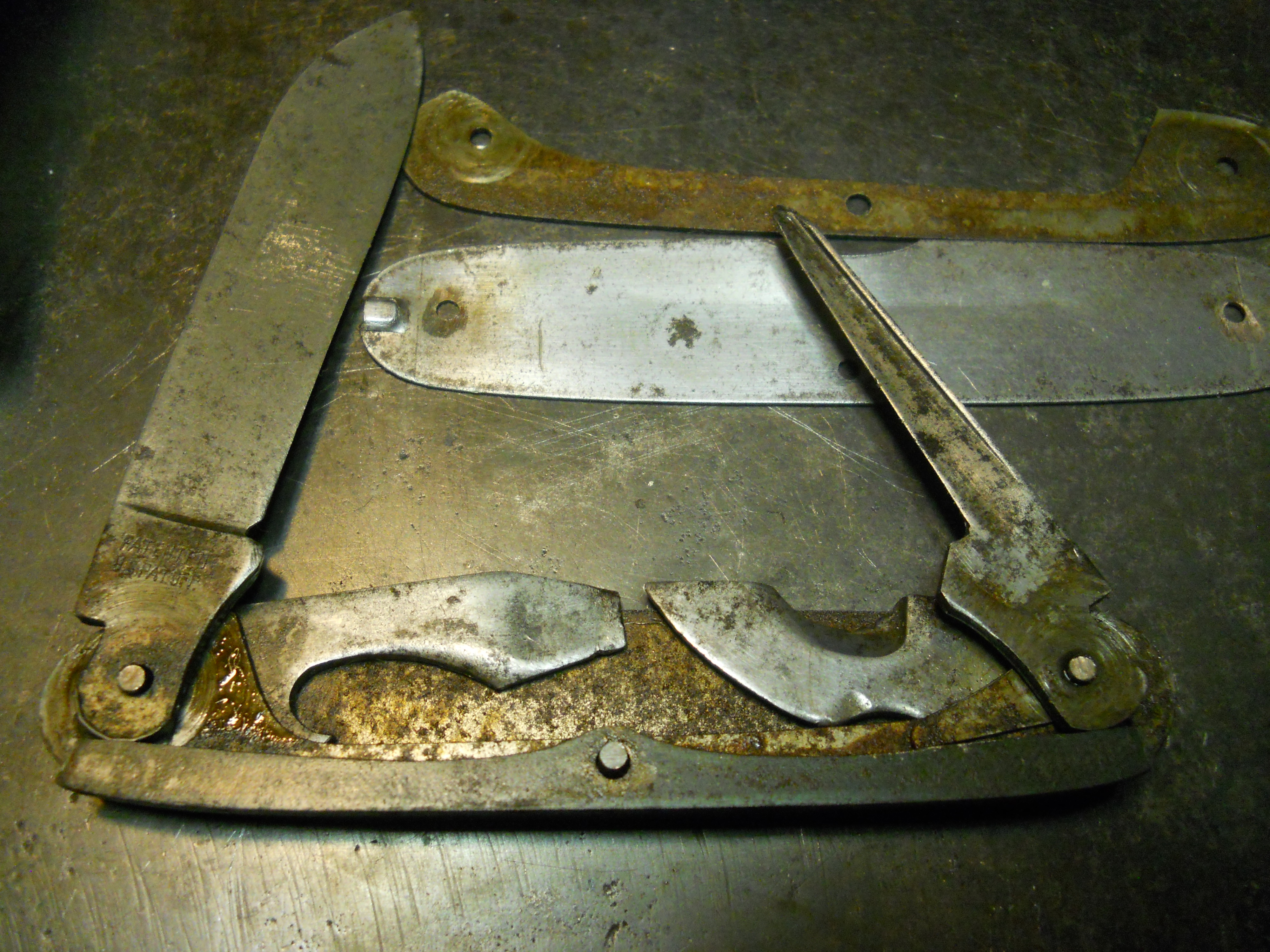

Thanks guys! And you're so right, Dale. Fortunately I took some pics as I disassembled it
so I could put It back together! :lol: You guys see the lil spacer in this pic?
I intentionally didn't buff the knife cuz it had that old time look after just sanding it. ::nod::
It IS marked as a re-handle.
.... Joe

Joe Dirt wrote:Thanks guys! And you're so right, Dale. Fortunately I took some pics as I disassembled it
.... Joe
Very Smart Joe, I didn't think of that the first time ::facepalm::
Now I take pics if they are more complicated like a camper and I usually trace the knife out on graph paper and annotate it with the pin sizes and any other noteworthy info.
In doing that I have discovered that the pin sizes have changed on some knives through the years of production.
