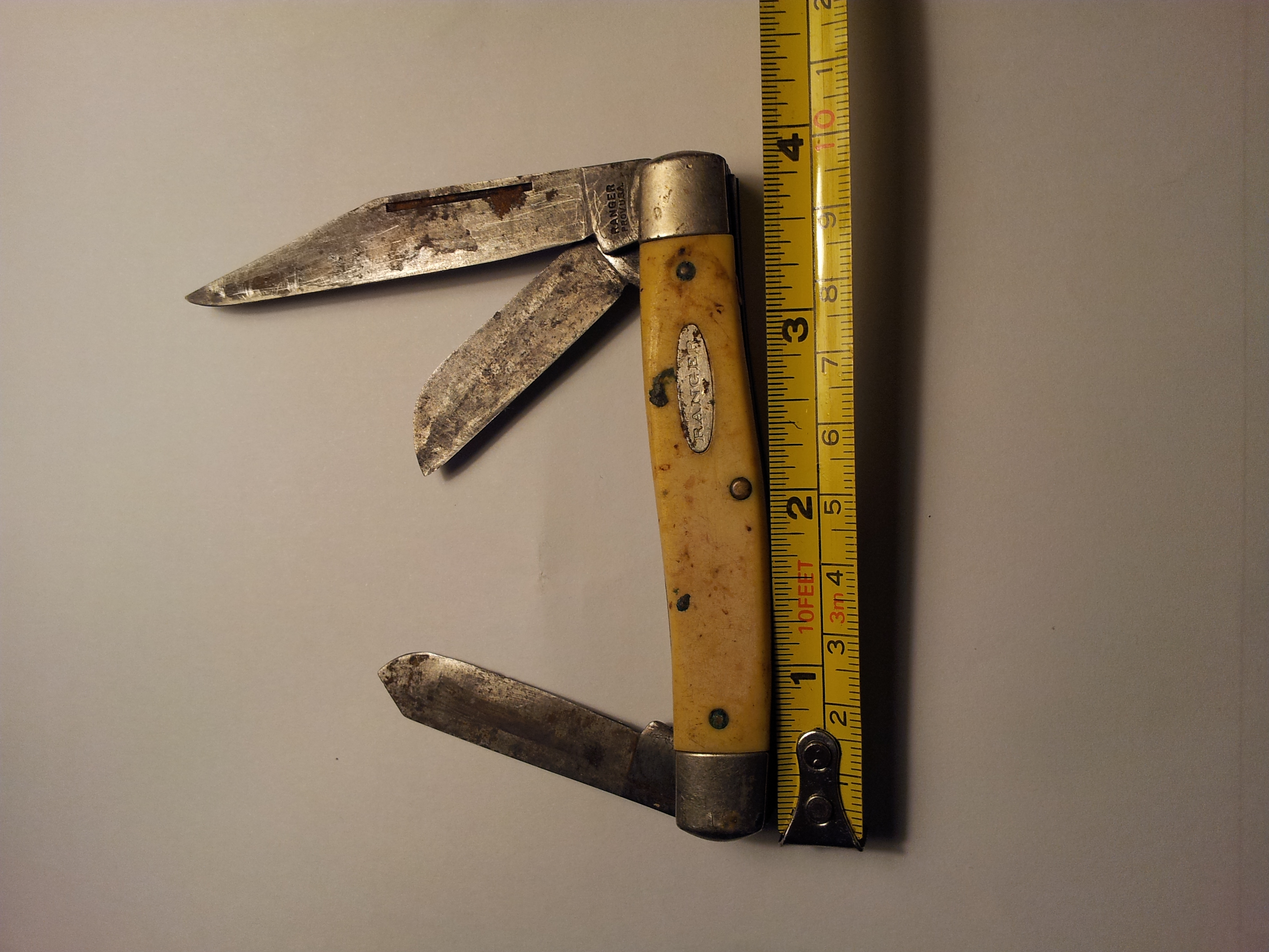

My friend came across several knives a few weeks back, among them were two 3 blade knives that were identical except for the amount of wear. Both have a patent number, 3,317,996. This led to a search that indicated this is or was a patent owned by Antonio Paolantonio Johnston R.I. Colonial Knife Co. July 6, 1965. My question is how similar to the Swendin system is this patent? These knives could pass for a Shrade Old Timer 80T if it were not for the 3 back springs. Was there any connection between Colonial Ranger and Shrade Old Timer? These seem to be rather sturdy knives that would be ideal EDCs. Treefarmer

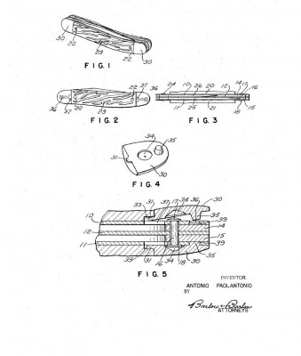

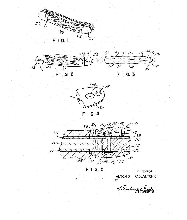

Patent link and Images:
http://www.google.com/patents?id=a3tuAA ... &q&f=false
....... Joe

Good question! ::tu::
This is new to me, I had not seen that before.
Hopefully Bobby will fill us in on the patent and how well this worked.
There are definitely similarities to the Swinden system but I would need to find an example of the knife made this way and disassemble it.
In the Swinden system the handle, outer liner & bolster are all one assembly. The blades, center liner and the master blade spring are another assembly. The spring for the secondary blades is unattached until assembly takes place.
It appears in the Colonial system the knife has assembled and then the bolster are added on last. The downside to this system as I understand it, is that it could be even more difficult to tighten loose blades than it is with the Swinden system. I'm not sure, but that is the way it appears.
Can be bolsters be taken off, blades replaced, the knife reassembled and then the bolsters reattached in the Colonial system.
Perhaps Bobby can fill us in on the details of how it works.

Looking around in the goodies box, I found another Colonial 3 blade knife with the same patent number on the pen blade as on my friends Ranger knives, 3,317,996. This old knife is 3 3/8" closed, has half stops and 3 springs. The bolsters have no pins showing just like the Shrades. This knife would also be a great EDC. Treefarmer

Greetings treefarmer...Hey Joe and Dale, I think I'm going to start a seperate forum about me and Colonial because many folks here at AAPK still don't know who I am!
Treefarmer, my name is Bobert A. Paolantonio, third generation Colonial owner and cutler.
Rather than spend lots of time explaining who I am, I would definately suggest you visit my blog at :[email protected]. There you'll see a treasure trove of Colonial's history and lear about the book I have for sale and have recently released to the public about my family business, Colonial knife Company!
Back to the Rangers...boy these baby's have seen some action but it appears they are still in one piece! The medium thre blade is our # 523, three blade stockman. The large stockman is our # 533. These were very popular and through the years, we sold MILLIONS of them. FYI, Colonial was the second largest manufacturer of pocket knives in the world,
that consisted of a factory over 200,000 square feet that I spent the better part of 40 years working in. The patent # that you'll find on many of these knives pertains to the bolster patent that uncle Tony registered back in the 60's. The design at that time was to use a tubular rivet on each end of the liners and assemble the knife completely, less the center pin of course. The liner's had a recessed hole on each end, (as Joe's picture shows quite closely), and the bolster's had a pin or pimple like stud on the back of the bolster.
After the tub. rivet assembly was completed, we would open the blades, pop on the four bolster's, and place the knife in a press that came down and squashed the bolster pin into the liner, and this fantastic design worked like a charm so that's why we pulled a patent on it!! You'll see that long patent # on many of our knives from the late 60's and up because they are made in this fashion! ::tu:: The Ranger's came in numerous color's like black, yellow, off white and even some blue and red on some private labels...
That second old worn knife was our old # 4633, and was part of the TP-333 display card that Joe shows..

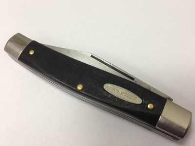

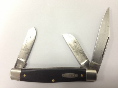

I just listed this small Ranger stockman on ebay..
Great little knife..

Cute little # 923 you've got there Scott! This as you know was our medium Ranger. I may have not mentioned it before but because the Delrin plastic handles on these and others like it was so hard, we needed special ink to do the surface imprints.
At one time, my dad's division of Colonial known as Embassador or Embassy Manufacturing brought in a MILLION DOLLAR'S a year!! Ad specialty was a huge profit maker for Colonial!!
This little baby ought to bring you at least 10-15 bucks on ebay buddy! Good luck!! ::woot::
