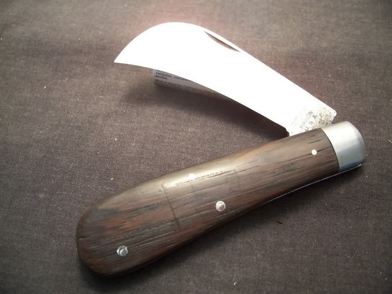

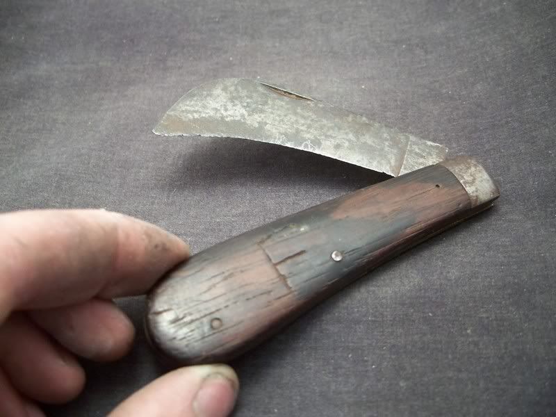

I take it apart, clean out all the rust, regrind the blade, true the edge and remove all the rust and pits. Tinker with the tang and spring a little and it now has walk and talk. Then I put it back together, fill inthe "F" in the handle, sand everything down and remove all the dings and bad scratches after I re pin the scales. The old pins were very loose and badly sunken, so I just replaced the with flush fitting brass just like the originals. Flush steel rocker and butt pins. A little polishing and there you have it one good ol' USA made hawkbill ready for any pocket.
The blade was given a fine stain brushed finish, not sure why it glared so much? Looks better in person though.
