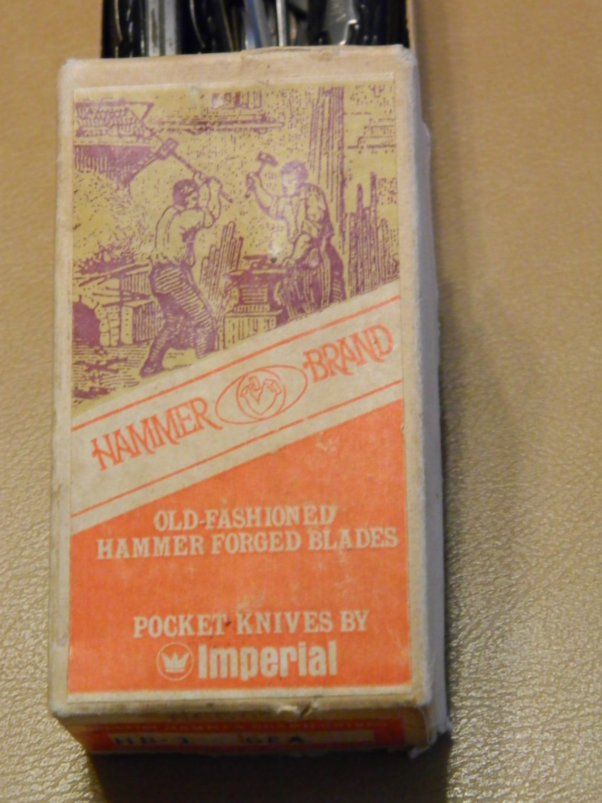

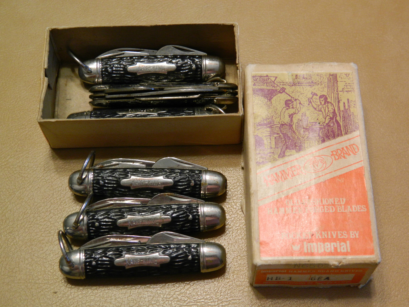

I thought that the ad copy on this box of 1970's era Imperial KAMP KING knives was funny.
Hammer Forged Blades? Right....
I can guarantee you that - Number One...no inexpensive shell handled knife made in the US was ever made with hammer forged blades.
Number Two...no pocket knife made in the US after WWII was made with hammer forged blades.
While hammer forging was the norm in the cutlery industry for many years (due to the lack of machinery in steel mills for precision rolling of steel)...as technology developed by the 1930's even the high quality firms like Case had gone to stamping of blades out of rolled flat sheet steel. Certainly the makers of inexpensive shell handled knives like Imperial never hammer forged the blades of these inexpensive knives, even when they were introduced in the late 30's.
By the end of WWII hammer forging was phased out completely (at least in the USA) for factory made pocket knife blades. It remained in use (and remains in use today) for some kitchen cutlery like the Lamson Sharp forged kitchen cutlery.
